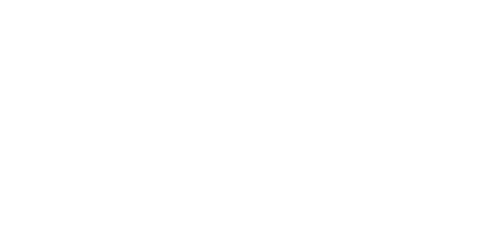

When I navigate to the IP address in my browser, the web page that is displayed is just a blank, white web page. The camera has been working fine over the past few months, but suddenly stopped working and just displays a white page. The RTSP stream is still streaming video, but the web UI on the camera isn't working so I can no longer configure the camera. The camera is mounted up high, so I'd like to see if there's another way to fix this than having to remove the camera to do a reset.Revo2Maxx wrote: ↑Sun Dec 27, 2020 5:52 pm Hello and Welcome to the Forum
Sadly not sure I understand what is going on. Can you take a Snap shot of the screens and upload them..
Other then that The next guess would be that you might have made some changes in the camera and they need to be Reset because of the changes that were made if you don't know how to change back out of the issue spot..
ON the 841 the LED is also a BUTTON just press and hold it while you have power to the camera, Once the camera starts to Reset this can take 30 to 45secs on some cameras I can't remember to be honest how long it takes for the 841 it has been some time and a Few other cameras between since I last Reset one.. You will know because it will have the LED go out and the camera will start to move in it start up check mode.. Once you are done and if you have setup the camera and the feed is back I would Reset the 2496.. I am not sure about that camera,, But there is going to be a Button or an area on the MB to make it reset.. If no button is present you will have to short out a couple of pins that will have Reset next to them so you know they are the right ones.. If not I could try and look it up in a manual or see if there is a Video on Amcrest youtube Channel
Below is what the screenshot of the web page looks like when I navigate to the IP address in my browser:
- Screenshot_2020-12-28 Screenshot.png (8.65 KiB) Viewed 25679 times
