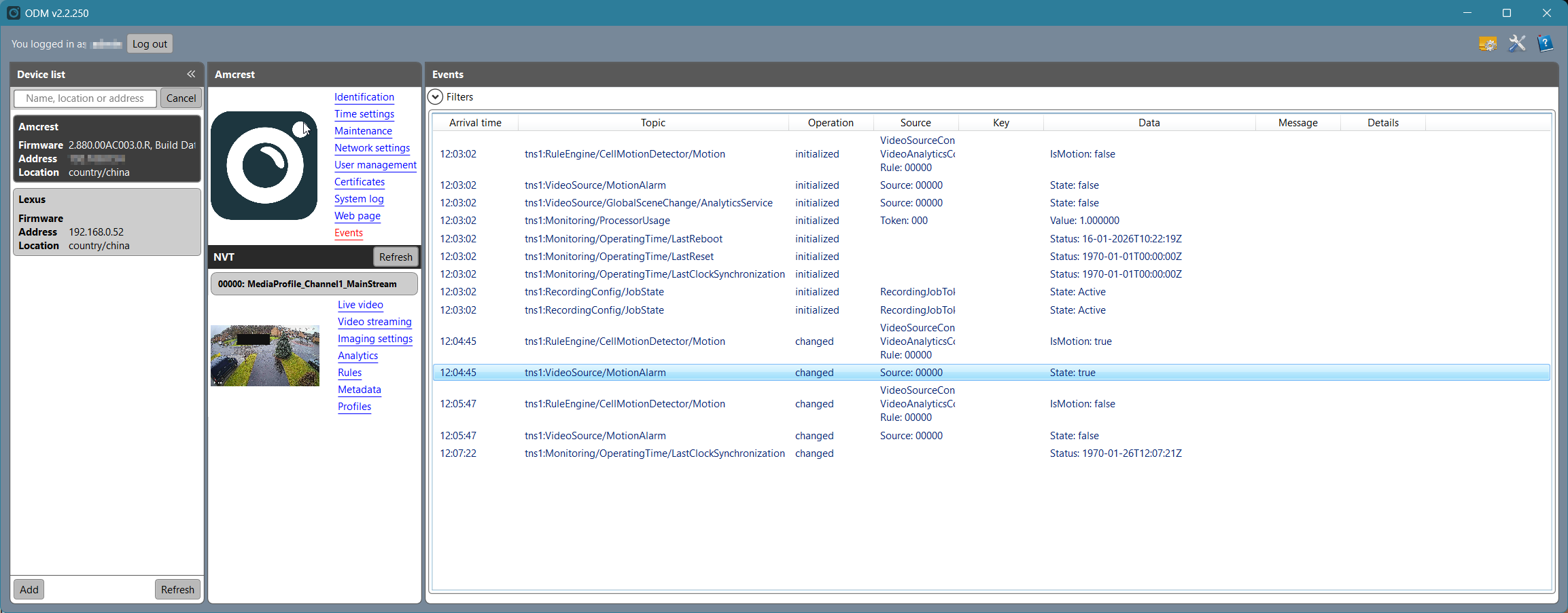

ODM does show its generating events, so maybe its on the QNAP side?
2026-01-22 12_08_23-ODM v2.2.250.png (130.53 KiB) Viewed 2077 times
