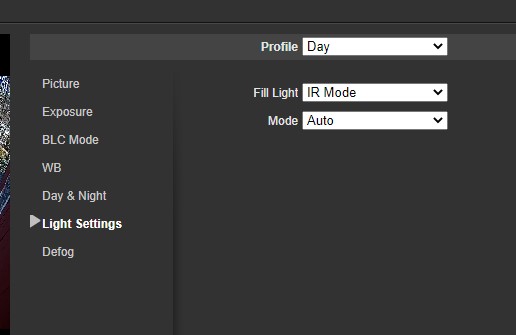

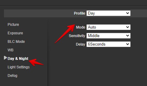

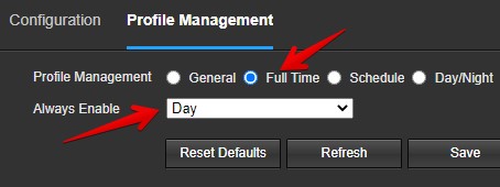

Here are some screenshots of how it's currently set....

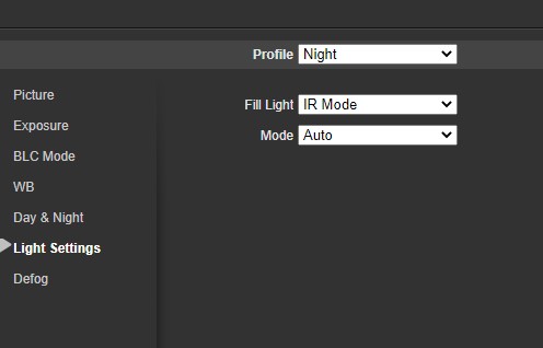

Camera Settings - Barn [Front] - DW Spectrum Clien3.jpg (15.25 KiB) Viewed 2892 times

Under Day & Night -> Night -> Also set to Auto, Middle, and 6 Seconds....

I was saying that I had tried that and no workie.... so I reset everything and am at default now with these settings.
Do under Light Settings -> Go to Night -> then smart illumination?

Also because you have it setup for Full time Day. There is no need to mess with Night time settings unless there is an issue where the system is picking that by design. Meaning you are using an NVR or other Recorder that messes with Image info that is apart from the normal built in settings of the camera.

OK, so under Day, set it to Smart Illumination and leave Night alone, right, that's what I thought.
