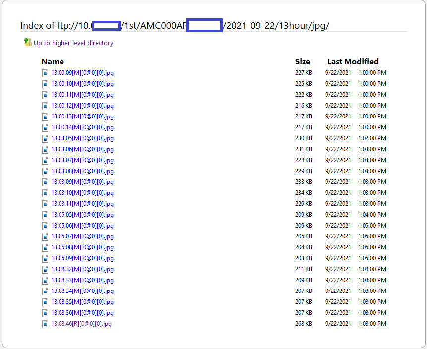

So it is hard to say how or why something isn't working right.. In FTP it isn't really just a Single type of file for the camera. As stated before there is name with time and such Also depending on the system if you put a name for folder then that will be (Normally) at the Folder you make for your FTP, Then the Name you made, then IP of the camera or n my case NVR then Date, then in mine for my Recorders this is where Channel, and times in the channel is Videos with time stamp for Jpg you would have to click on the Hour you want to look at..
For my Cameras sorry I found I still have a few going to my server most of them are from my Recorders but looked on a different FTP server and I still have a couple of Cameras in there.. For that I have Name setup in the cameras, So in the Root of the FTP server is that name, Then in that is the SN of the Camera as the next level, then date, then hour, then in the hour if you have Video and Jpg both will be listed as jpg or mp4...
Then for this camera you can setup your FULL time Recording in the Schedule for the Snapshots, Then on the page of the Camera under the snapshot you would want to change the 1s as it is normally set to a time that works for you and on mine I can change it from the 1 to 7s to as much as every 50,000 seconds. Once you get that you will have your 300 seconds in there
So I have mine setup for Motion but this is what it looks like for the images and there is no where to change the name to suit your needs only the starting folder in your Root FTP server can be added...

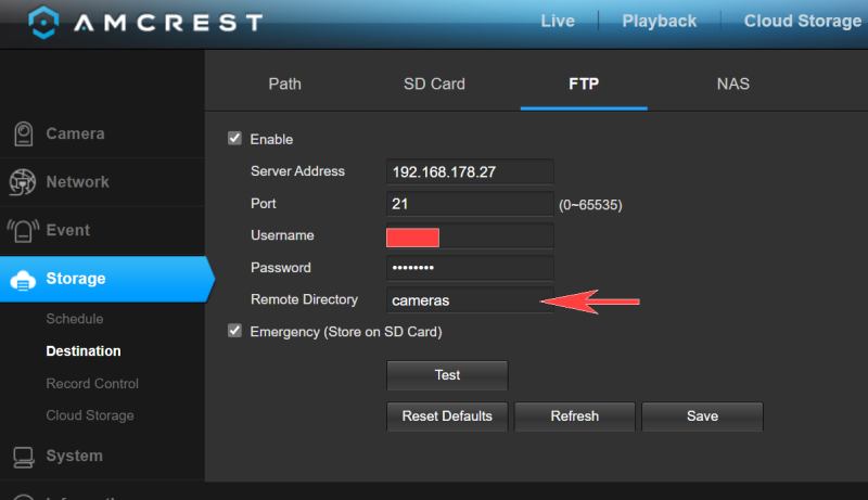

For all my cameras, there is a field "remote directory" in the destination settings for FTP. Do you not see the same?
I save snapshots to the FTP server on my NAS to a share named "cameras". When initially setup and tested each camera creates it's own folder within the cameras folder. The device name specified in camera settings/system/general is used to name that sub-folder. Just bye the bye, you should make sure that the user setup in the camera has got full permissions on the folder. I believe that not doing so is one of the causes of FTP test failures.

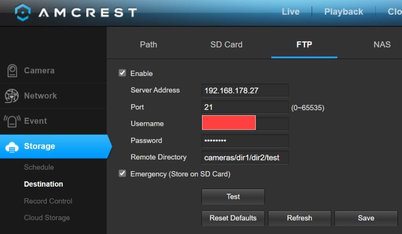

Yes. My problem was I was two levels up and trying to have a path and not just a folder i.e. dir1/dir2/webcamfolder. It can only take a folder name so I created a separate FTP account that is at the dir2 level where a simple folder name will work.

I'm not sure what the problem is there. I just did a test on one of my cameras (device name "Front") and changed the "Remote Directory" entry to read "cameras/dir1/dir2/test". I clicked save and then test and then I went to the folder "cameras" folder on my NAS. There is now a new set of folders in the cameras folder the path is - cameras/dir1/dir2/test/Front. Note that clicking on the test button creates the directory structure.
If that isn't working for you, then I can only imagine that there might be a problem with the user permissions on the FTP server. Just bye the bye, I'm pretty sure that reports that I've seen in the past of "Test failed" error messages can also be caused by insufficient user permissions.
