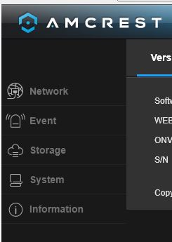

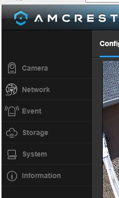

I noticed a very strange issue on my 2 IP5M-1173EW-28MM units. I generally create 2 admin accounts. On these 2 units when I create the second admin account and log into that I do NOT see the CAMERA tab when i the setup screens. Very strange. I am running the latest firmware.

I did what you suggested and it still does not work. the "Camera" tab does NOT appear at all. I check my other Amcrest camera's and they all are ok. It only happens on my two IP5M-1173EW cameras. The latest firmware was in 2018 which I have updated.

Did the Factor Reset and all but same story. Added an extra admin but when you login to that account you do not see the Camera tab on the left hand side menu option. Like I said very weird as it happens to both of the IP5M-1173EW. But this does not happen to any of my other Amcrest camera's. This must be a defect in the IP5M-1173EW software.

I usually leave the original ADMIN account alone exactly for these reasons. I create a new admin account by clicking on add user and choose the ADMIN group as the selection. Its what I do for all my other camera's. The FW was the 2018 version for the IP5M-1173EW model. Keep in mind I did do a Factory reset so I'm not sure it reverts back to the 2017 FW. Either FW does NOT work. I got these camera's about 2 weeks ago. They are mounted and all.
I think it's a problem with the IP5M-1173E models as both of these are displaying the same problem. Everything works good except for access to the CAMERA tab menu when logged into a created admin account.
