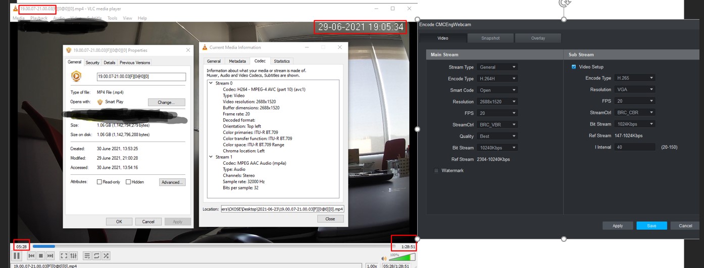

hi to everyone
I am using IP4M cam.
I have the video encoding setting as in the attachment, and I already tried lot of different settings.
I have the record lenght setting as 120 minutes.
when I check the recorded video files (mp4) , the file names as saved with the start and end time which exactly make 120 minutes. But when I open the videos with VLC player or amcrest smart play the video length is around ~75-90 minutes. on the overlay I can see the video time which show me the exact start time and end time correctly.
I started to check and compare the overlay timing and VLC player video play timing. and I realise that during the record, some frames are (10 to 20 seconds) missing. therefore overlay timing jumps further, and VLC player timing comes behind.
do you guys have the same issue? do you know the reason? can you help me on this please?
thanks in advance
IP4M recorded video time issue
- 1.jpg (127.53 KiB) Viewed 4597 times

Hi Revo2Maxx thank you for the response.
Yes I know the diff between VBR and CBR and I changed my setting to CBR instead of VBR.
the reason I am using high quality is the high video detail need of my areao of use. I am not using it for security, I am using it for observation purpose..
however in order to do some test and check the results I did change my setting almost to the bottom level of quality. unfortunately I get exactly the same result.
this time I checked it with the amcrest smart play instead of VLC player and the result is the same
Interestingly I tried 4-5 video and for all of them vide timing shows me around 1 hour 13 minutes +/- 5 minutes. but for all of them video overlay shows start and end time exactly the same as the "video file name" which shows the interval of the recording.
I am away from from finding reason of the issue and getting insane!!

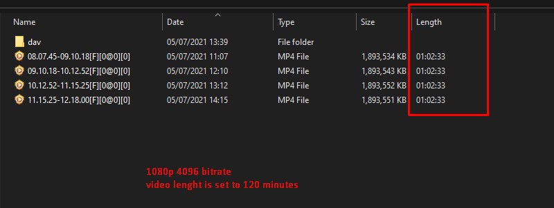

well thanks Revo2Maxx, I appreciate your help.
Here are the answers below,
My device is IP4M -1051
I am using the latest firmware available. which is V2.620.00AC000.3R
Actually I do not reboot at all. camera is open all the time.
The cam is connected to Wifi , that means no cable.
videos are recorded in sd card (128gb) , SDcard format file type is exFAT.
after my latest post;
I tried several other settings to see if any effect. If I reduce to 720p and lowest bit rate. It seems that the issue is fixed!! I got all my recordings ok.
but if I increase to , 1080p and 4096 bitrate, it seems that the issue is again starts to appear. but this time video filenames are correct, but video lengths are again lower than 120 minutes. More interestingly, all the record lenths are exactly same long. please see attached.
- Screenshot_1.jpg (37.82 KiB) Viewed 4296 times

Re: IP4M recorded video time issue
I finally figured out that it is a FAT32 format type issue.
the device does not accept exfat or NTFS.
FAT32 does only allow 1893 mb file size maximum.
so the recorded videos are being cut when the file size limit is reached.
Our IT department also could not connect the NAS succesfully.
therefore my only option is to reduce all video quality parameters and resolution significantly down below. which also make me very sad
