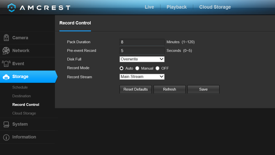

I am using AMcrest IP4M.
The video resolution is set to 2K.
It records the videos in length of 7-8 minutes. and there are too much video files inside the SD card.
Can I change the recorded video lengths? If yes from where and how?
can somebody help me on this?
IP4M recorded video partitions length
Re: IP4M recorded video partitions length
Log into the Cameras WebUI and that can be changed VIA Setup, Storage, Record Control.. See picture of location of my IP4M-1051...
I finally made the change
Glad to see you were able to make the change. Yeah my camera might be showing Cloud in the top and in the left side but I don't use it and wasn't part of my reply it was just a picture of the first camera I logged into. 95% of my cameras have that tab. Sorry if that was confusing my reply.. Most of my cameras have MSD as well. then also have NVR and DVR's I FTP most cameras to a Offsite server for backup and every month cycle that to only keep things that were important enough to keep..

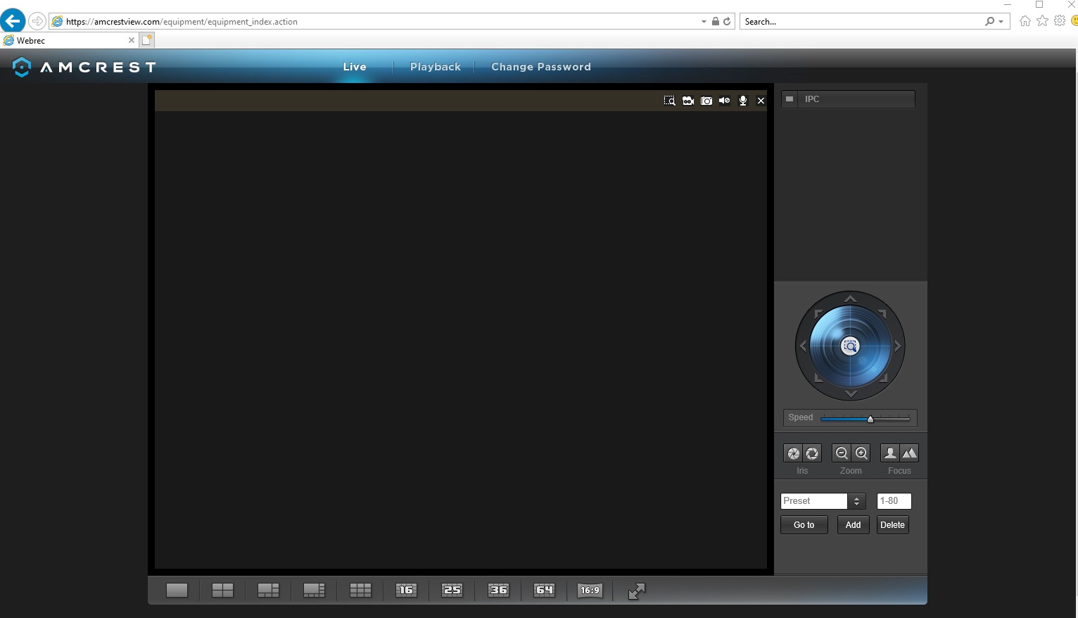

So I am not sure why you use Amcrest view I mean it is there to use, I will admit I did log in once or twice however after some server issues with other companies I pulled all my cameras from off site servers and while I do still use P2P that is secure enough for me to feel good enough about keeping that active until I found out differently..
What I was saying about WebUI.. that is going to the cameras IP address, your using a View website that uses the cameras P2P access to view. Personally WebUI is in your own computer and again I feel better about having my own connections to my cameras.. This would be done like lets say your ip is 192.168.0.34 for your camera typing this into IE or Chrome depending on what FW your using would give you a log in prompt, Put in your user and pass and then you would see menus like what my camera was showing..
yes exactly I connected with the IP and I could manage to change from the setup.
now my video lengths are changed.

Also from the WebUI there is a Record Button in IE, This button will record the current ON screen view and save to your computer and isn't anything to do with the Manual Record setup..
