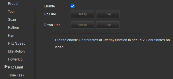

How does one set the limits within which the camera PTZ functions are allowed to pan? Surely I should be able to do this? It seems stupid to have the camera follow an object into a wall. Is it done with the PTZ Limit?
Screenshot 2022-11-02 100557.png (12.54 KiB) Viewed 1179 times
I check the Enable box, but the Setup and Live buttons, next to Up Line and Down Line, seem to be disabled.
Thanks everyone in advance.

No, that screen doesn't have a Save button and when I go back to it, Enable box does get saved.
My problem is, this user interface does not let me set any values to the Up Line and Down Line parameters, being that both the Setup button and the Live buttons are disabled (greyed out).

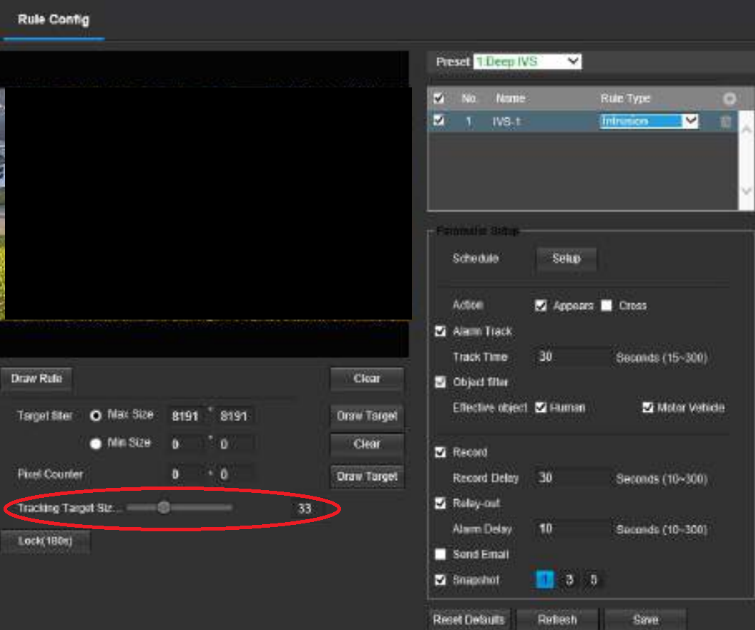

I'm not sure what you are doing with manual or auto tracking, but you may be in the wrong place to control the tracking area.
I don't have your camera, but from my quick look at your camera User Manual, you should check out pages 15-16 and pages 53-54.  Or do a document search on "track".

However looking at the Doc, 53-59 it keeps talking about Tracking size and then the text behind that says tracking area and to be honest could be the odd thing they are looking for or might have nothing to do with tracking into the wall. Maybe that is what they need to adjust

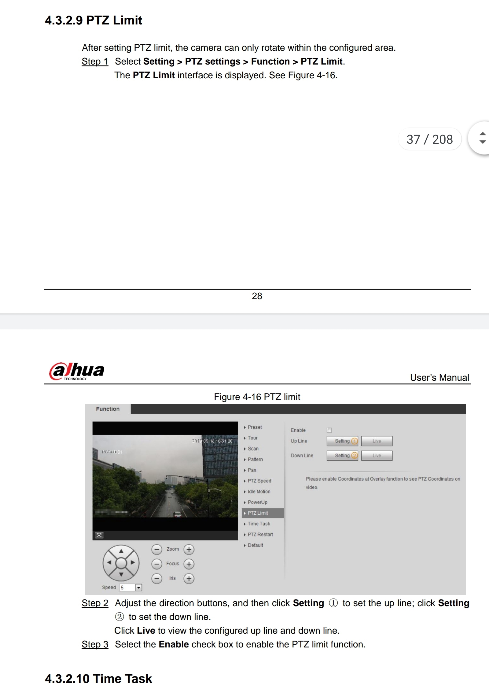

OK, try these instructions Do not click enable first.
Screenshot_20221103-115149_Google PDF Viewer.jpg (510.21 KiB) Viewed 945 times
Amcrest support should be helping you with an $800 camera.

Thank you jack7! That was very helpful. I was able to follow that set of instructions and set the limits for the tilt angle or vertical angle. I can't believe the Amcrest documentation doesn't explain this very non-intuitive user interface.
Setting the tilt angle limits is good, but I was looking to set the horizontal angle limits too. You are right. Let me try Amcrest Support.
