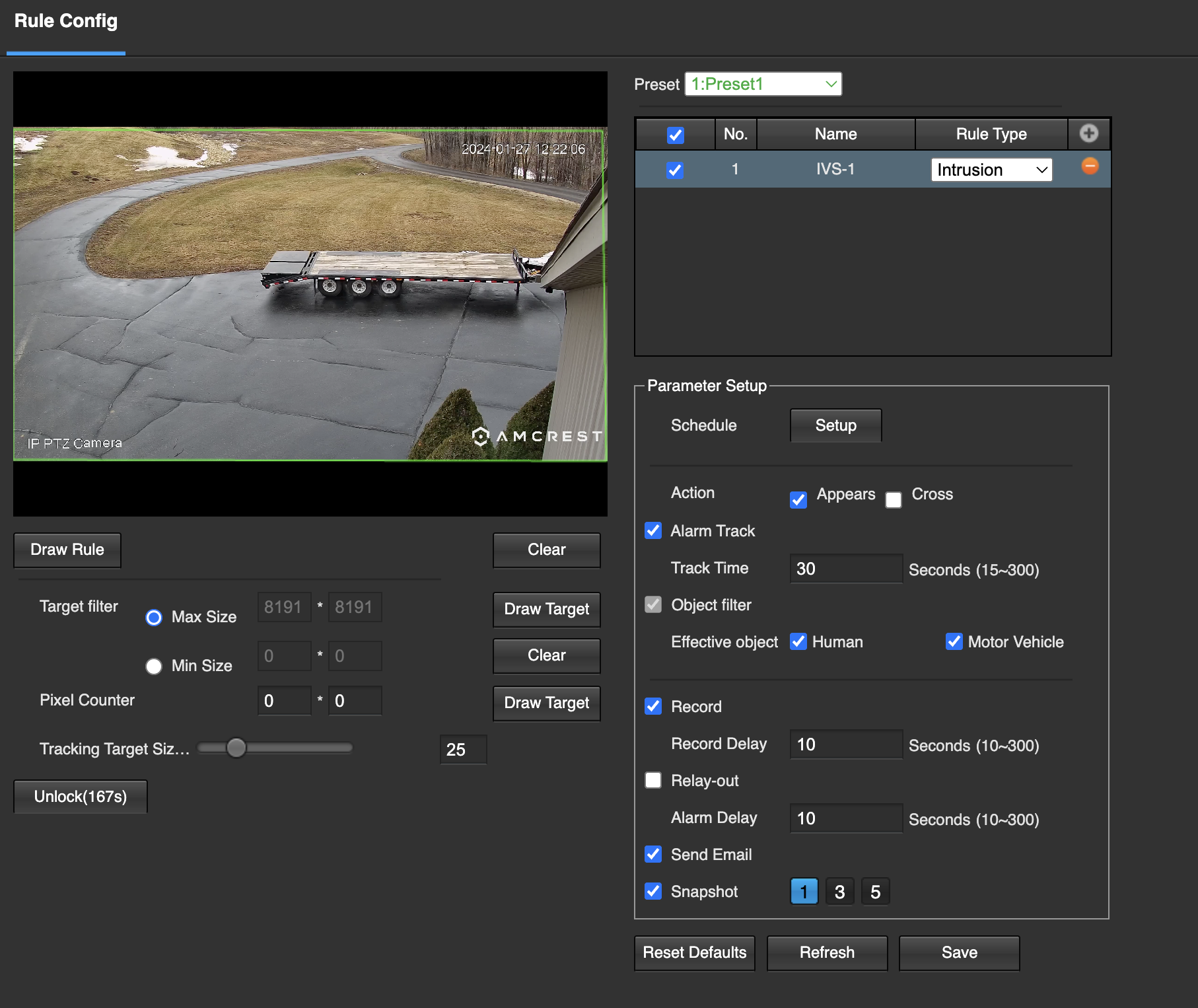

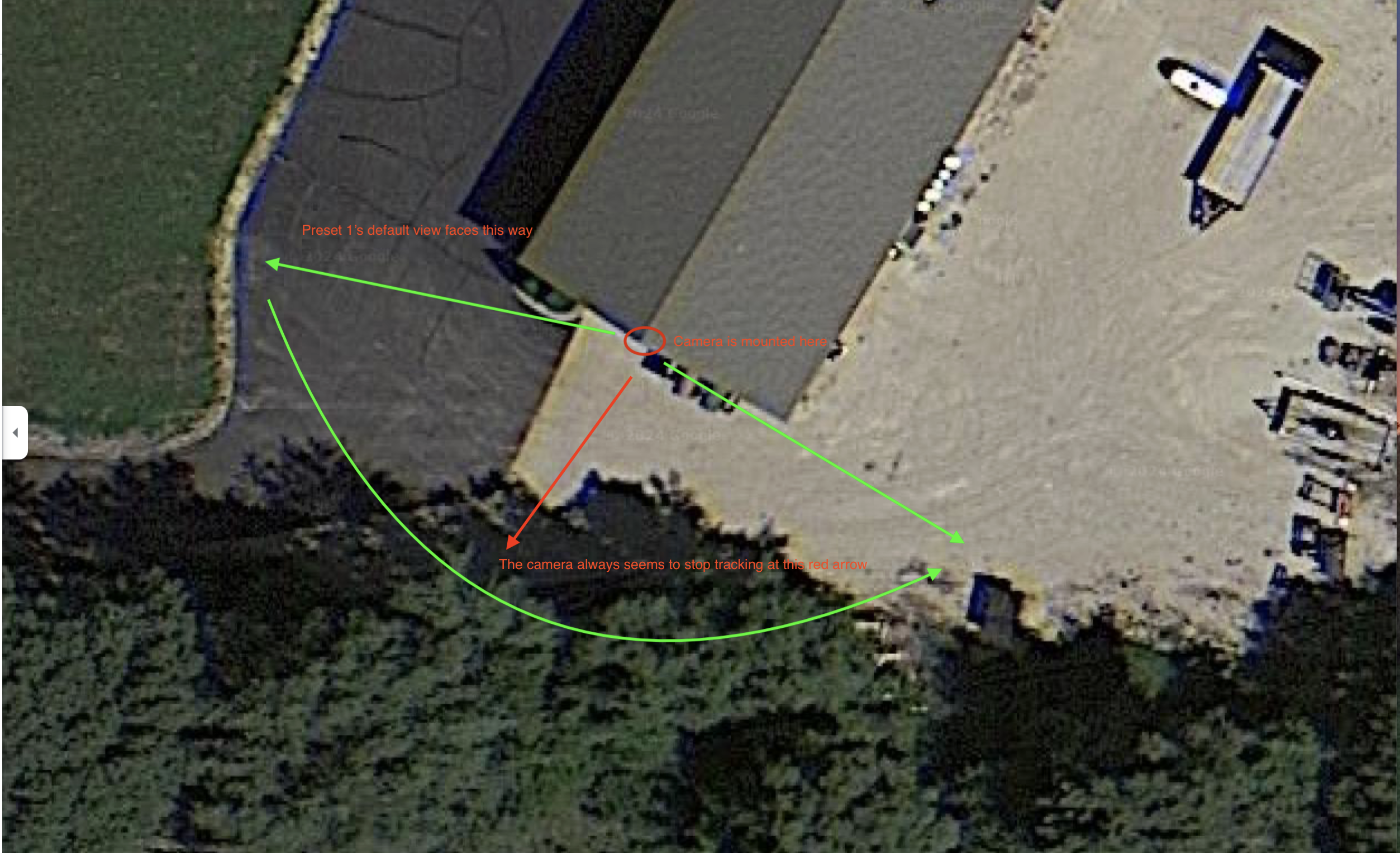

I recently purchased the IP4M-1083EW-AI camera. I use a Synology NAS for my recording storage media. I am trying to get this camera to track and follow people and vehicles on the side of my shop. The coverage area is about 180/ish degrees. The camera will track and detect people, follow them up to roughly 90/ish degrees, then just stop and go back to it's Present 1 default position.
I've tried creating 6 preset zones with a rule type of "intrusion". Those 6 zones over lapped each other and would follow from the front to the back. Currently, I only have 1 Preset zone setup. But no matter what I do, the camera seems to always stop tracking someone about half way. I have attached some picture of what I am trying to accomplish. I'd like the camera to track and record everything inside the two green arrows.

IP4M-1083EW-AI: Deep IVS Stops tracking people
- Screenshot 2024-01-27 at 12.22.06 PM.png (1.08 MiB) Viewed 1769 times
- Screenshot 2024-01-27 at 12.25.40 PM.png (4.42 MiB) Viewed 1769 times

I don't own this camera, I have a few Auto Tracking cameras and most of them are much older Tech from 2014 or before. However if I had to guess, I would say that you might want to adjust your Track time. It looks like you can go to as much as 300 seconds on yours. So I would adjust it to a time that it matches the area of leading to the last sighted area. Only issue with this is someone in Vehicle would be faster then another on foot. So
Don't want to tell you how to setup your camera, However if it was me I would put the camera at that location on a Parapet to get it to pick up the area that is past the edge of the building. I am sure, you more then likely have that covered with another camera anyway just trying to make sure the object isn't lost by going past the corner of the building..
Next to be honest, I would put a camera or an Alarm sensor that is down at the Starting area into the view. Have that Sensor tied to an alarm input on the camera or if you had a NVR like my 4216E-AI into the NVR's alarm input. Once the camera or alarm gets triggered it alerts the NVR or Camera to a preset that then the person or car can be Tracked coming onto the property.

At one point I did have the tracking time adjusted to 300, but the camera would react the same way. I have other cameras on the property that picks up the views that the shed blocks. The issue is the way the shed's roofline is, I would need to be above the shed a lot in order for the shed not to block some of those views. This camera stick out enough as it is. LOL. It's large!Revo2Maxx wrote: ↑Sat Jan 27, 2024 3:14 pm Hello and Welcome to the Forum

I set up 6 more zones in the area that I wanted to cover and I got the same results. Tracking time is set to 300 in all zones. What I might do is have the Synology manage the detection Algorithm. It had build into Surveillance Station's software it has these advanced detection algorithms, so I might give that a shot. I'll do more messing around and report back. If I can't get this to work as I think it should, I might have to return these cameras. I have 1 more I was going to install but I am hesitant at this point.

With the Synology controlling the detection, it now almost makes it 180 degrees. I walked from the front of my shed to the back, the camera kind of followed me, I had to get back in front of it once, then it followed me to the back and wigged out. LOL. I'll have to keep messing around with settings. Honestly, at this point I might factory reset the camera. Maybe I've got settings that are conflicting at this point.
