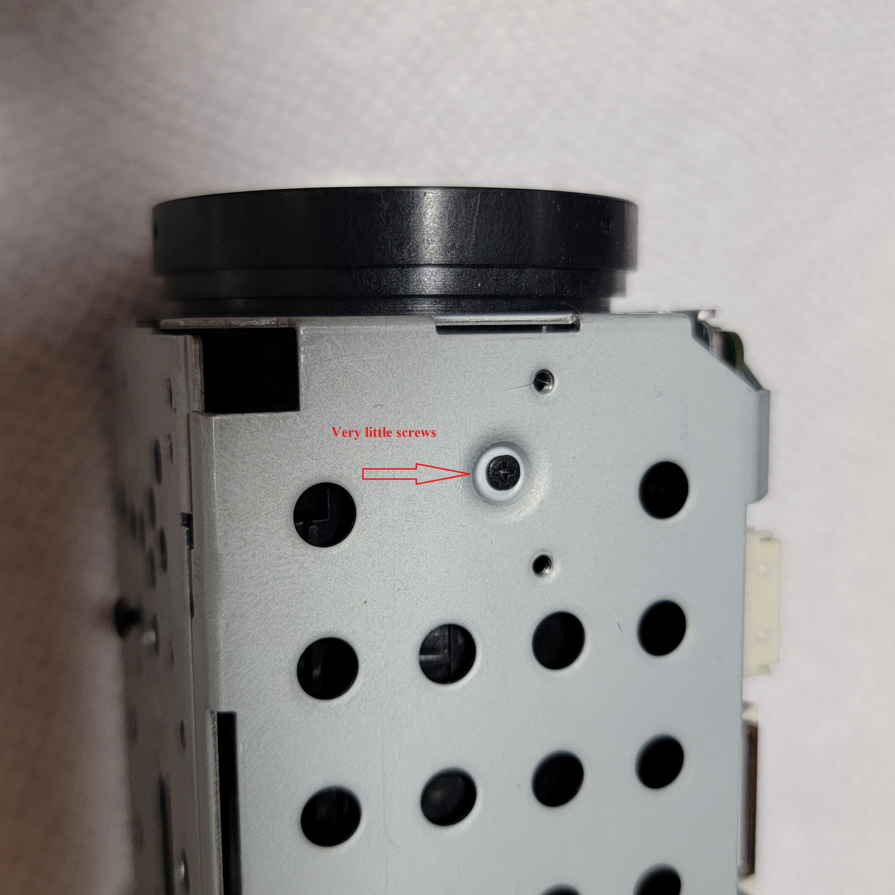

Now for the next part it is little bit harder.. The Camera module will need to be Removed (4 screws) and taken apart. You will need a Micro Set of drivers for taking out screws. There are 3 that hold cage to the lens and around 6 that hold cage together.. Once the cage is apart there will be 3 wires sets, 2 flat cables one for camera other Lens control. You will want to make it so you have access to the camera control PCB that is the board that is inside the cage only access is by removing the cage.. However before doing that...

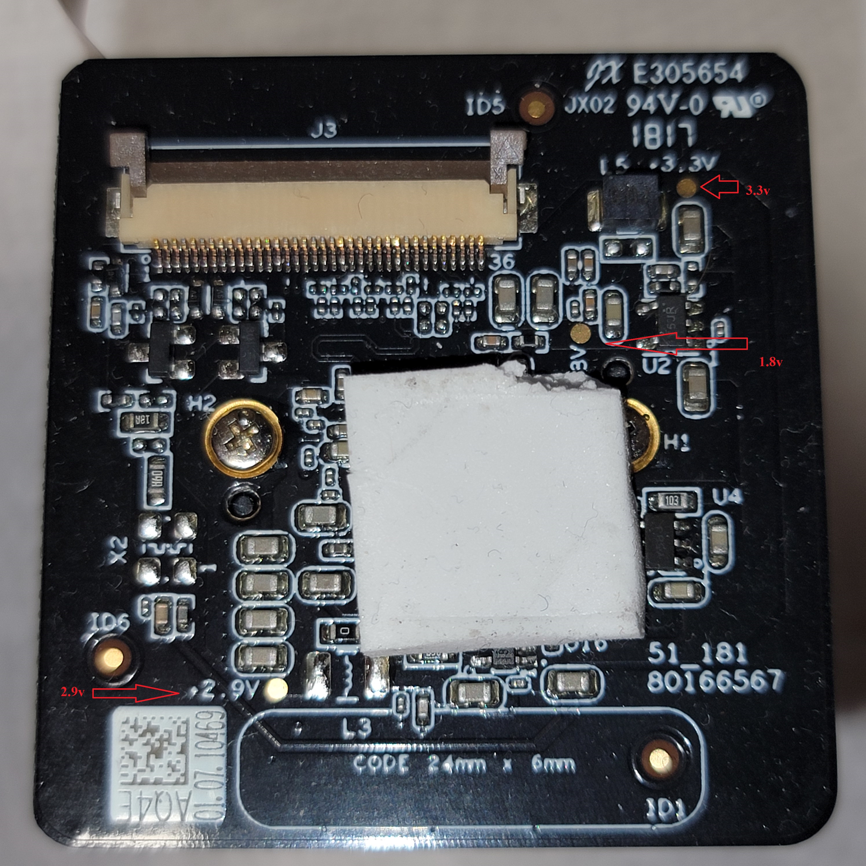

Before doing the step above I would maybe test the Camera board for power. There are 3 testing ports on the camera board that is the pcb that is on the back of the LENS.. the testing pads are very small and your looking to see if the camera is getting right Voltage. I can't remember the full values right now however I know or think is 1.8v, 3.3v and I think the other is like 1.28v or something like that The Values are posted on the PCB next to the pads. One of them is by the cross brace under Chip cooler pad, so will need to be careful not to short out if cage is left on when testing... If they are not on the camera board then you know that your looking for a Voltage Regulator issue however that is still going to be on that board that is connected in the cage with the lens..

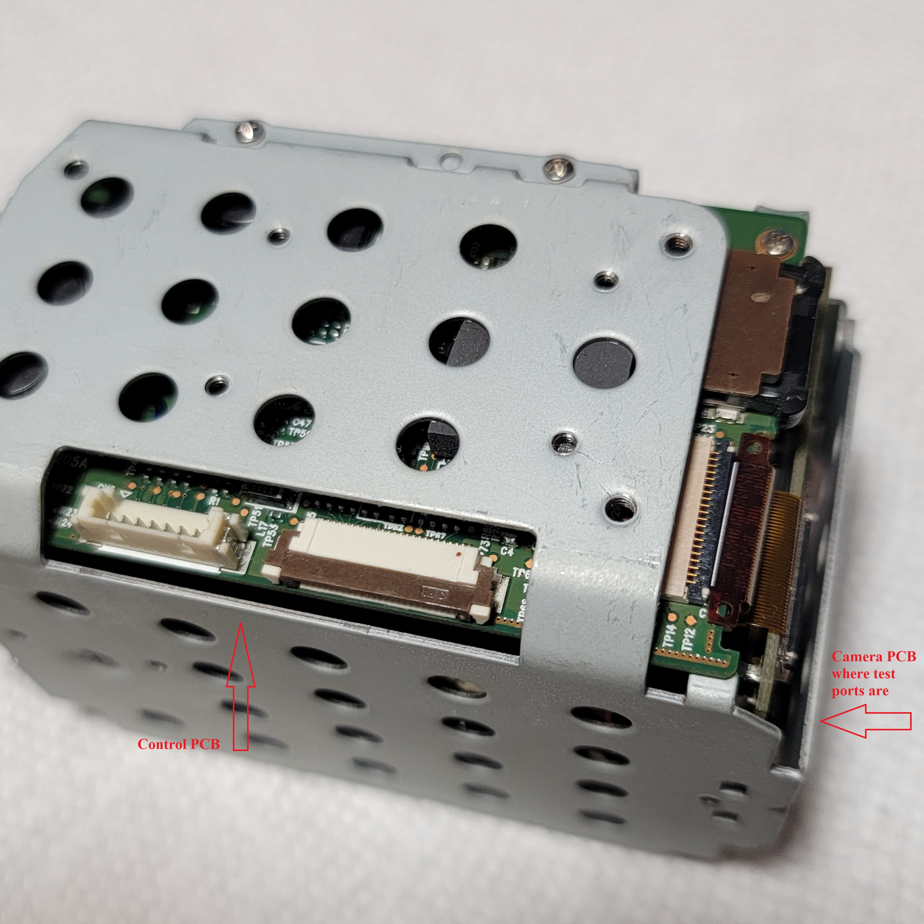

Give you an idea of what I am talking about cage PCB and screws this is a Module form one of my 37x PTZ cameras..

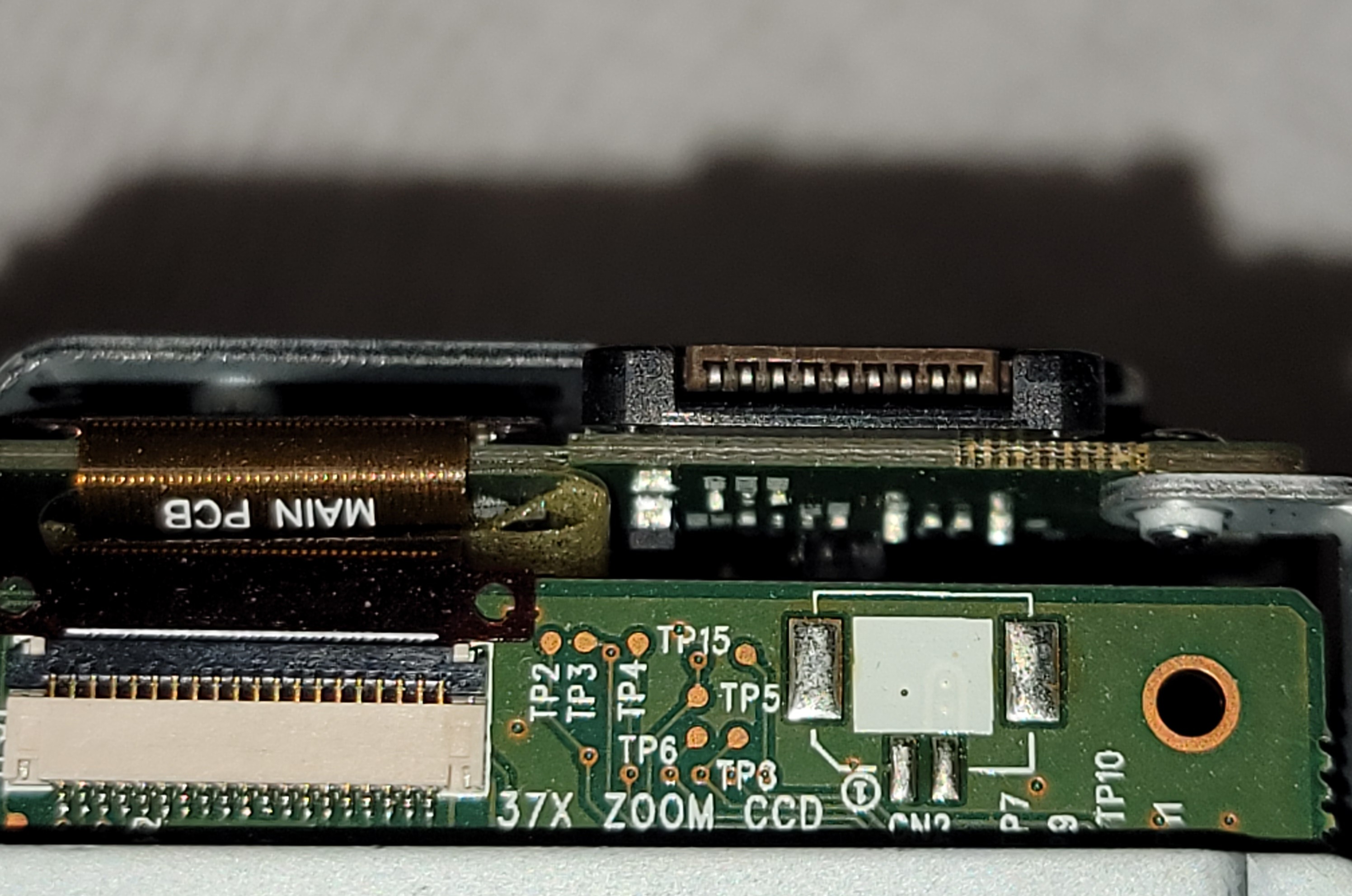

Also the camera in pictures has more test ports then the Amcrest camera module. People don't make cameras like the one in pictures with that much in test ports and repair ability. Most camera modules today are Guess and test over and over until you get it figured out.. The pictured unit also has values with good part numbers for regulators and other IC chips where most of the others from today standards are chips with markings that are hard to find replacements..
Had a camera on my Repair bench for 6 months because of parts that I couldn't find.
In the top picture the TP next to a Copper pad is for testing and that camera is from 2011
Here is a better picture of the Camera PCB not to be confused with the main PCB.. However it will be the PCB where the 3 test point are that I was talking about.. again this isn't your camera module just one of my 37x units..

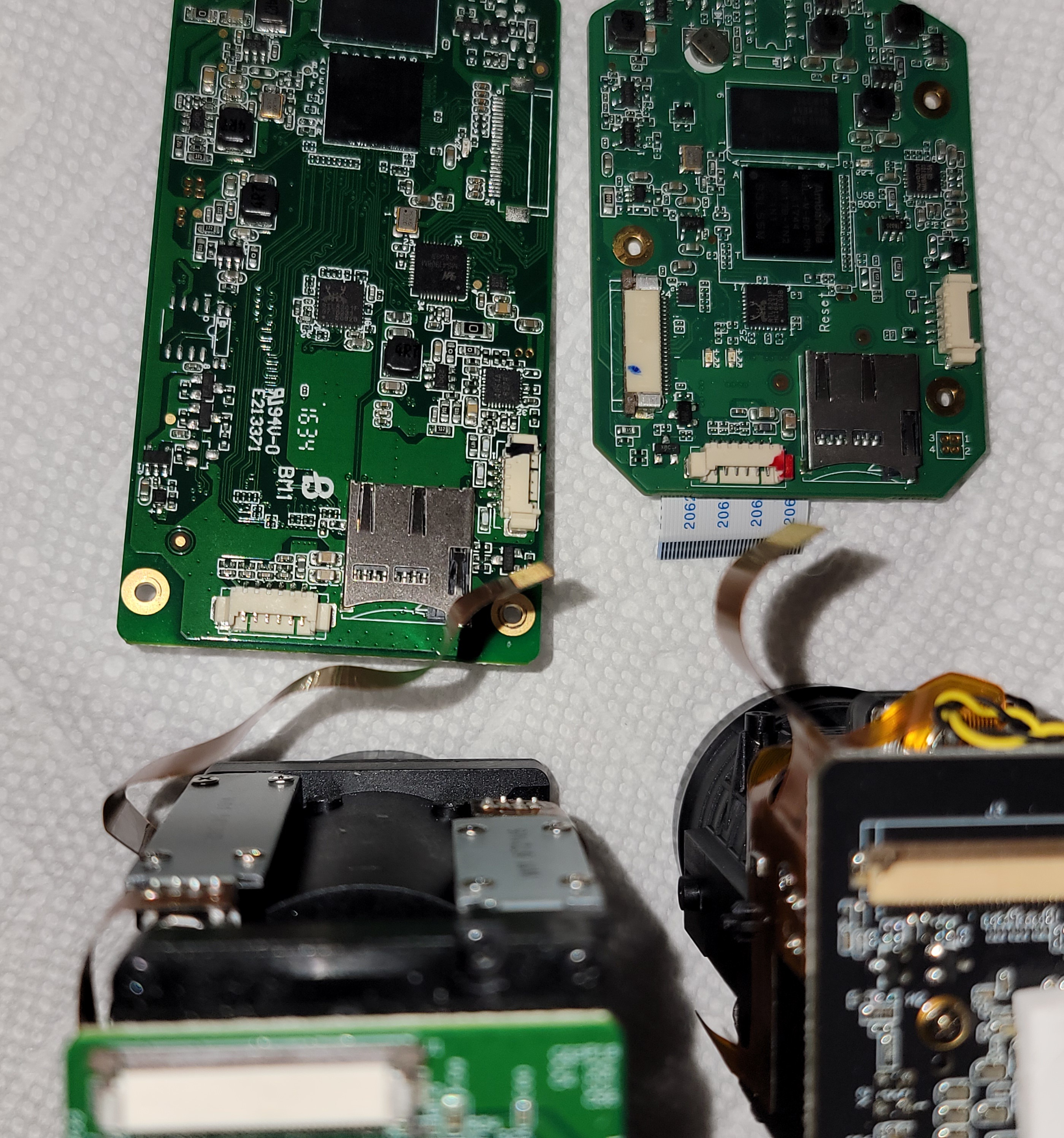

Here is some pictures of my 853 and 850 main board and the second picture is from the 853 camera baord where the 3 test pads are.

So the LEDS if you look at the first picture of my last post, on the right that is the 853 my guess is your 1053 will be something just like it only difference will be yours 4mp camera over my 2mp.. I am guessing that yours will be setup just like it.. anyway the LEDS are at the lower part of the board next to the Micro SD slot.

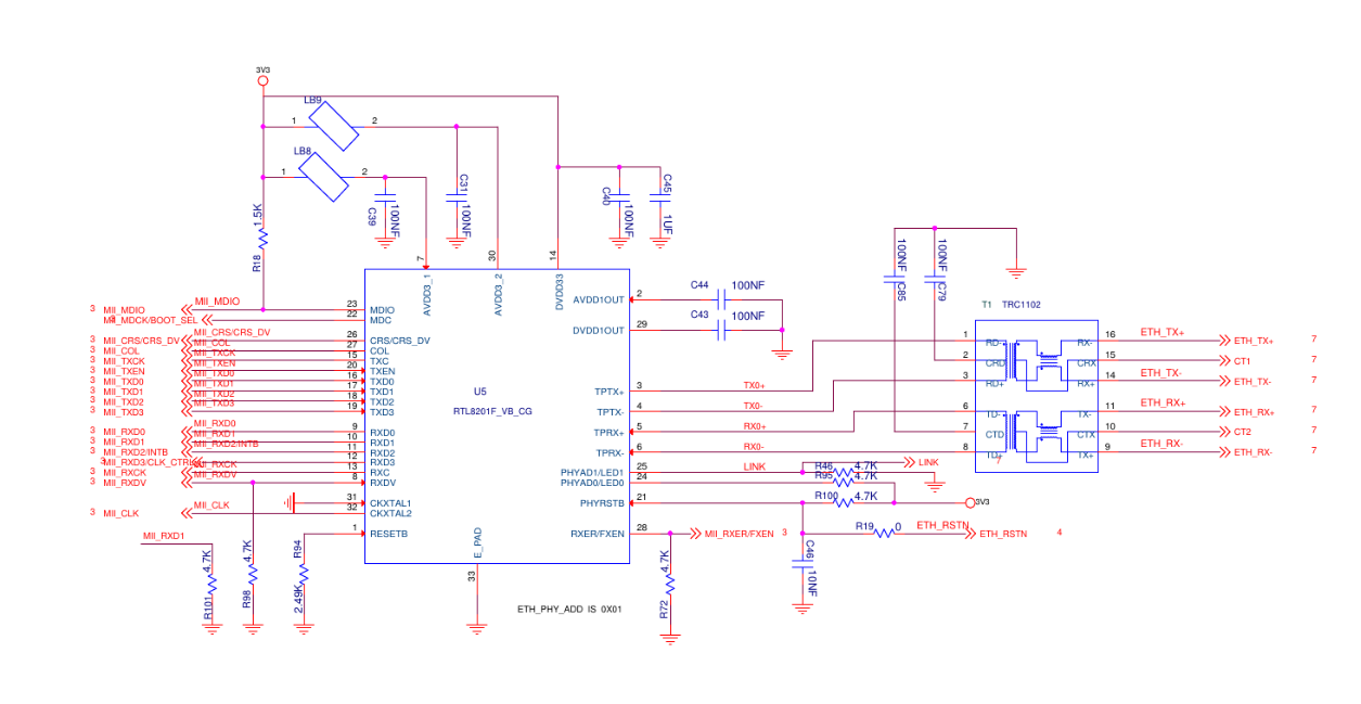

So the Chip for Network is a very small 33pin chip again this is a guess seeing I have not touched the 1053 and going off my 853 main board.. Anyway it is about 5/16 to 3/8in square. On my board pins 3, 4, 5, and 6 go though the board through VIAS. I personally don't know if it is more then a dual layer as it does look like it could be multi layer.. On my board that is how it is anyway because the network transformer is on the other side of the PCB. If you don't have a fine tip multi meter tip you will want to follow the tracks to something large enough to get the tip you do have on for taking some numbers. This is a Schematic for the RTL8201F and may not be 100% the same as what is in the 1053 however my guess it will be as close to the numbers as stated on the sheet. Maybe it can help guide you to the issue if that is something you feel you want to do. Just note that replacing it will require some soldering skill and tools that normally most home users don't own. Cheap hot air station could cost more to the owner from damage, then a good quality one from Weller, Hakko or JCB. Just saying..
