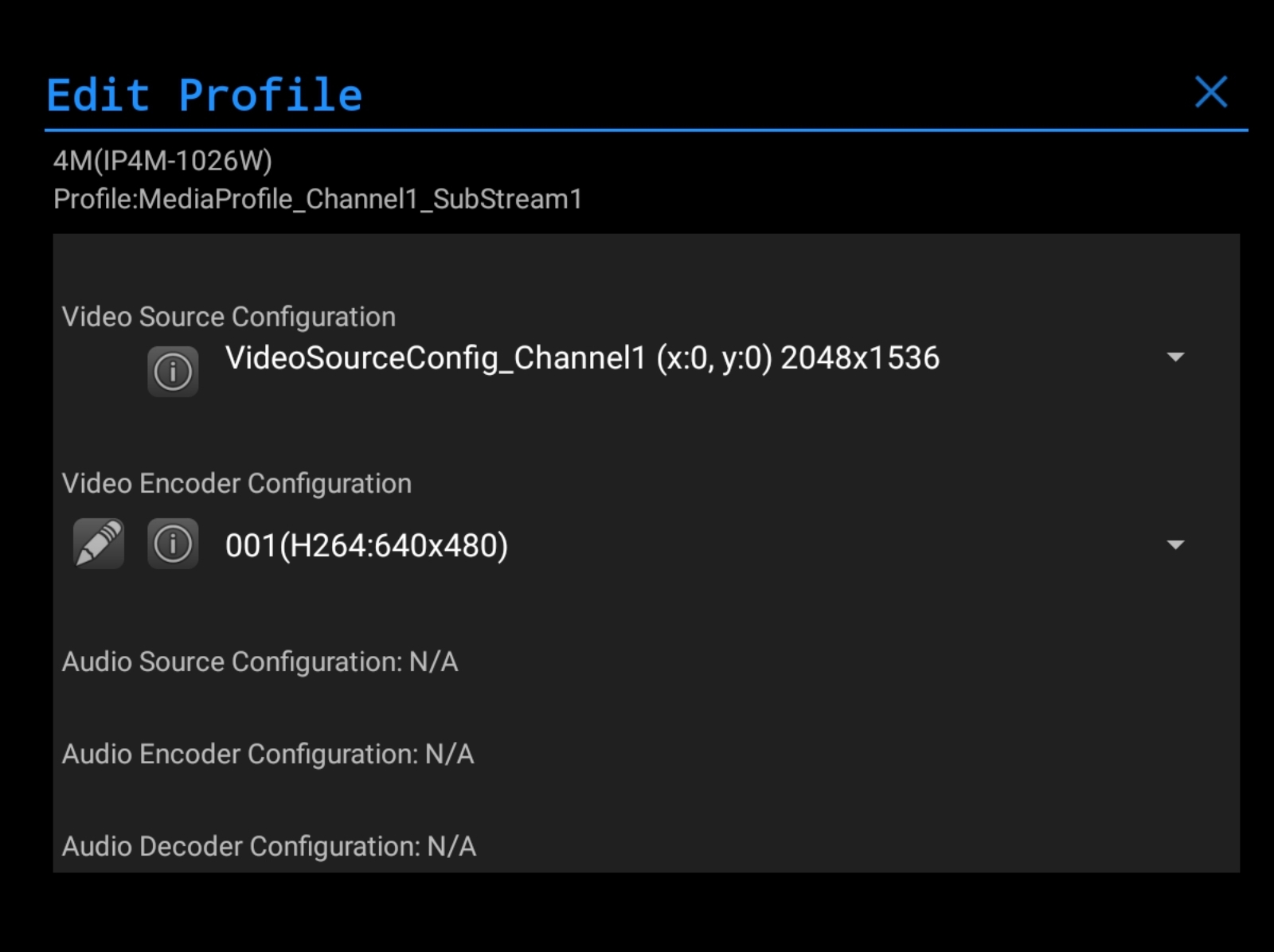

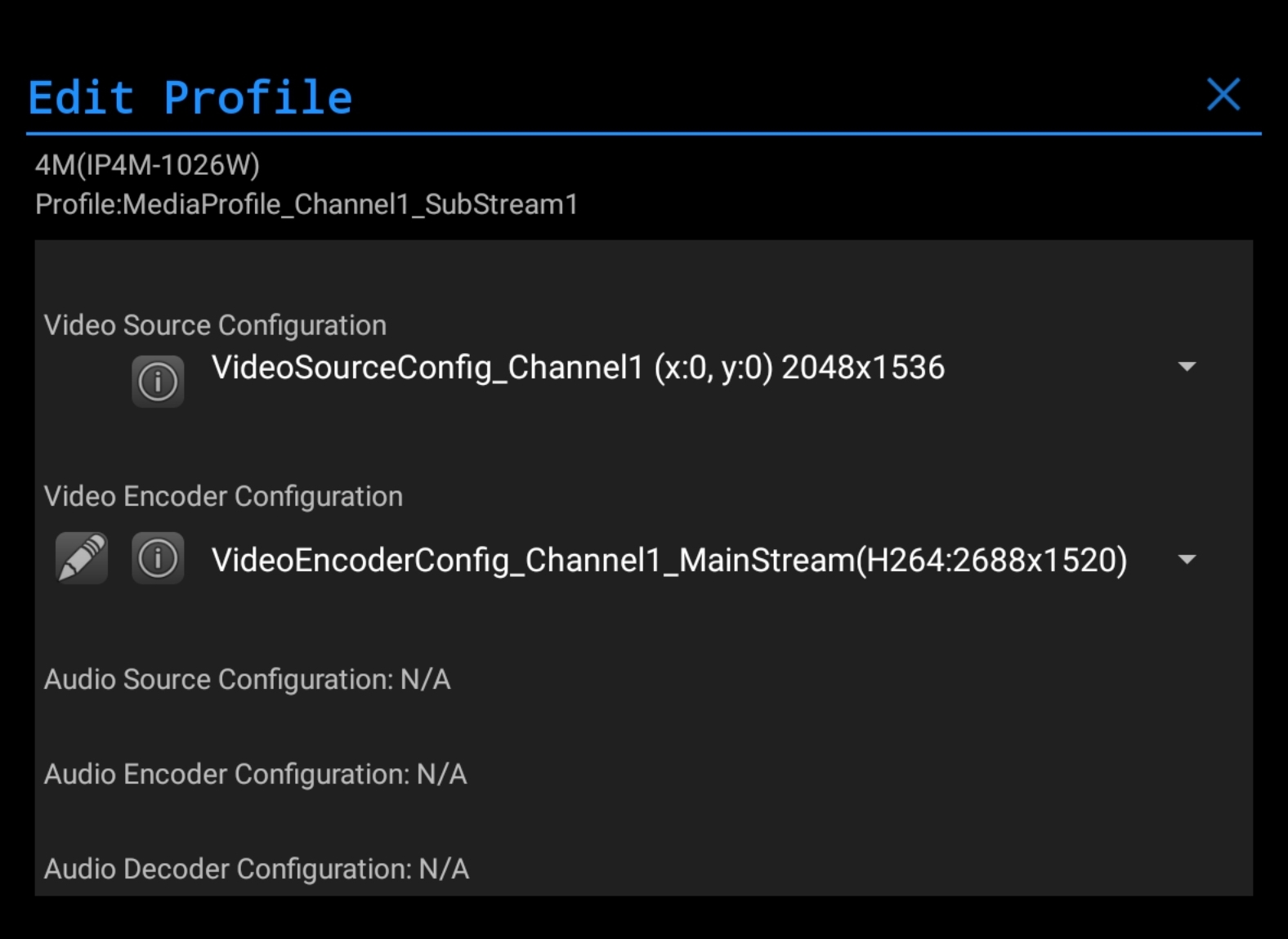

I can change the ONVIF substream profile for a different Amcrest 4M camera using android ONVIFER app.DataMeister wrote: ↑Mon Aug 03, 2020 12:16 am ...
It would be nice if the bug could get fixed in the ONVIF profile being served up by the camera. Can it be manually edited?
The first pic shows the substream profile where it has video encoder set to 2688x1520 resolution. I earlier set that resolution. Click pencil to change to 640x480 resolution. Second pic shows it changed. It works as expected in ONVIFER live view.
Maybe some program you used changed your substream profile, and it's not a bug.
