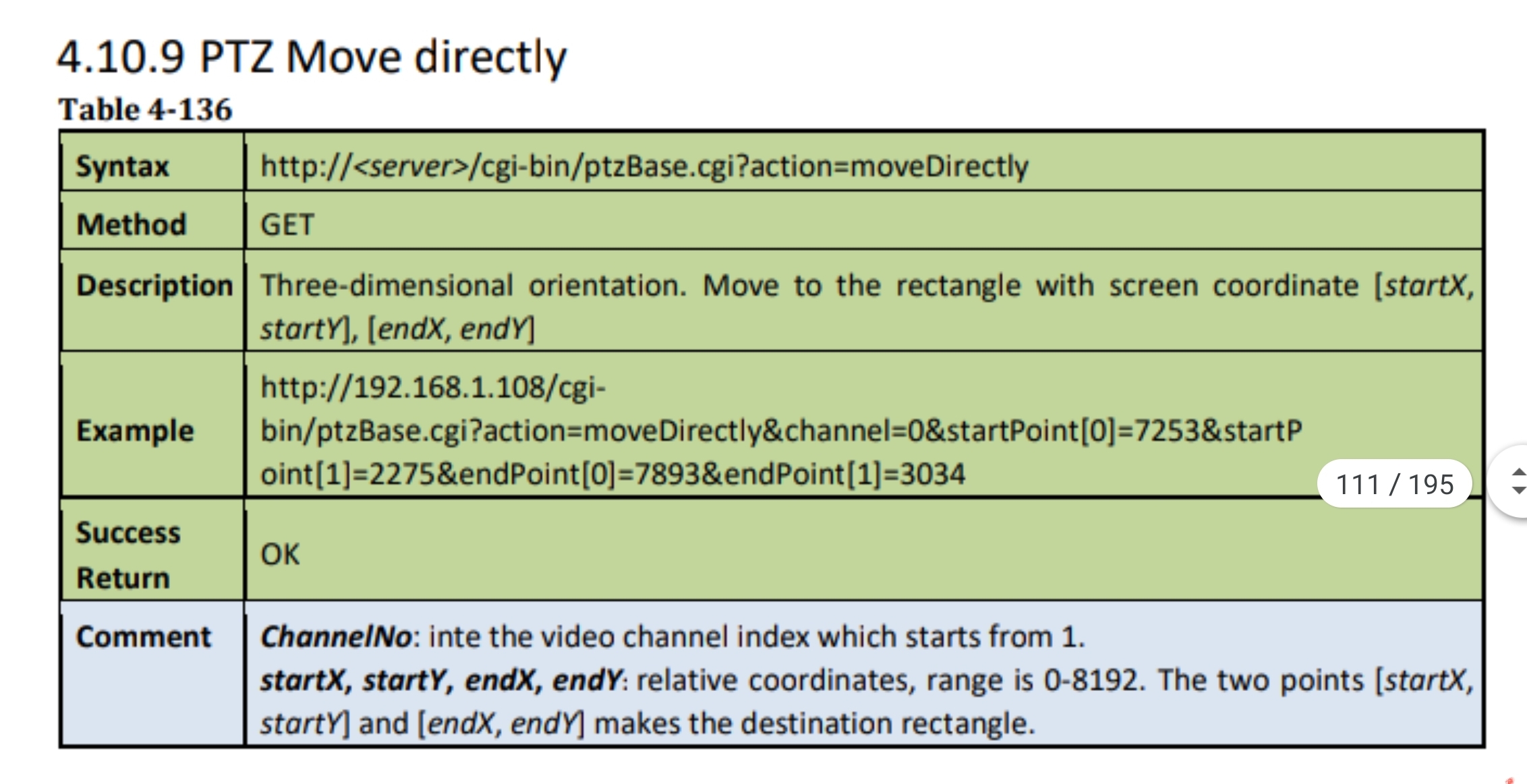

The API has other methods to move the camera incrementally.  This may be a good one if your camera supports it and you figure out the repeatable error value.
Screenshot_20220510-091657_Google PDF Viewer.jpg (581.54 KiB) Viewed 1153 times

Looks like that's not working/implemented. :/ I get a:
Code: Select all
Error
Not Implemented!
