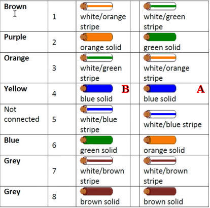

Re: IP4M - 1026EW Camera Re-Wire to Keystone Jack
I just went and took apart a camera that has bad cord It is a Dahua branded camera. While I am not saying that it is the same as yours I would after taking the end off if you have a Multi meter honestly I would test the wire to the end on the camera because I have everything that you stated above however there is only 1 slight change and that is both 7 and 8 share grey where yours says not used... So I made a Chart.. Please note the B and A in them for the people that have 568A or 568B

After clipping the wire, and taking it apart - I noted there are 2 YELLOW wires and NO ORANGE wire.
I noted upon 2nd look that the previous wiring diagram I was given was for a different camera then the one I own by amcrest support. (still waiting to hear back for a correct diagram if they have one)
How does one figure out which wires go to which without a diagram?

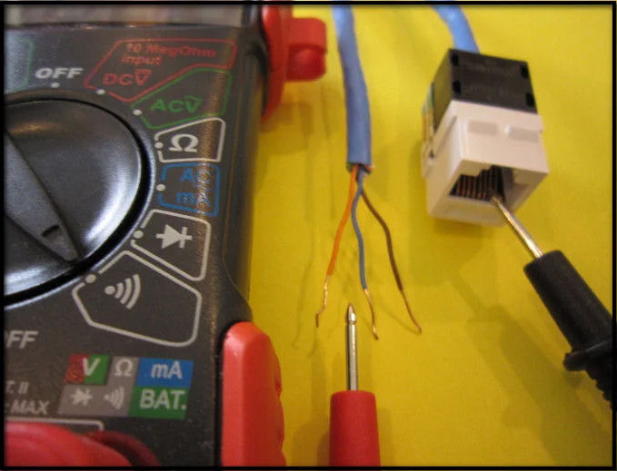

If you have a Mulit Meter you could take the Multi Meter and put in Diode Mode aka Beep Mode and then take the wires that were in the case and then test the pins in the End to each wire and note down the color as I did...
However please note that you will want to do this off the cable end and not off the board end of the wires because if the camera is bad Not saying yours is.. However is someone is trying to pin out off a Camera side wire and the system has a Short it could tell you that you have pins 1 and 2 and 3 all the same when in fact they are not but because of a Short in the board it acts like they are ...
So the end you cut. Strip the outer cover off of. Strip the wires they are going to be small so some good tools are needed.. take your meter and test the wires to the pins.. Just like I said it might be that the Colors for that camera is what they sent you in the Normal or First release and the camera you have is in a later release and the colors are sadly different... So take the Meters red wire Touch Pin in RJ45 Jack pin1 then use meters black wire touch the wires until you hear the beep. Ones it beeps write down the color on a Chart... When going along and you hear the beep don't just stop there because it could go to more then 1 Pin.. Like in my chart above 7 and 8 had same pin to Grey... While this might not be the same in your case... There is only 1 sure way to know and that is to test it out....
Edit: Also might want to make note that the Wires in the cable will be Stranded wire and not solid... Most Keystone jacks are for SOlid wire.. you will want to make sure you make your repair correctly or it might not work...
