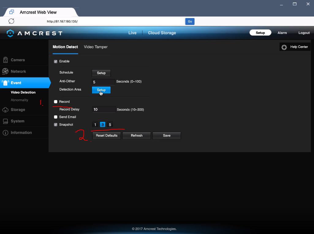

I have snapshots kindof working. Not sure what 1, 3, 5 means below.
However, it's not predictable when I get a snapshot.

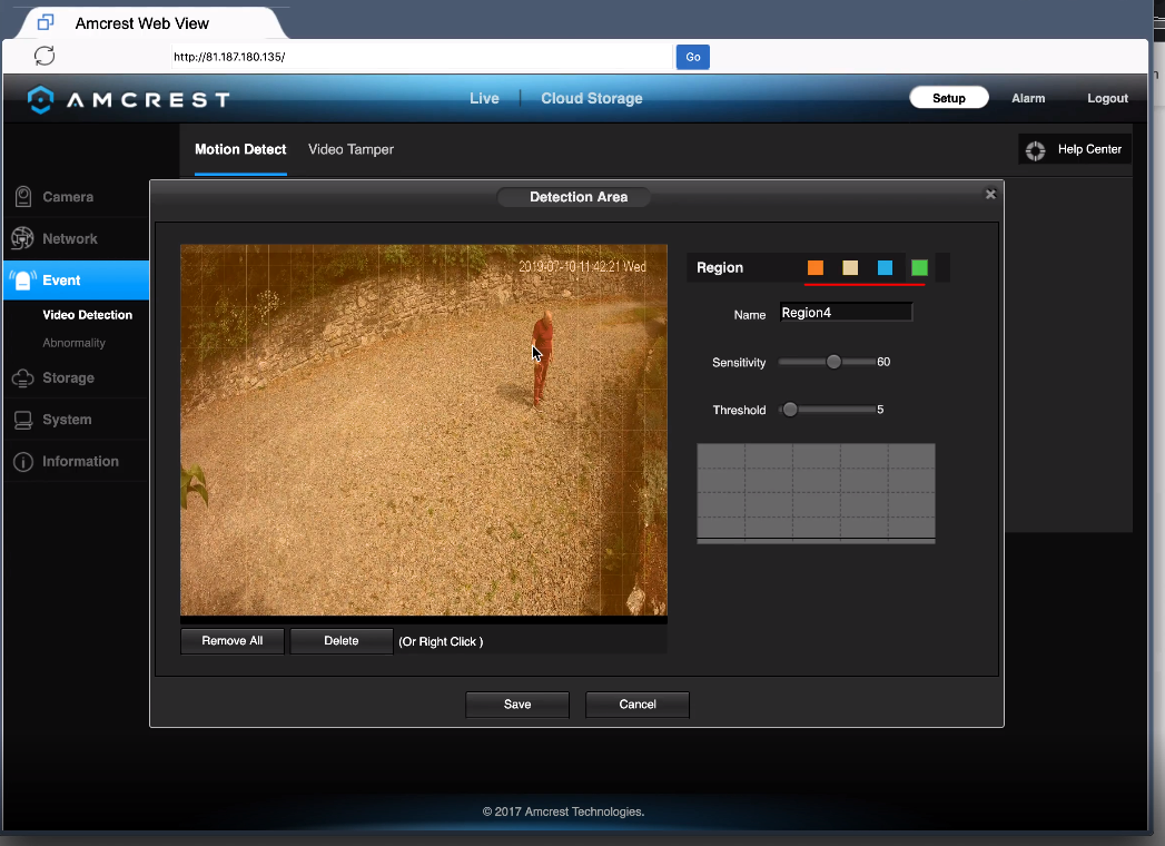

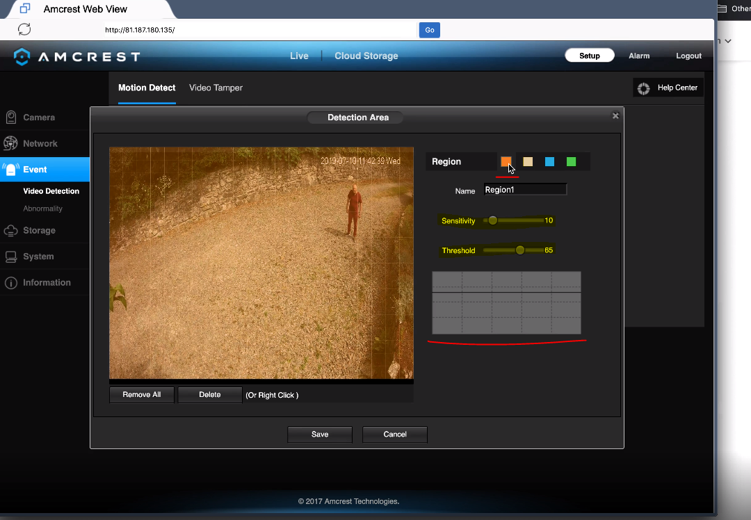

1. You are currently selected on the Green ( Region 4) However you have your FOV outlined with Orange ( Region 1).
2. you can see here that when you select Region 1 the graph is also different indication this is the default Region in use at the time.
Also, I highlighted your Sensitivity and Threshold. In most cases, 60 sensitivity and 5-10 Threshold is the best. Low sensitivity and high threshold will mean your target will need to be in the picture for a VERY long time and constantly moving before it will trigger the system to record.
3. (1.) make sure you have the Record Option enabled to record the detected motion.
(2.) This is the number of snapshots it will take and send. you can toggle "Send Email" and if you have your email set up in the system you will receive One, Three or Five Snapshots of the event.

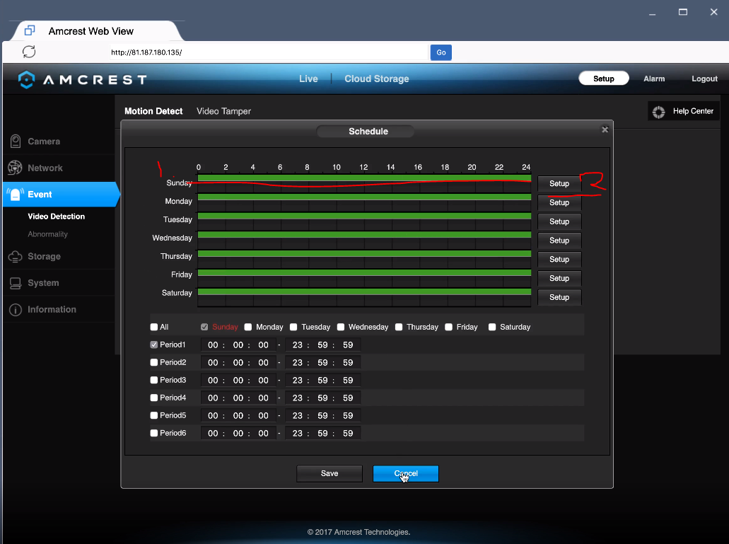

(1.)You need to make sure that you have Motion Detection scheduled. Currently, the Green line symbolized Continuous recording (General Recording).
(2.) Inside setup there will be a different color for Motion detection, This color should be yellow. When motion detection is scheduled you will see a major difference as of right night since it is not scheduled the device is not looking for motion.

I think I was missing the Record being ticked, as you indicated in Capture3.PNG. Thanks for that!
I had to adjust the motion sensitivity as I noticed it was triggered by rain otherwise. A common occurrence in England!
