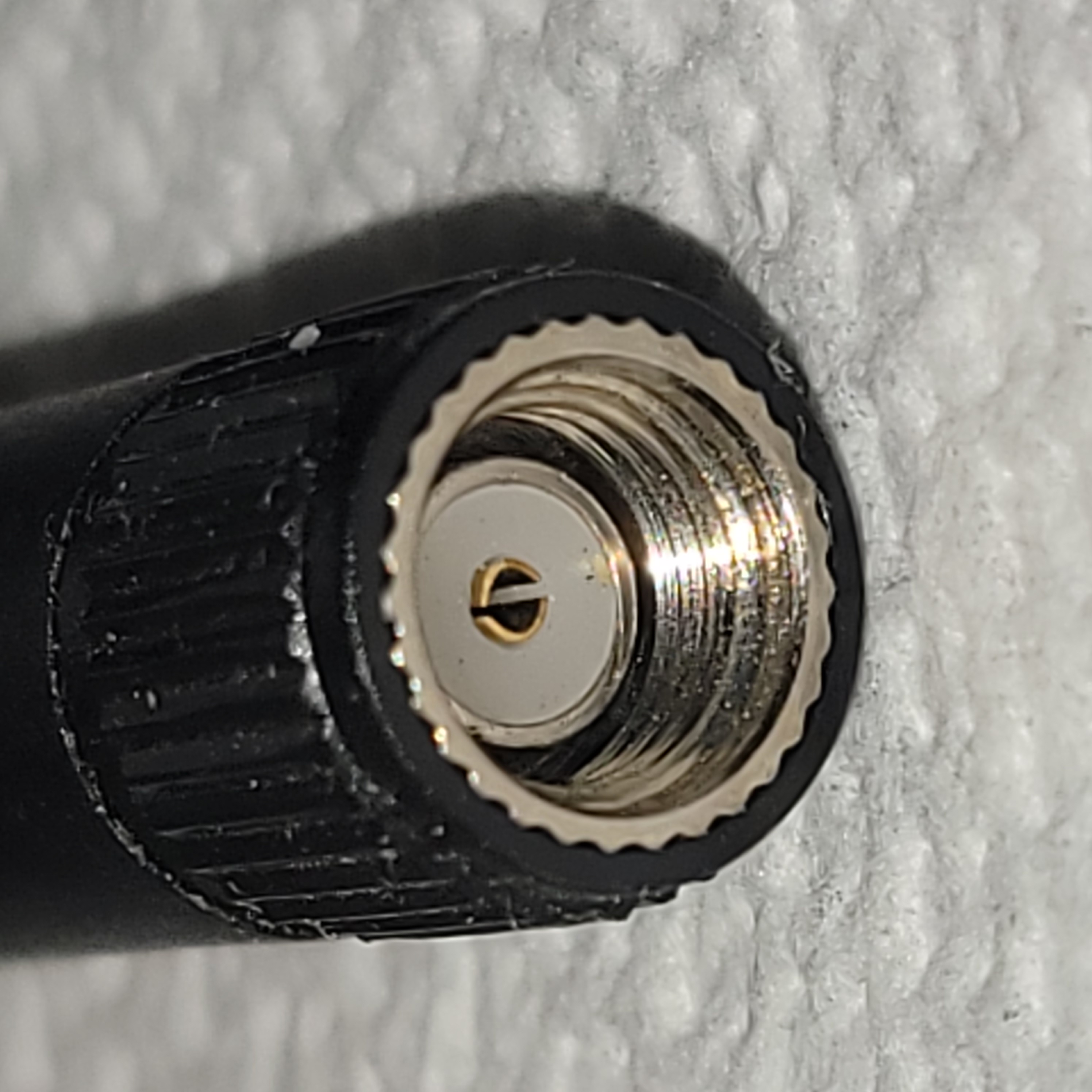

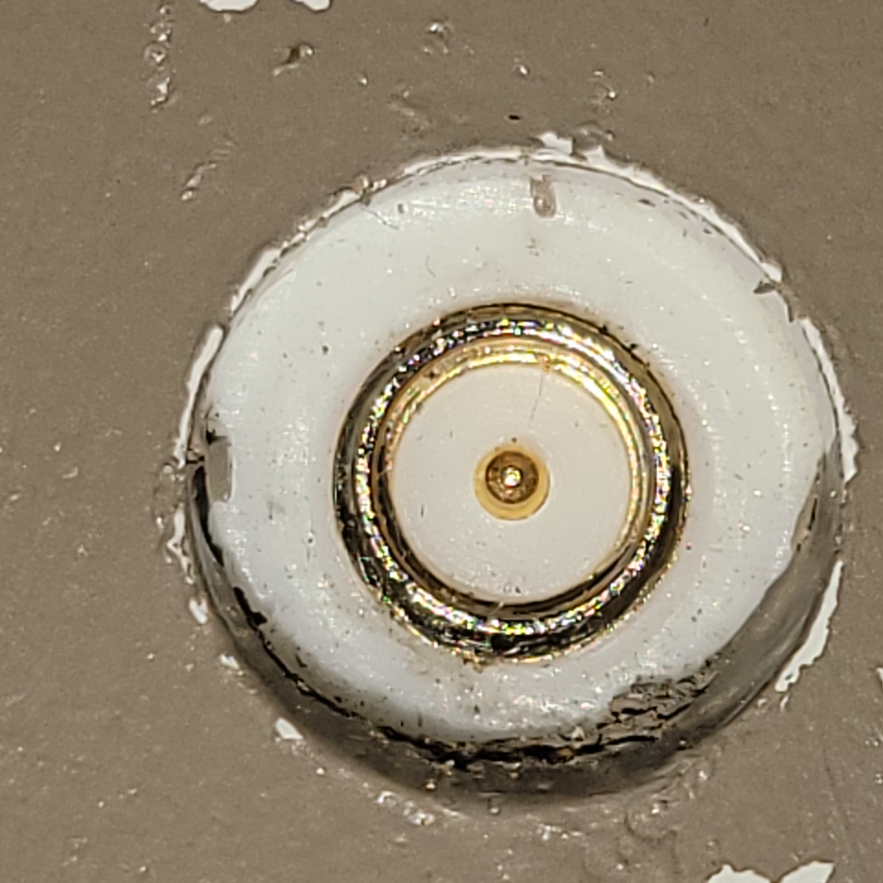

I was having the same connectivity issues with these cameras. I noticed the antenna and antenna port on the camera both have a center pin. When screwed in, the pins cannot occupy the same space, so they bend, causing a poor connection.
Re: IP4M-1026 WIFI Connection Isues
Don't have that camera but this is from an 858 PTZ camera and the antenna that I use with it.. Should be like what yours or others have. There should be a Pin on the camera side and a hole in the antenna and if there is 2 pins then it isn't the correct one for the device,
