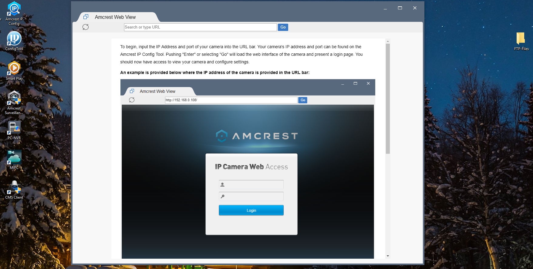

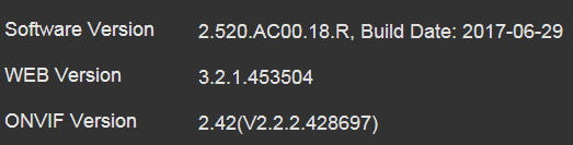

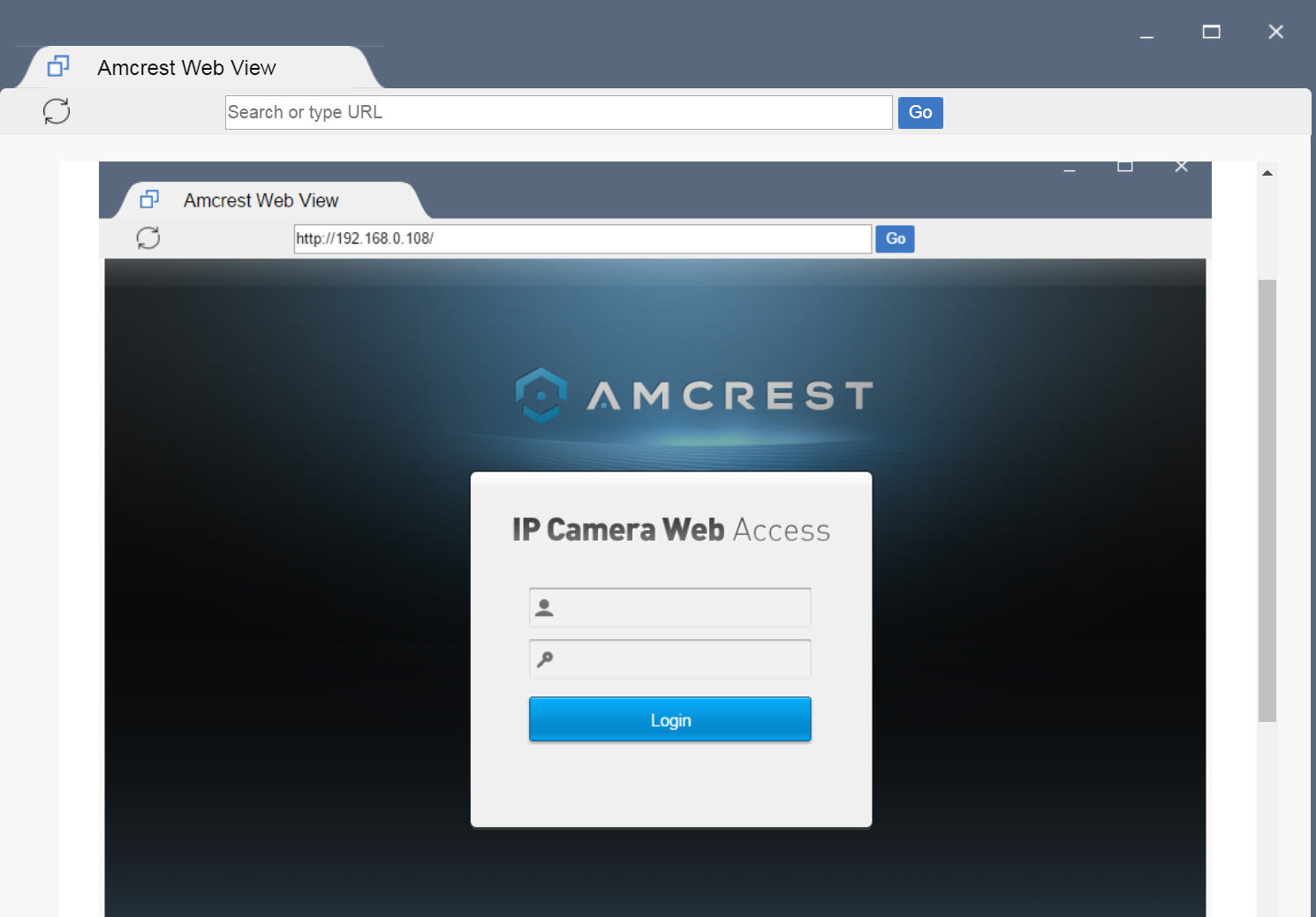

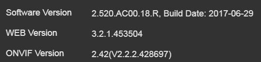

I am not sure. Sounds like there is a moment that you make a connection with the Chromes Amcrest View App. Then when you bring it up again it don't link over to the app and trys to access with Chrome... When you log in the first time does it look somewhat like the picture I am attaching or just your chrome. Can you log on the other one for the first time. Or always are you saying that the one camera you can log on view Chrome. Can you take a Screen shot of both of your cameras info. Just edit out the SN that isn't ever anything that should be made public...

I'm not sure what could be causing that issue, as Revo2Maxx showed, if your using the Chrome Extension it should work fine, if you are just using Chrome and not opening the Extension App it will always recommend you to download a Plugin.
