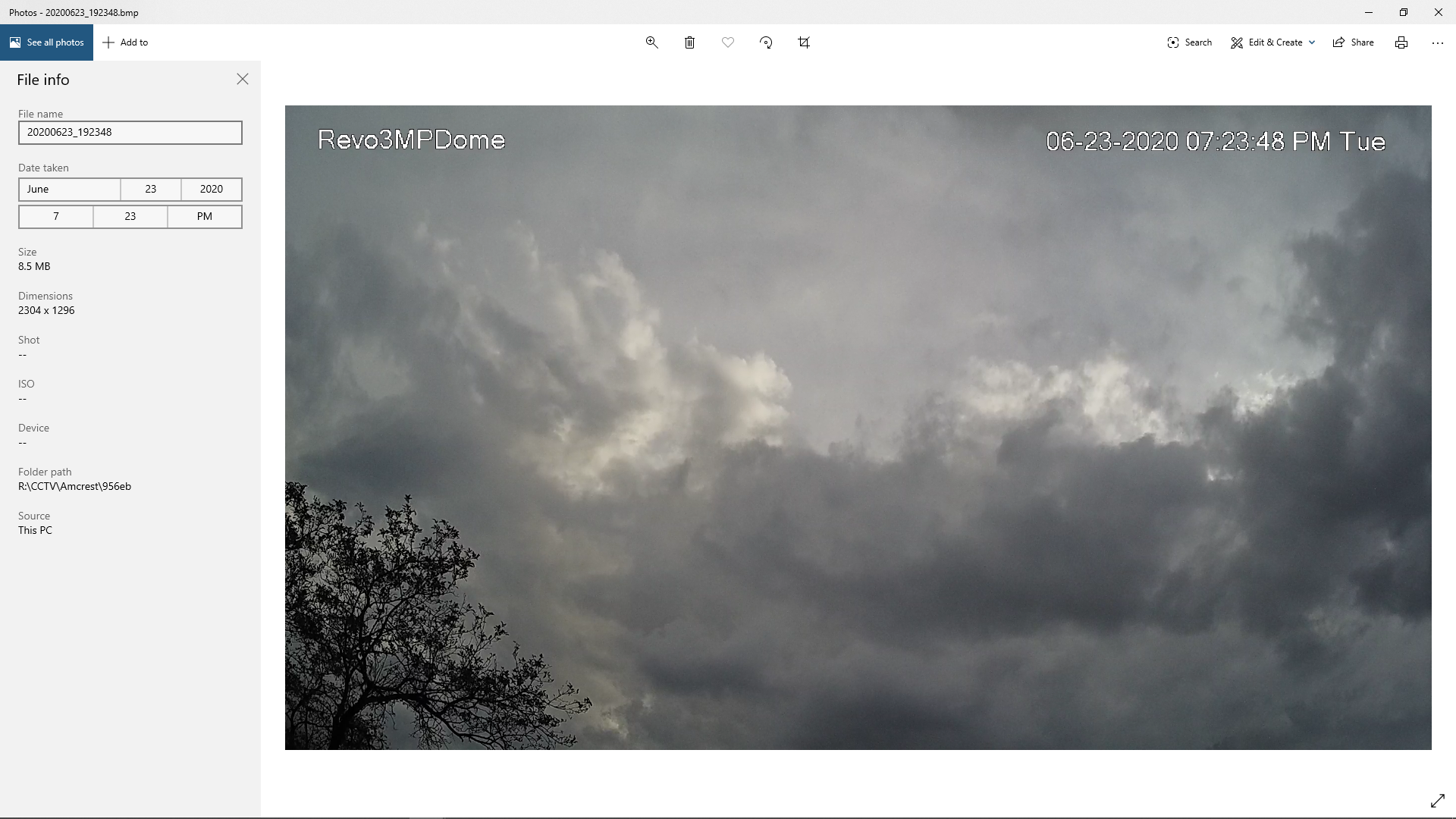

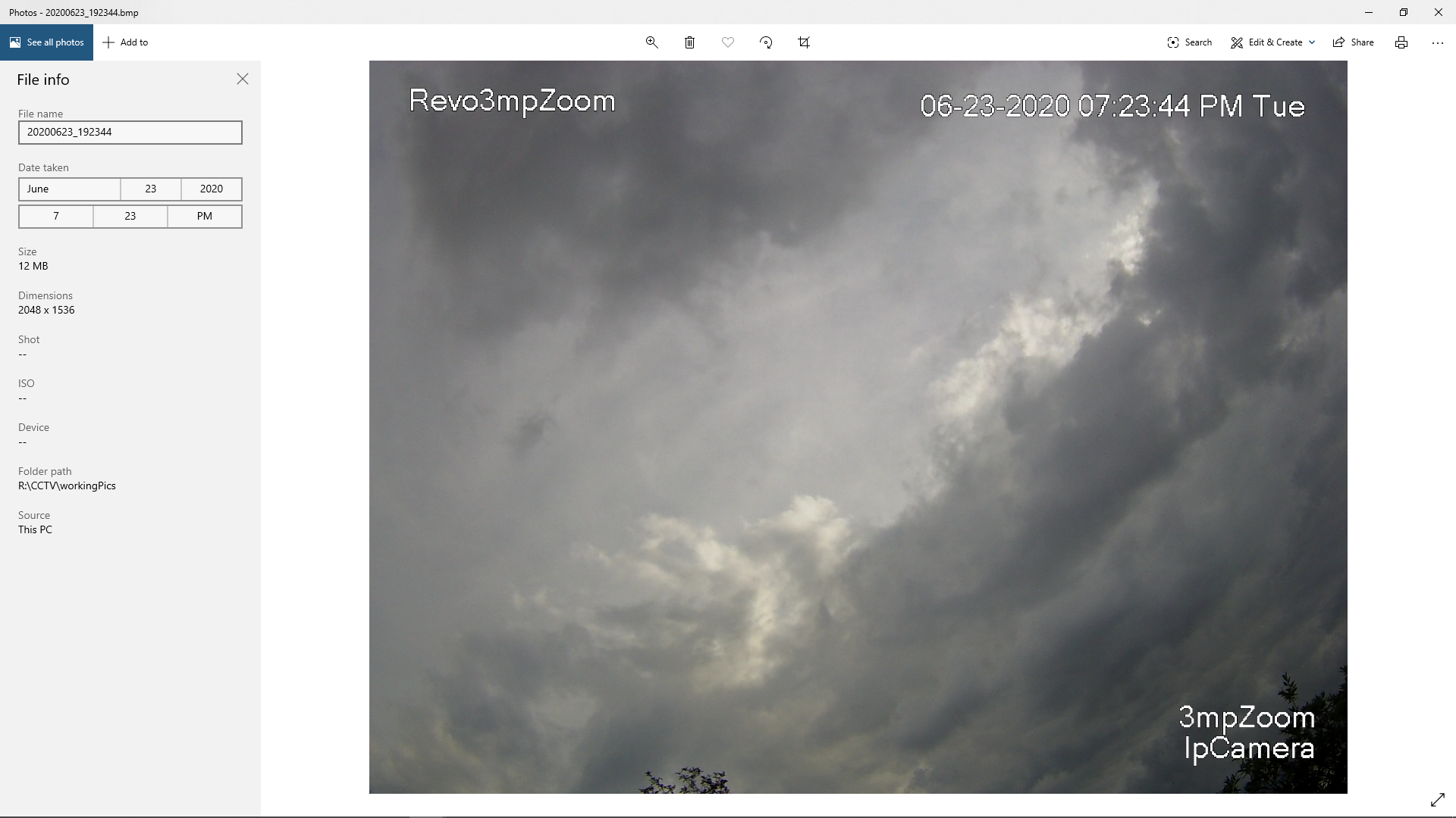

So one of my domes that is a 3mp Zoom or Motorized VF with auto focus to be fair I thought I would test with the Amcrest.. My other is a Dahua camera... 1 I find the Amcrest camera with better picture. I did a Snapshot over the camera WebUI and thought it was interesting.. One my Amcrest has wider and shorter picture and was 8.5megs the other 3mp camera was 12megs in size and is not as wide but much longer then the amcrest camera..
Picture with Zoom in the picture is the Dahua camera Revo3MPDome is the Amcrest camera.. Took these down today to install new Gel packs in them so I thought I would set them in same area sadly Dahua camera is facing higher then the Amcrest one and is slightly tilted.
I used the viewing software to view image info for the pictures to see image size and space used on the hdd in a capture to make this lower HDD space I did a screen capture of them..
In the End.. I like the Amcrest quality better.. I have thought about doing something that I expect no one todo but sadly there is no controls in the Amcrest MB for a Zoom lens or I would swap out lens because I like the ability to Zoom cameras...
Amcrest Camera as Listed

Dahua 3MP Zoom
