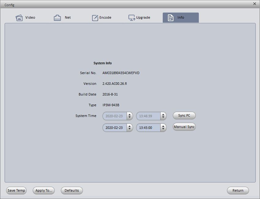

When I access setup through the web UI, the firmware version says 2.420.AC00.26.R, build : 2016-08-31. When I go to the firmware download page, the firmware update available is 2.400.AC02.15.R from 7/31/17. I would like to confirm that the 7/31/17 firmware update is more current than the one I have. The 2.400 of the update is a lower number than the 2.420 of the firmware I'm running. I just don't want to brick this when performing a firmware update, so if someone can confirm that 2.400 is more current than 2.420, I would appreciate it.

Thanks for your kind reply. I'm in the US, I bought this camera new from Amazon in 2017 and I didn't pay much attention to it at the time, but it was sold by CameraTec. I bought a second one that I haven't installed yet, but Amazon shows it was bought from Amcrest Direct. Curious. Maybe CameraTec altered it?
If I understand you right, what I'm reporting as the FW version is not for this camera. Con you confirm my understanding? I've attached a screenshot of the reported version.
The one you listed is for the US FW update... Again the 26.R follows the last 2 UPdates in UK
I apologize, but I don't know what that sentence means. Given that I've confirmed that I'm in the US, can you clarify your comment so that I can figure out my next steps?

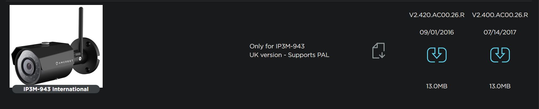

On the Amcrest Firmware Download website, it lists the firmware that I currently have on the camera and offers a newer version. What's odd is that the the firmware versions are exactly the same, the only difference is the date. This is for the international fw. See the screen cap below:
Since I bought a second 943 from Amazon a few months later and the "Seller" is listed as Amcrest Direct, I'm going to postulate that this is a US version. I haven't installed that second camera yet, so I think what I'll do is connect it up via Ethernet and find the Firmware version. That should tell me a lot.
I may just swap the cameras out and play with the firmware upgrade on the UK version while it's not actually mounted and on surveillance duty.
All in all, thanks for helping me sort this out.
Re: IP3M-943B Firmware Confusion
Yes that is another issue I have found they at times like to make changes to FW and keep the Numbers the same. (Just different dates). If I had to guess I would say that there was no major Change in the code so they kept it the same just date difference. While I do have some cameras that are Able to run in both modes I am going to guess they would provisioned to do so in the Chips that are onboard. It might be the NTSC for USA FW might work however if it don't offer the dual setup from the start it might not.. I would contact Amcrest to be safe before doing FW to USA version.. I have a Question in about it if I hear back I will let you know what I find!
