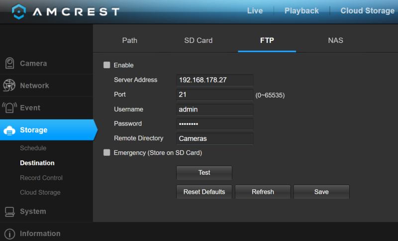

3) Menu item: Storage\Destination\FTP
Remote Directory What is the syntax for this parameter?
No matter what I enter here I always receive this error message:
“FTP server test failure; user read only right”.
But, no matter what I try to enter here there is no
way to make it work.
Yes, I know that this is an old shortcoming of the
IP3M-941B firmware, but should this not have been
resolved after all these years 😊 ????

3. FTP - I presume you've got WS-FTP client installed on a PC running 24/7. Is the computer really at 192.168.1.1 ? I would have thought that would more likely be your router/network gateway. Problems with FTP have been ongoing in various ways for years and at one time or another I've experienced them all (ridiculously long file structure, files being deleted, unable to connect etc. etc.) and have given up on it. In my case the FTP address was to the client running on my NAS. This is what my settings looked like when I last had FTP enabled. Each camera creates a sub folder for itself into which files are saved -
I have found that after setting the connection up, clicking the test button at first says that it could not connect but then clicking the test button again and again in quick succession finally comes back with a success. I can't work it out and have given up trying.

I found an old, outdated, DLink IP camera ( in my closet ) which I connected to my router, Asus AC51U router. I set up its FTP client to dump recordings to the router FTP server. Works beautifully !

I'm forced to take back what I said previously about failure to connect via ftp being down to my cameras. There's a new firmware version that's just come out for my WD MyCloudMirror NAS and I've installed it. Having done that I logged into my cameras and set each one up to save snapshots to my NAS using ftp. Worked perfectly first time on each camera as did the test button.
