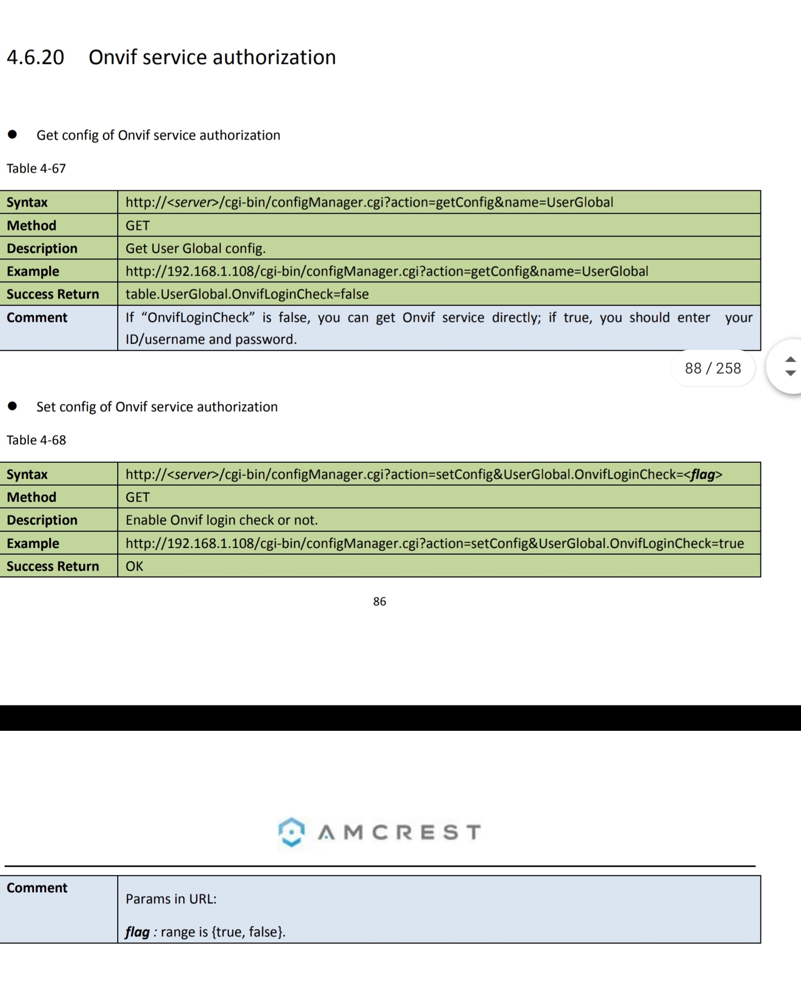

Use the API commands below to get ONVIF Authorization for a non-admin ID.  I tried it with an IP4M-1026 and it worked. I used APIs in a browser.
Screenshot_20210712-144204_Google PDF Viewer.jpg (492.53 KiB) Viewed 6561 times
Re: IP3M-941B ONVIF and User Management
Interesting, I tried it in my 941 and I tried it in the 841V3 and both of them gave Errors. Oddly the 941's error came back as
Error
Error ID=2, Detail=Invalid Request!
