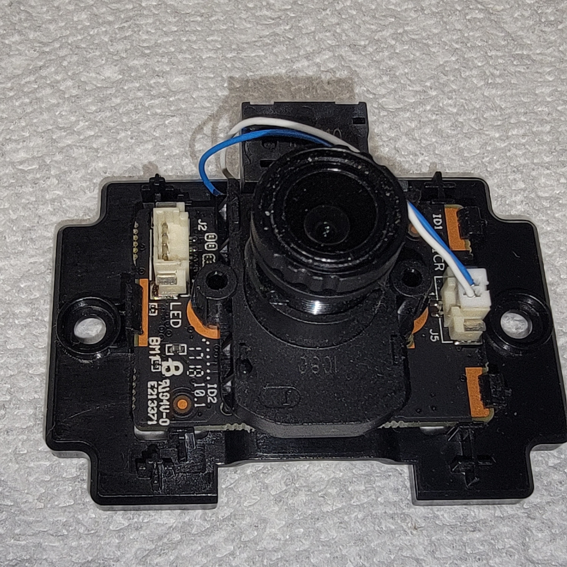

Can you post a picture of what the camera can see and I might be able to tell you what it is. Picture below is of a Camera off the 841EB with lens and IRC mounted to camera. Please note that taking the camera apart to this point will take some time. The hardest part is taking the head apart to get access to the camera board, lens and IRC...

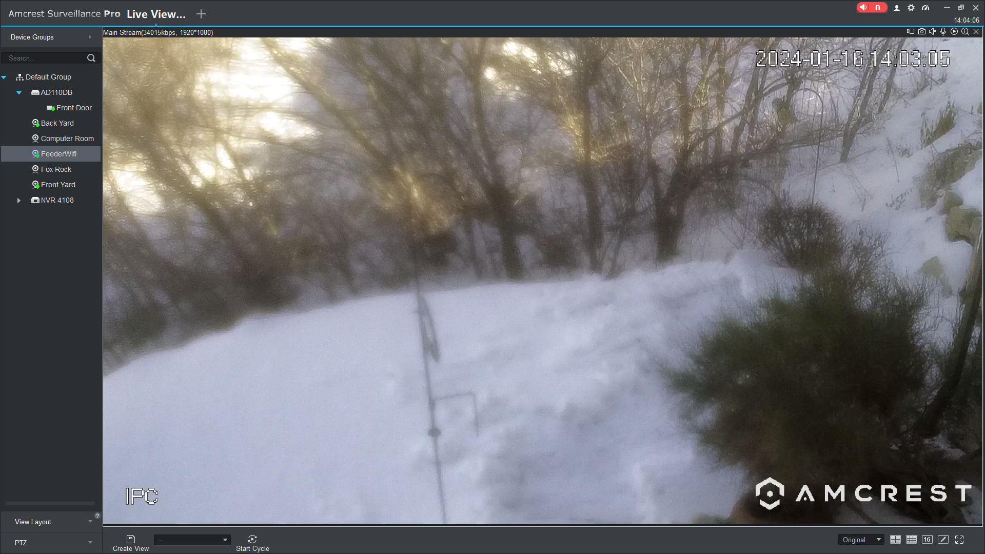

I have a .png file of the blurry video, but I forget how to add it to a post.
Re: IP3M-941B Has Blurry Video
So looking at the Picture my guess is that the camera is in a Very Cold and Damp location that it wasn't built for. One of a couple of things could have happened to cause this. First drifting snow has made it onto the camera body and as the heat of the camera removes the snow it caused humidity to enter the camera lens and is sitting on the inside of the camera lens. (Removing the lens can be done however damage will happen if system isn't removed) that is because the Lens is threaded into the IRC frame and then it is plastic welded between the frame and lens threads.
Another thing that might clear this up is taking the camera from the cold area and adding it into a Humidity Controlled area. If you own a Dehumidifier I would put it in the room with one and make sure that the lens is facing so droplets can't fall on the camera sensor
Worse case, You will need to buy a new lens, This might be problematic, Just need to find one that will fit the mount as long as the lens can be removed from mount without damaging it. If it can't then you will need to buy a IRC lens mount and 3mp lens that fits your needs. don't remember but I think the lens in the 941 is a 4mm lens. Biggest issue is that it will need to be installed and adjusted for a clear focus and then best to make it stay once you get it to focus.

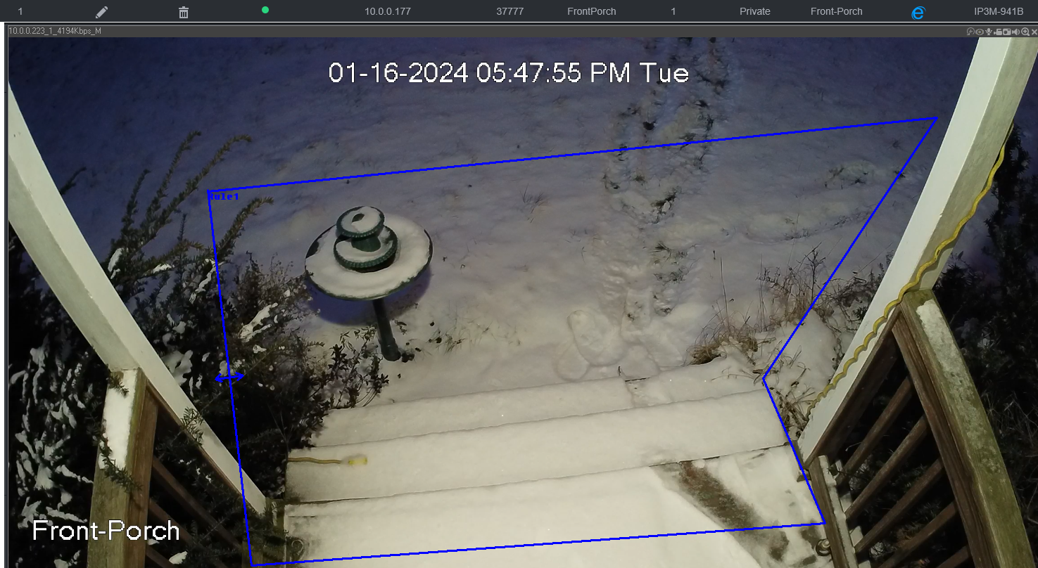

Also I am not judging anyone that uses any camera in an area where it wasn't designed to be. Here is my 941 that I have connected to my 4216E-AI NVR and using one of the built in AI channels on that for an Intrusion zone. That isn't in the camera that is a feature from my NVR.. I have this camera on my front porch that is under cover and up high so it don't get much if any snow drift..
