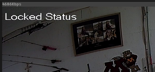

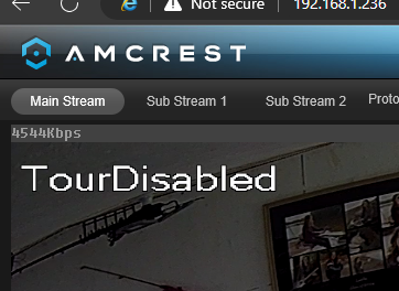

I have an IP2M-866EW camera that has worked great for just under a year. The camera has been setup with a PTZ tour that has run without fail for that time. However, just recently, the camera will not run the tour anymore. I have logged into it, and it will go the PTZ presets just fine. However, when I attempt to run the tour, the live video feed displays "Locked Status", and then "TourDisabled".
I reached out to support, and they told me to factory reset and to ensure I'm on newest firmware. I am on newest firmware, so I did a factory reset, and re-setup the camera. I still have the issue, however. I have asked support for an update but now they have gone silent...

IP2m-866EW PTZ Locked Status Disabled Tour
- Screenshot 2024-07-20 150748.png (95.46 KiB) Viewed 80167 times
- Screenshot 2024-07-20 150733.png (177.03 KiB) Viewed 80167 times

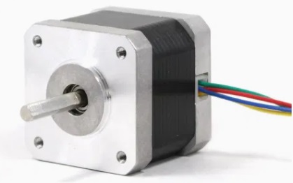

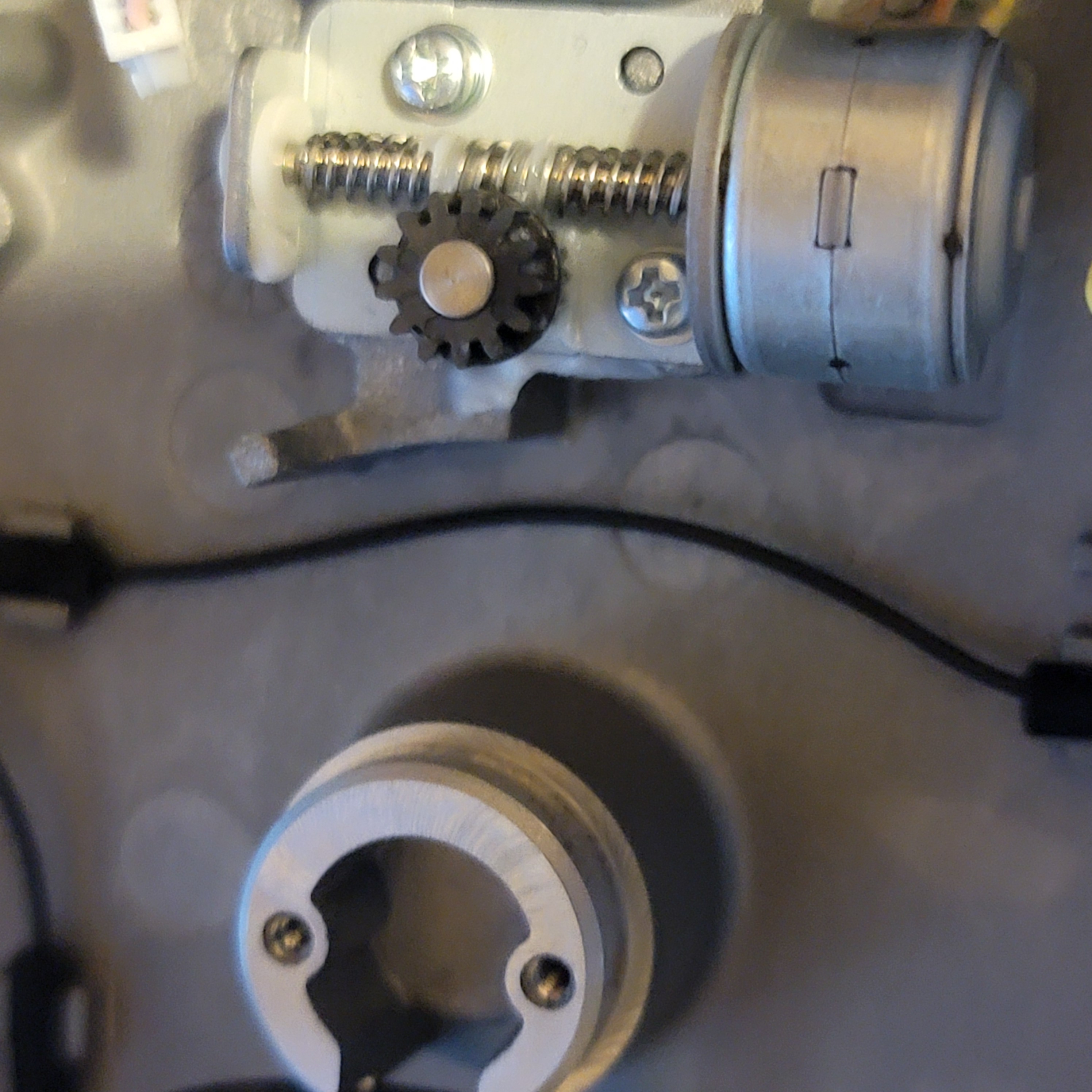

My guess is that you might be better off making a Ticket on your Camera. My guess is that you said it was under a 1 year old and maybe if they don't have a corrective Firmware yet for the issue as another Forum member pointed out about this camera after only owning it for about 4 to 6 months. That the action would be to RMA it and you would end up with a new camera.. Then until a Solution of a NEW FW if one was to ever come about. Don't use Tour for a full time function of the camera.. Remember while this is a PTZ camera it isn't at the same cost or with the same Higher quality hardware that is found in a camera like other full sized PTZ from Amcrest..
Picture of like kind camera. Because of the size have to use compact DC motor Picture of a Real Stepper motor used in full sized PTZ cameras dating back many years. Even the same type used in my 1995 PTZ from years past..

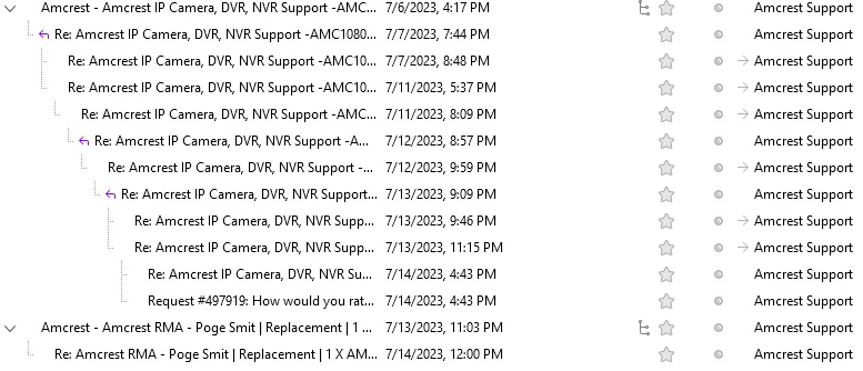

That's what one would think, but it is not what I was told after going through all of the below just to GET to the RMA group.
I was told that if the camera could not be repaired it would then be replaced. Shipping on my dime both ways -- for a $29.00 analog HDCVI camera. How absolutely ridiculous. Anyone else would have just replaced the camera after the first or second email and been done with it on a customer relations basis alone. Not Amcrest.
Needless to say I blew them off and haven't bought another Amcrest product since.
