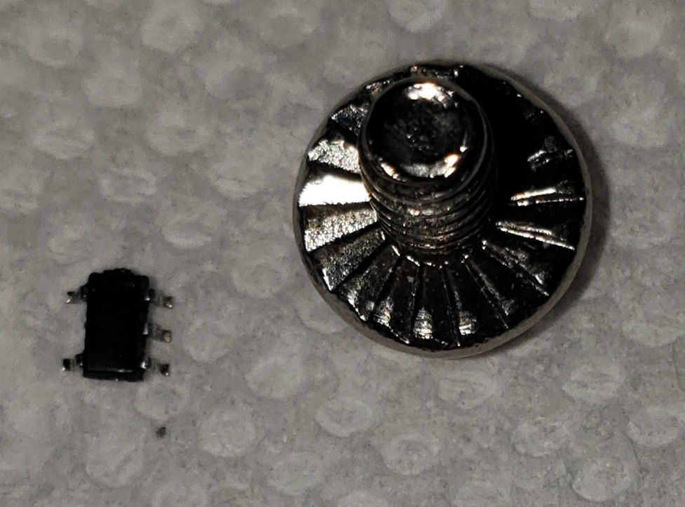

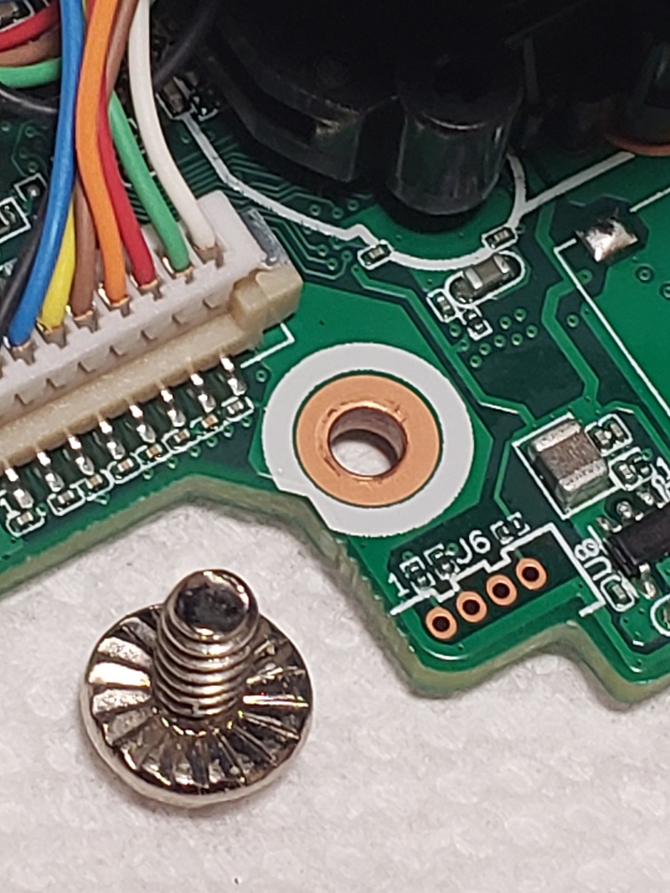

This is a different camera. However it is a bullet 4mp zoom camera POE that has died. Sadly this one is bad at a Voltage Regulator or one of the caps around it. Sadly don't know right now as I made a mistake and just blew up my ESR meter lol. Phone calls and Electronics can be bad combo. Thought I removed power when phone rang but didn't and testing these things when there is voltage on them isn't good for my ESR meter. Hope its just a fuse. Anyway still doing some testing but thought I would take picture show what kind of sizes someone has to work with even in a POE Dome most everyone know size of normal HDD screw that is in picture to help show size right click picture show in New tab for larger picture when I get to computer I will resize and post smaller image but for now. Also those wires showing are for zoom lens

OK Well I reduced the size of that image now and re uploaded it.. Issue was I sent it when I was away from my computer from my phone and so it was full size off the phone..
Today took a picture of the Defective part Next to the Screw alone and sadly now I will have to do some work to find a Replacement for it. Seeing there is no DOCS that I can find for the Marking on the part. So there is a large data base of parts from like Ti and Mouser to name a couple however that part could be a LDO or a NPN and without having a idea really I am guessing on parts around it that it is a LDO however replacing it with any random one will not work long if at all.. So when working in this field one could have donner boards for testing and being able to take a part off one board to put on another however that sadly isn't always a safe bet.. That is kind of good for making Repairs to laptops or things that have soldered in Drives and you want your data removed and cell phones however something like this a NEW part is better in the long run because CCTV cameras are running full time 24/7 so best to have new... Now I wait maybe find someone with same camera, Have them take apart and take Measurements when powered on so I know what I am working with and can find a replacement.. For now I have to wait for a part. Lucky for me this is my Camera so there is not a Large push for fixing this..
Anyway just wanted to show the size and yes I know this is the bad part because now that it is removed the Short to Ground that was on the cameras board is gone. However the camera needs to have this part for it to work so it isn't working at this point yet..
