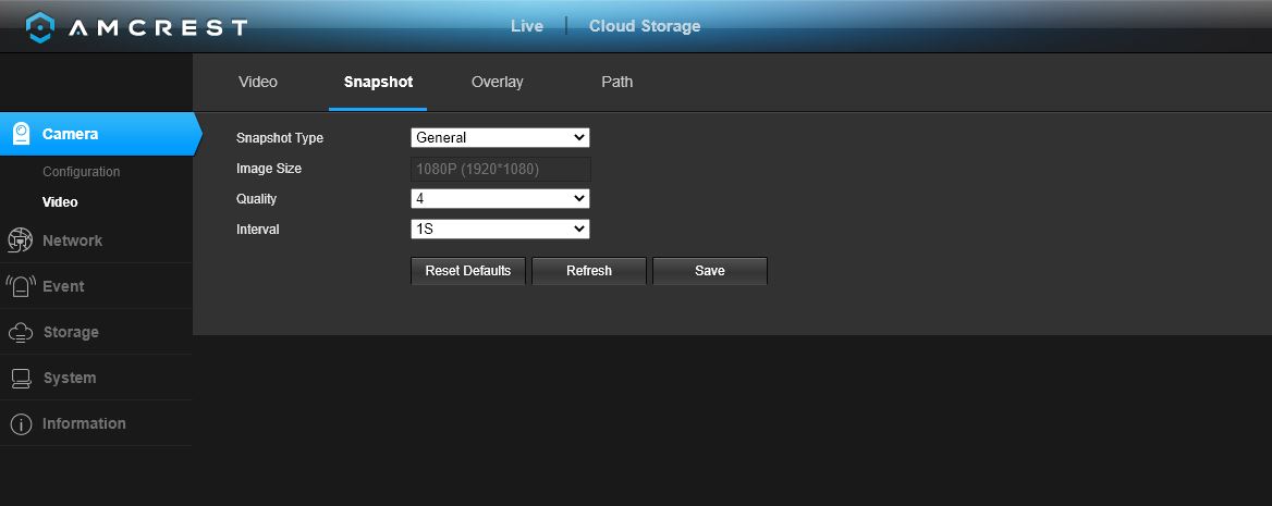

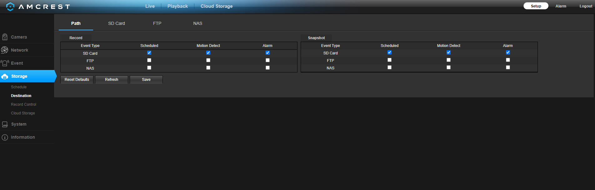

My settings are attached on the images attached. At the SMTP setting attachment is checked.

3 things I can think of.. 1 Under your Storage you will want to make sure that Snap shots are setup for the camera if they are not setup on aka turned on they will not send a one because the storage device was not setup to take a picture even though you have setup under Motion in your picture...

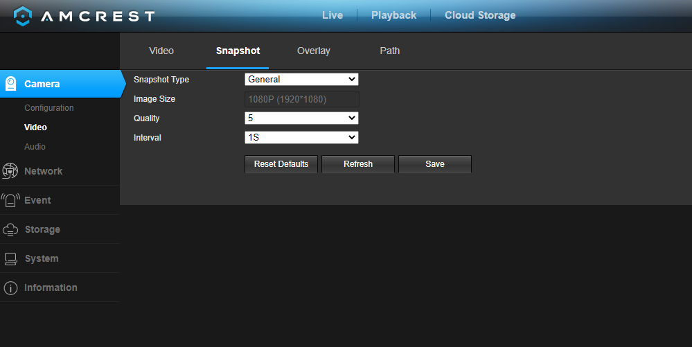

Second try and reduce the Quality of the photo in the image setup it will say like 5 or 6 as top 2 highest quality try it set to 4

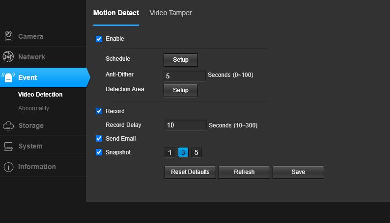

1. Snapshot set up as seen on the screencapture ... I am NOT sure on what you mean by storage set up
2. Reduced image quality to 1. Tried 3, 2 and 1

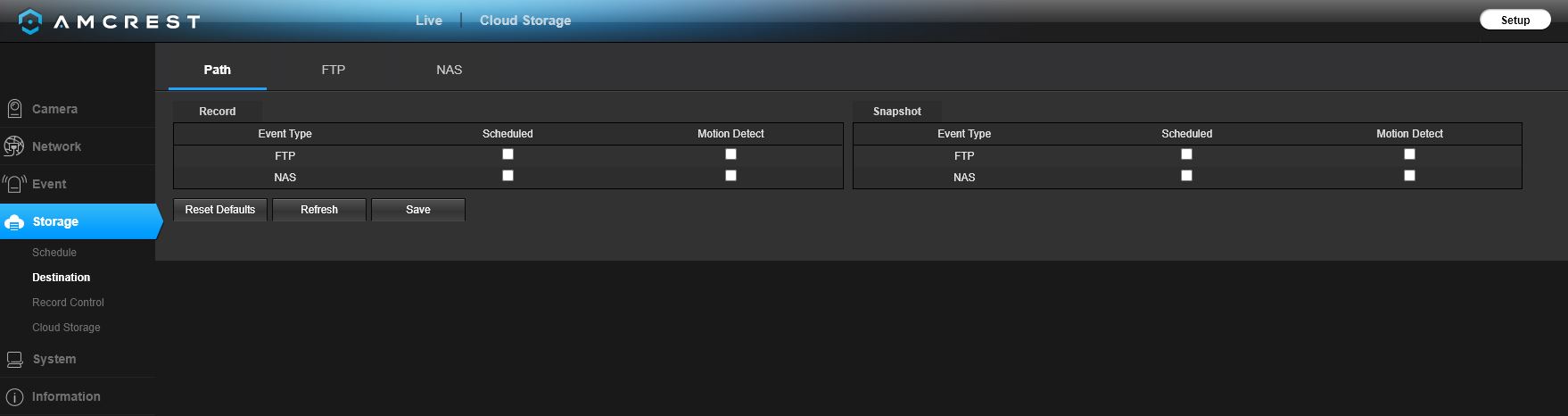

- ip2m-4.JPG (41.19 KiB) Viewed 1309 times
- ip2m-3.JPG (57.14 KiB) Viewed 1309 times
Re: IP2M-852E no email attachment
Sadly I might be wrong and this might be one of the cameras don't don't support a MSD slot for local camera storage and as such might be why there is no image pulling..
I know that if I have a camera on newer FW 2019 and 2020 if storage isn't installed I don't get any images because that is where the image is stored.. Maybe and I say maybe if it was connected to a FTP server for event storage it might work.. I have some other OLDER IP cameras that don't have any MSD slot but thought it was just because it was told old of cameras..
