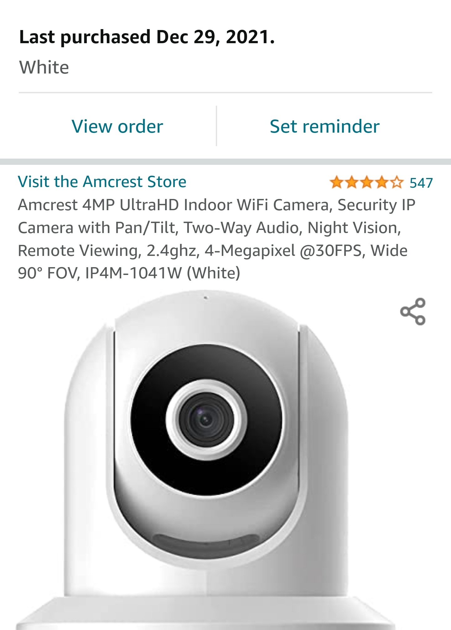

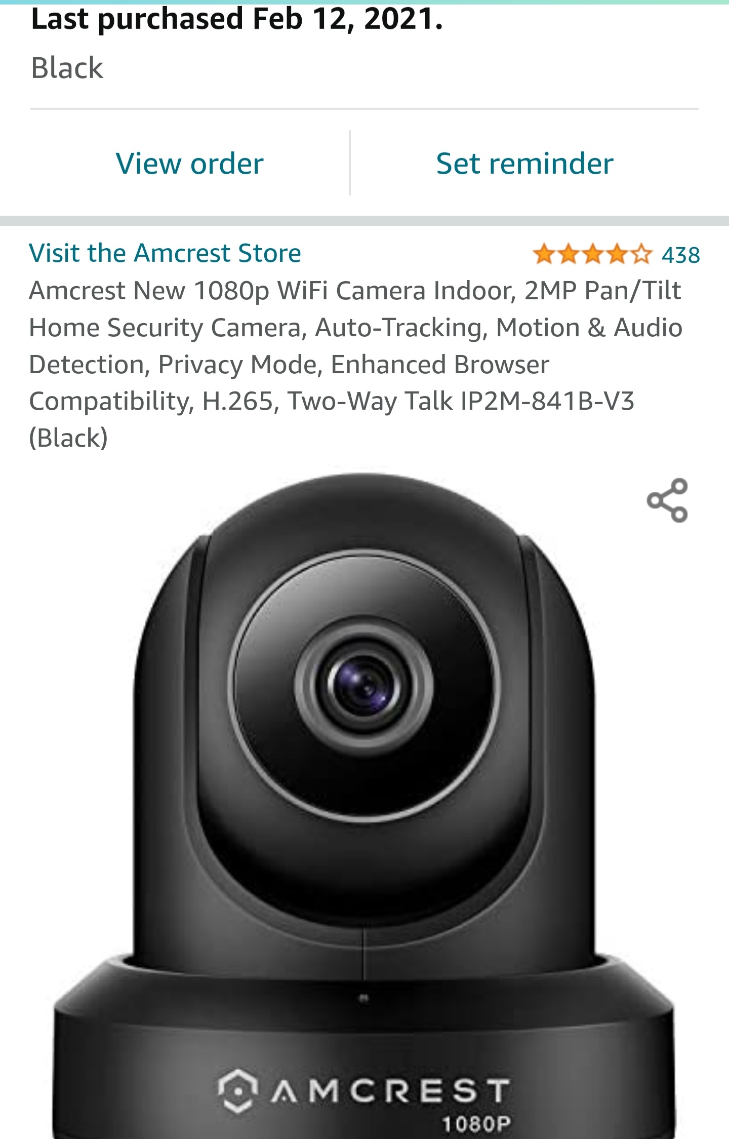

Does alp the above pertain to all versions of this camera?
- Screenshot_20220228-081957_Amazon Shopping.jpg (258.35 KiB) Viewed 1482 times
- Screenshot_20220228-082028_Amazon Shopping.jpg (312.8 KiB) Viewed 1482 times
