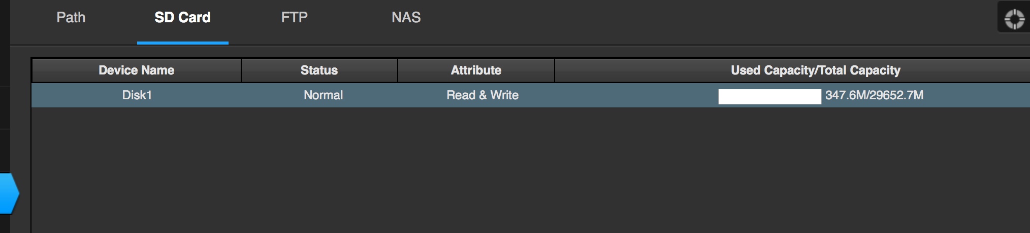

In the camera's configuration page. the Target is set to the SD card and it shows status normal, under available space it shows 0.1M/29652.7M, attributes read & wright Under the storage option record schedule has the yellow and red lines all across every day and holiday.

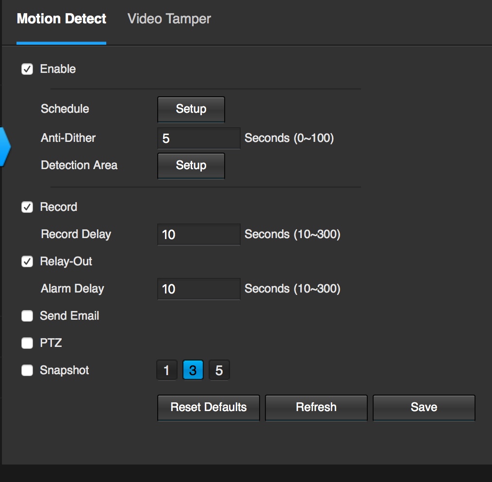

Please observe if the used space on the camera is increasing which indicate that its recording. if it does, you can try accessing from a different browser to see if that works.

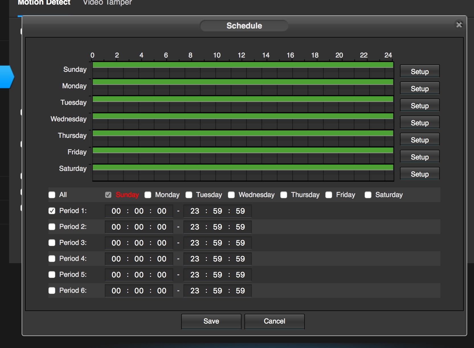

Also Ensure the the video detect is enabled and the schedule for motion is set under video detect. The 'Record' check box should be enabled as well.

Ok. It's been proven. today is the second time that the SD card starts recording as soon as the cloud recording schedule stops. I'm attaching the settings that you recommended to check.
