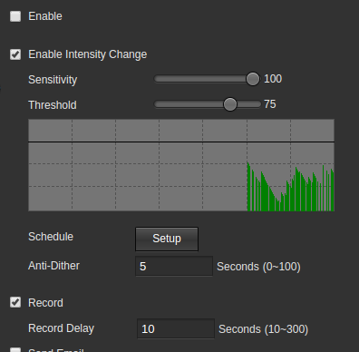

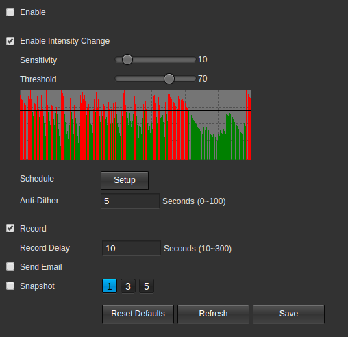

On the camera/audio setup page lower the mic volume to 90 It doesn't take much sensitivity off, but it fixes the false audio detection issue. Then i set the audio detection sensitivity to 100 and the threshold to 75 on my indoor camera. If this is an outdoor camera wind and crap may set it off a lot. I know this was an old post, but its the one that came up when i googled. My camera is also a IP8M-T2499
this is after lowering the mic volume from 100 to 90
This is before lowering the mic volume. It would randomly be sending me alerts even with almost no sound in the room.
