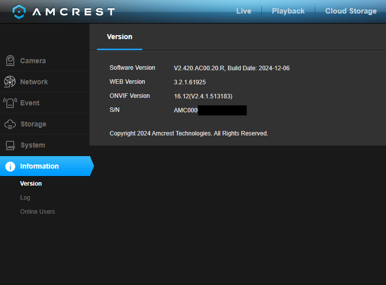

Well I can confirm that the 841 dated 2024 did install on one of my 841 normal cameras.. Kind of dumb that after 4 years still not supported in IE it still has to be used in Chrome or Edge normal.. All my other cameras that were bought way after all the 841 line still work and work better in IE mode then in Chrome or Edge.. But oh well.
Screenshot (4144).png (50.14 KiB) Viewed 2578 times
