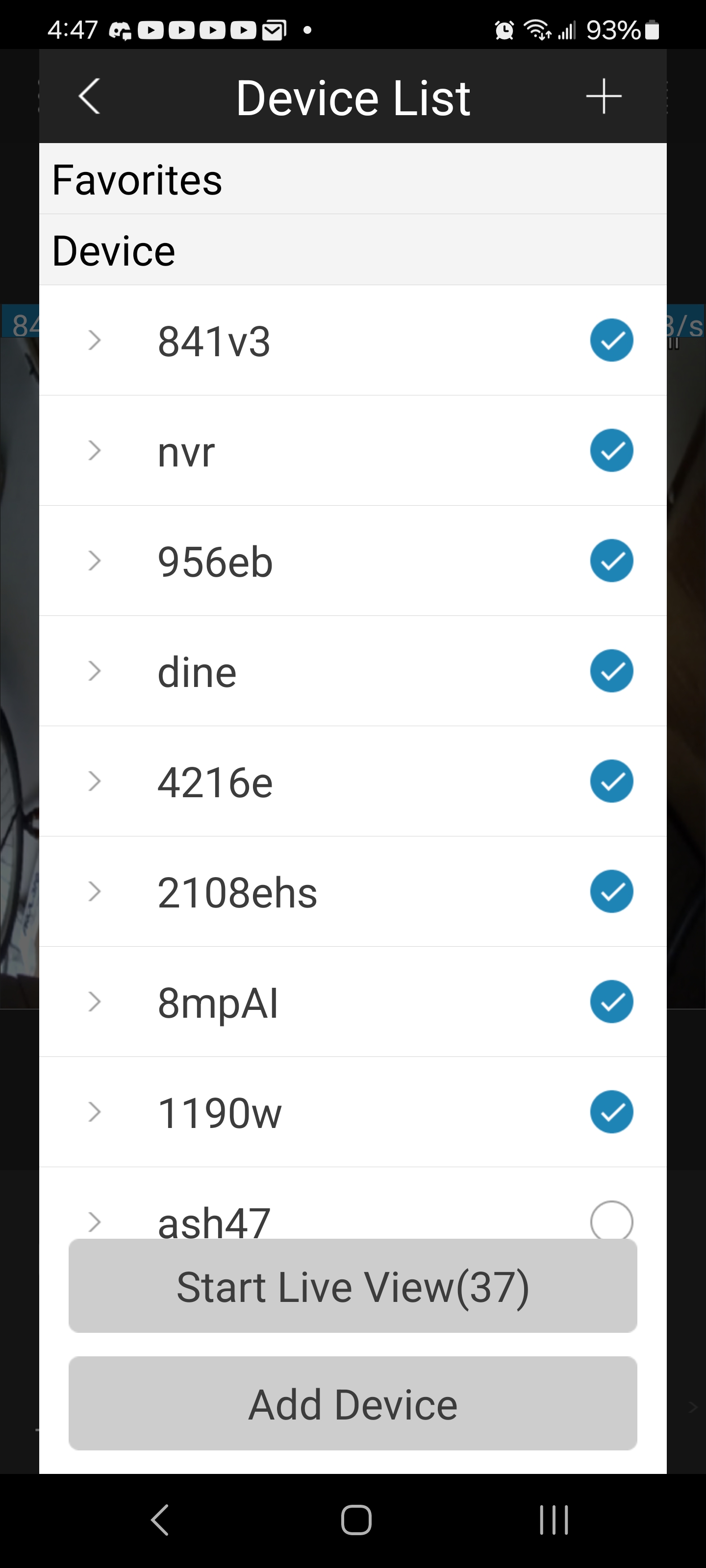

Not sure I understand. First, Have you been able to log into both of them on your local network over WebUI?
Second when you try using the app are you sure that you clicked on both of the cameras to access them both. In the top right Icon it will show a Green dot on the ones you have picked to view. Anyway see my picture below. I checked a bunch of mine, then pressing live view will view them all, Moving right and left to go between them. If trying to change view type from single to multi view again if more then a few added then again moving to right or left will add in the cameras to what ever view you have picked. If you want to go back to single view you will have to click on 1 of the cameras in the current view. then again right and left to cycle through them.
Maybe show a Picture of what you are talking about for better understanding if this wasn't the issue?
Screenshot_20240308_164739_Amcrest View Pro.jpg (357.36 KiB) Viewed 1883 times
