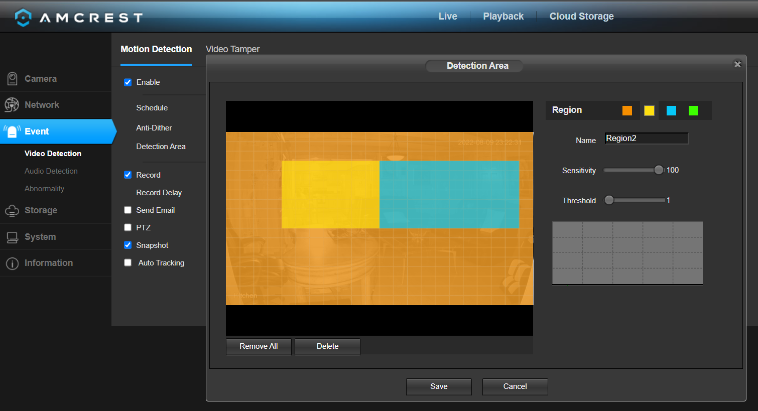

Having problems getting motion detection working at night under the camera's IR lighting.
I have the following set up in the video detection screen:
I don't see anywhere for IR settings. Yet when the room is completely dark and the IR light from the camera is ON, I can see the person walking around in the dark (like a ghost) but the movement detection never triggers. They can walk right in from of the camera only 5 feet away across the entire field of view and nothing triggers. There are no Red spikes on the above screen showing movement detected either.

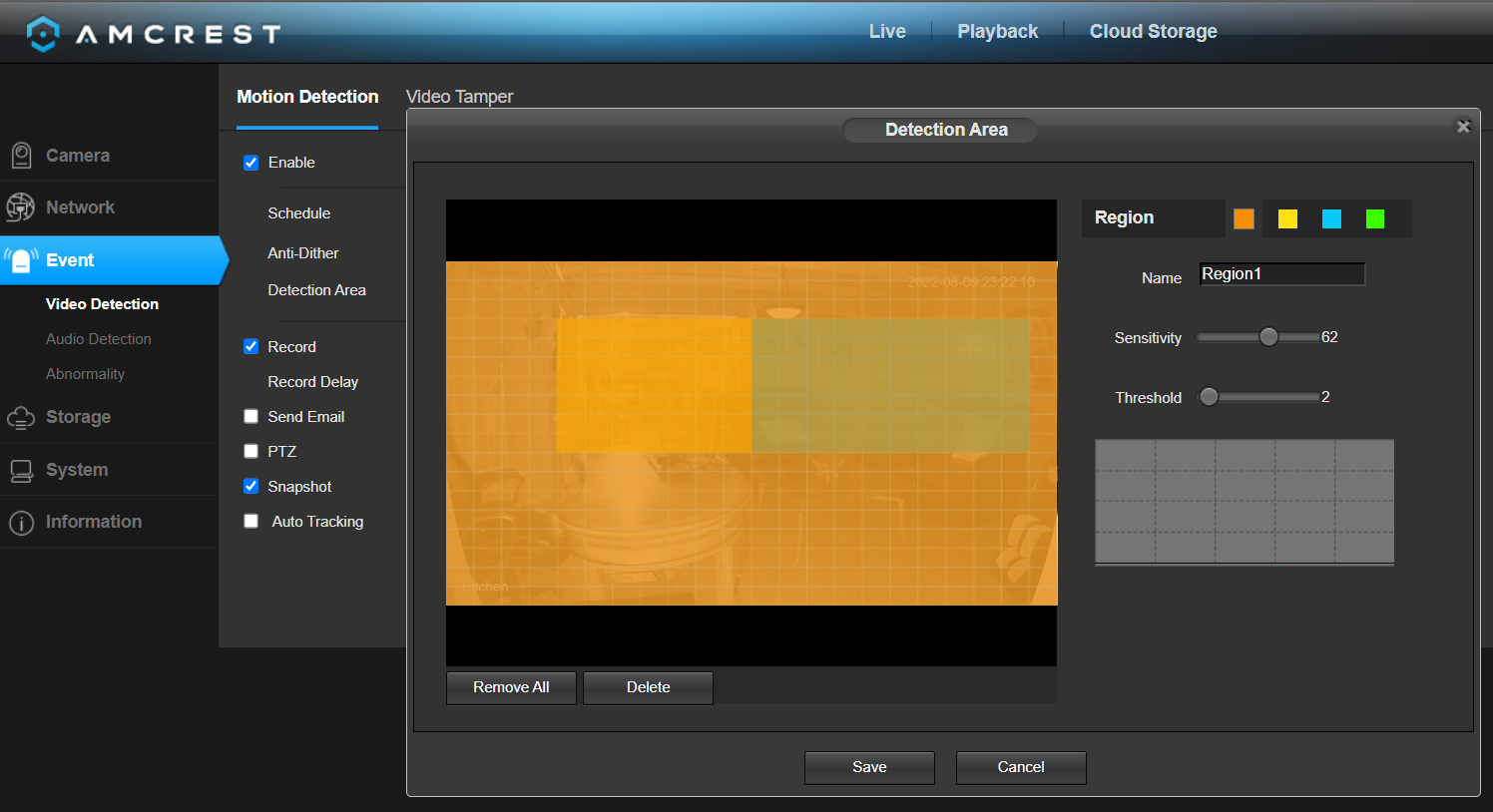

The first image in my post you can see the Orange block is selected and set to 62 &2
The second image has the Yellow block selected and set to 100 & 1 - this is the farthest away and was not trigging with the defaults even when fully lit. I set it to these values so it would trigger when that are was fully lit.
The third image has the Blue block selected and set to 82 & 2 and is a mid-range area that didn't always trigger with the defaults when fully lit.
When movement is detected, you will see red spikes in the gray grid. If those spikes rise above the black trigger line, then motion is detected and a recording will be made. The red spikes never appeared on any of the colored detection areas at night with the built-in IR lights on.

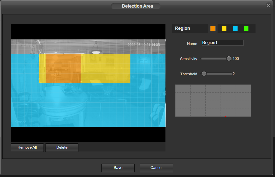

Ok. It appears to be working good now. Here are the things that I found:
1) Don't overlap the Regions. This seems to negate all detection
2) The smaller the Region, the better the sensitivity. A small region at 100 Sensitivity will trigger whereas a region of the entire area at 100 Sensitivity will not trigger for the same motion.
This seems to work in daylight and nighttime IR.
I'll let this run for a day and report any updates.
Thanks!
dahai8
Posts: 51
Joined: Tue Jan 04, 2022 6:39 am
Re: IP2M-841B-V3 IR Motion Detection Problems
Post by dahai8 »
Here's a grab of my setup. All the regions have similar settings: 100 & 2.
But the larger the region, as in blue, the less overall sensitive it is to movement. That is why the Orange are is very small. It is far away and so any movement is small. The smaller region triggers whereas if the entire area was Orange at 100/2, it would never trigger for small (or far away movement). This is the same for the Yellow area. But because it is closer, it can be larger and still trigger. Then the blue area is both closer to the camera and less important for detection.
