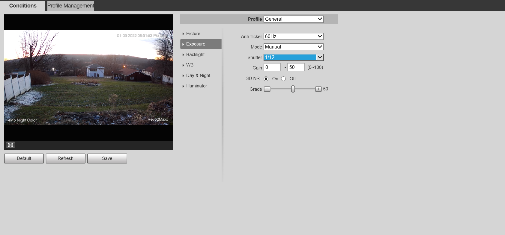

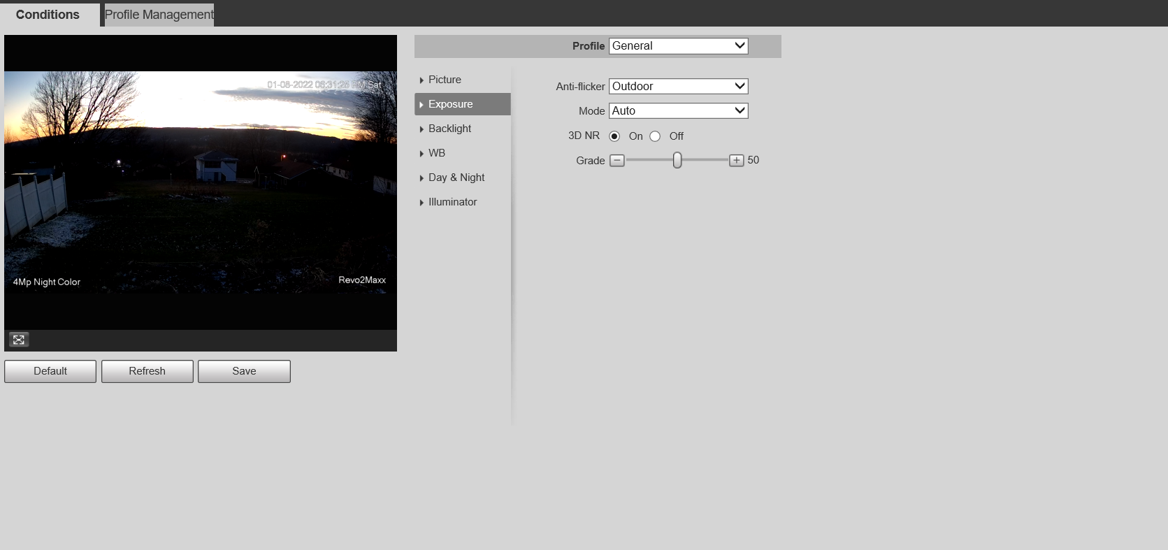

So I thought I would some some camera views, This is a Dahua Camera but has the same type settings and things when it comes to the cameras General, Full time, Schedule and Day/Night info.. This is a Great time of day where I have a camera that would benefit from using some type of adjustments in the settings.. Please note this is nothing more then screen shots I have not darken or changed anything inside of a Photo Editor all this changes was done from the WebUI of the camera.. I am showing what the General Auto setup would look like, What changing some settings make the scene look like and what the setting in Auto most likely is. While there are many more settings that I could change this is just in the range of the cameras
Also just to be clear the full sized images were over 3megs so I did reduce them in size by 60% and saved them to a jpg outside of that and what I put above there was no changes to the image..
Normal setting from reset
Screenshot (1762).png (269.92 KiB) Viewed 546 times
larger view of above

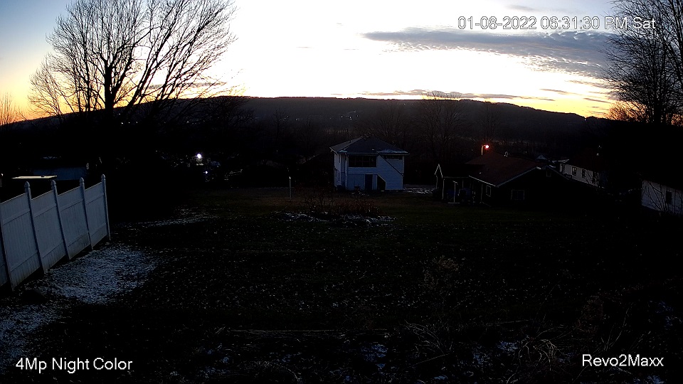

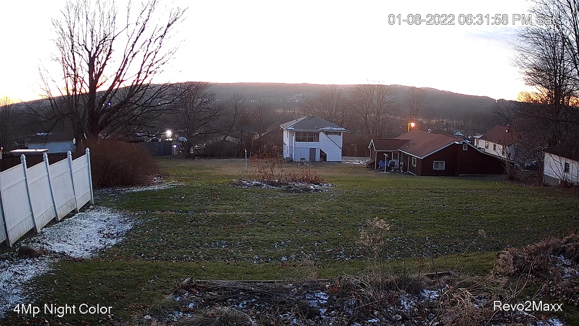

after an adjustment
Screenshot (1764).png (363.42 KiB) Viewed 546 times
larger view of above picture
Screenshot (1765).jpg (387.95 KiB) Viewed 546 times

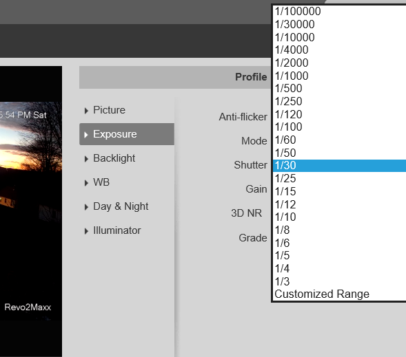

All the different options in that area of adjustments
Screenshot (1768).png (53.43 KiB) Viewed 546 times
