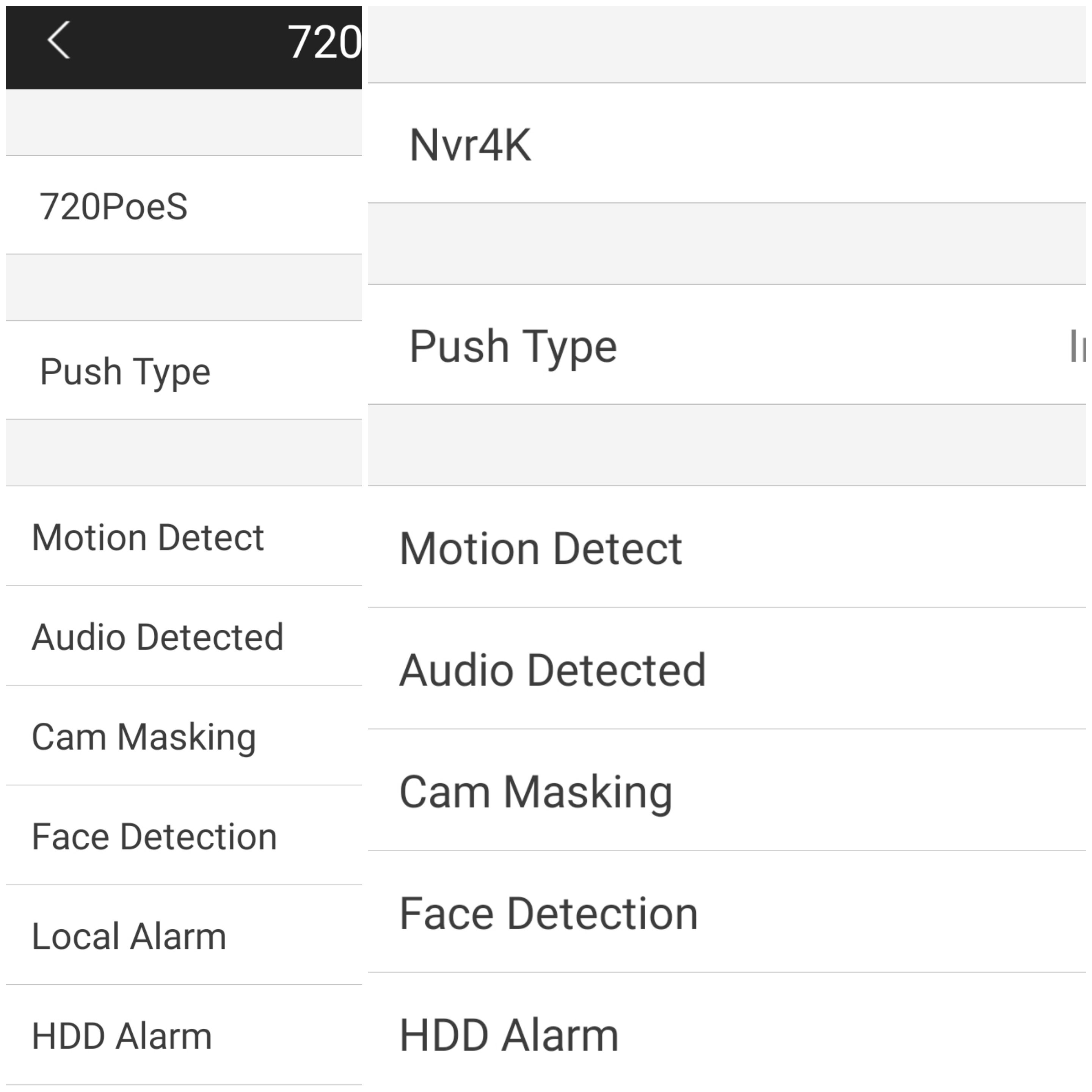

That is also part of Push Notices there is a lot that it will tell you not just motion...
Anyway just an idea thought I would offer a solution that is fast and no one would have a standing point that could be hacked or tracked like if someone got a hold of your email address now all the pictures or video clips are in their hands..
Anyway I mostly use my NVR seeing it has a lot of my cameras in it already but I wanted to show you that you have HDD aka SD info in cameras P2P push as well.. So I took 2 clips from my phone to save space I added them to 1 image on the left a small area it is my POE721 camera you can see it is same info as my NVR.. SO just showing that both cam push same but my POE721 also has alarms because my NVR don't offer that it isn't in its lineup...
