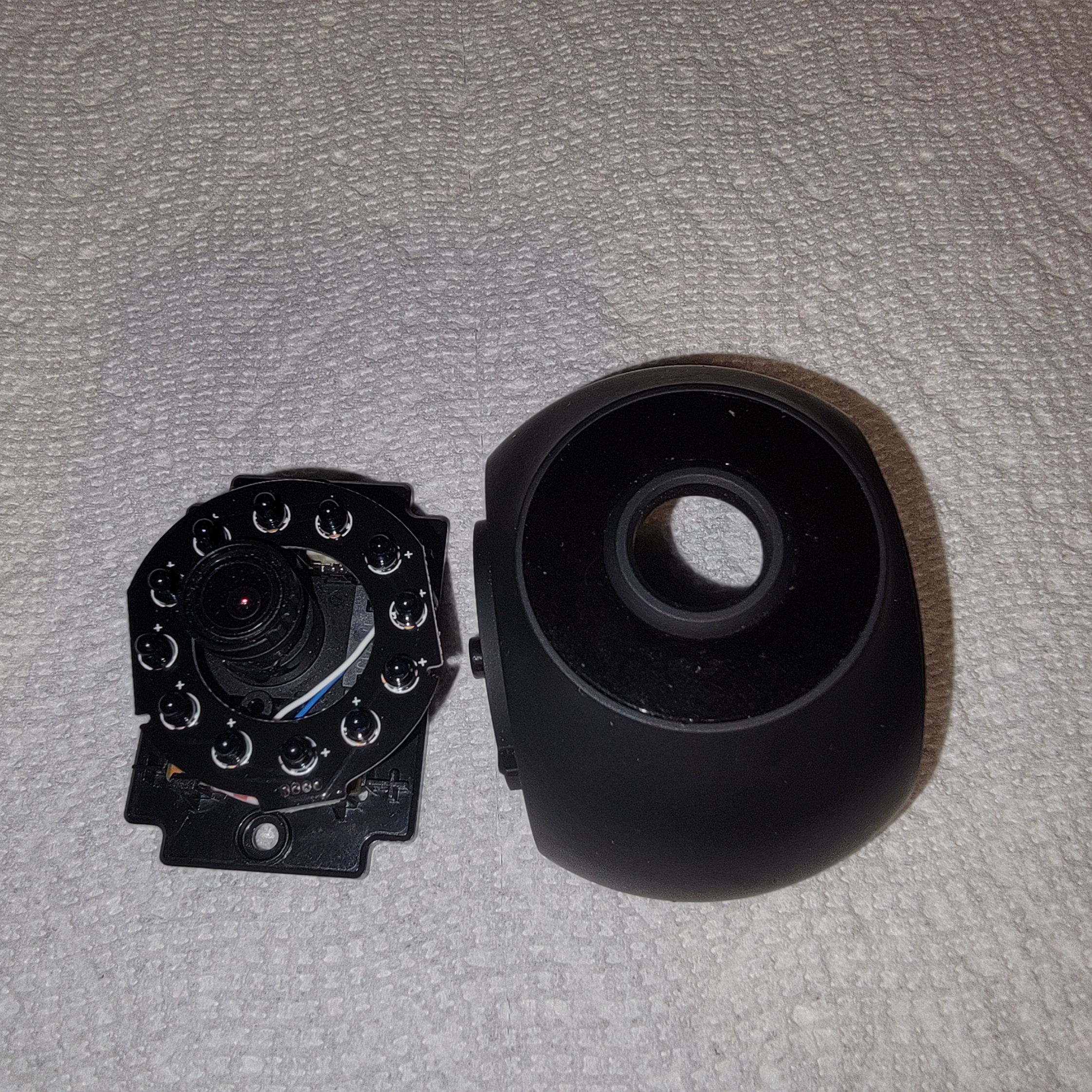

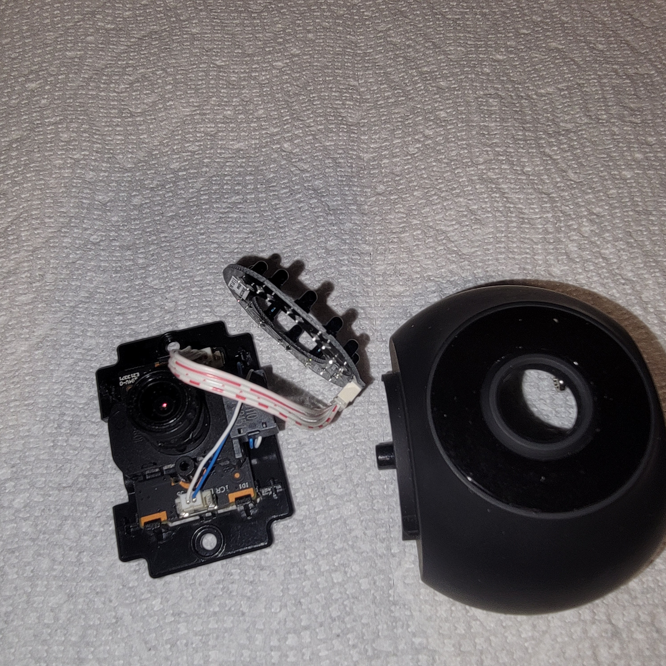

However if in fact your camera is damaged and the IR circuit has gone bad or maybe there was damage to the wiring between the Camera Board and IR board either way it will be a very hard repair. Not because the circuit is hard to work, Because of the time it will take to get to the circuit. You see the camera board and IR board are in the Ball of the camera. To get to the ball you have to take the whole camera apart, There is a point in the camera where it will almost always result in damage because of the tight fitting build the camera was designed. I included some pictures of an 841 with IR board on the camera board and one with the IR board off the lens to see the camera board where the IR connects..
