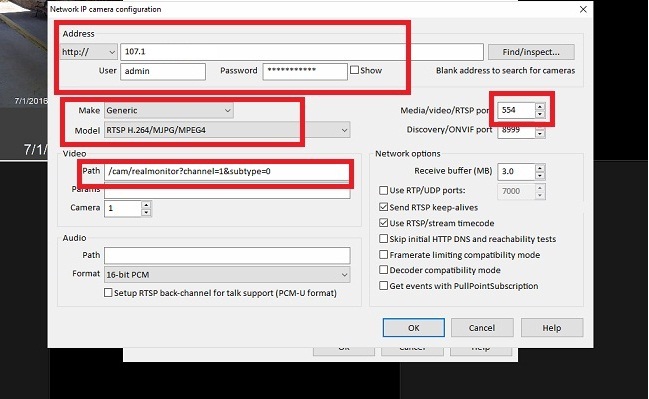

Please follow the below steps.
Step 1: Right click on an empty space on the Blueiris video display interface and select "Add new camera"
Step 2: Select the option IP/Network Device
Step 3: Enter the full address of the system into the "http://" field at the top including the port number if it has a custom HTTP port assigned.
Step 4. Select Make as "Generic" and Model as "RTSP H.264/MJPG/MJPEG4"
Step 5: Copy and paste this address to the Path field: /cam/realmonitor?channel=1&subtype=0
Step 6: Make sure the RTSP port of the device is correctly mentioned in the "Media/video/RTSP port". If the customer wants to add the system from remote location make sure the HTTP and the RTSP ports are port forwarded on the router correctly.
Please check the attached image.

Thank you Melvin for this. It did the trick.
