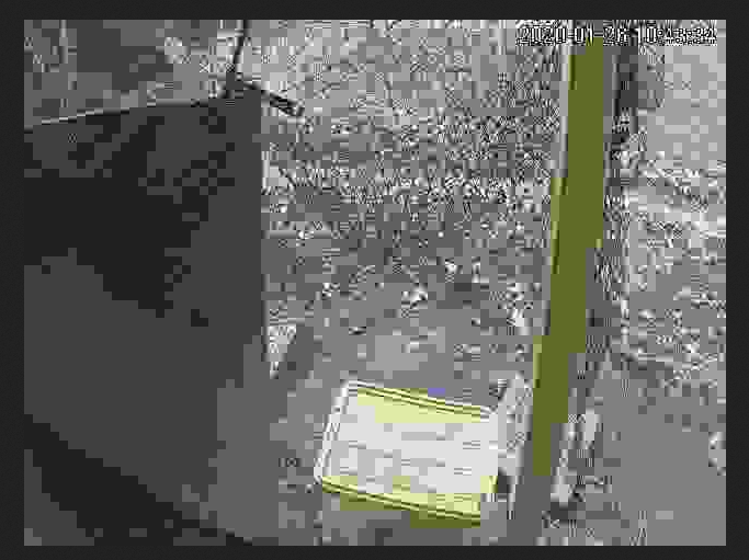

I just updated fw of my IP2M-841 to latest version
'Amcrest_IPC-AWXX_Eng_NP_AMCREST_V2.420.AC00.18.R.20191218.bin'
I was hoping for a more stable URL streaming, but the old issue with blurry stream is still existing.
Using following URL: http://IP:port/cgi-bin/mjpg/video.cgi?channel=0&subtype=1
Gives me a video which will turn blurry within a couple of seconds.
Any advice on how to get a stable URL video stream?

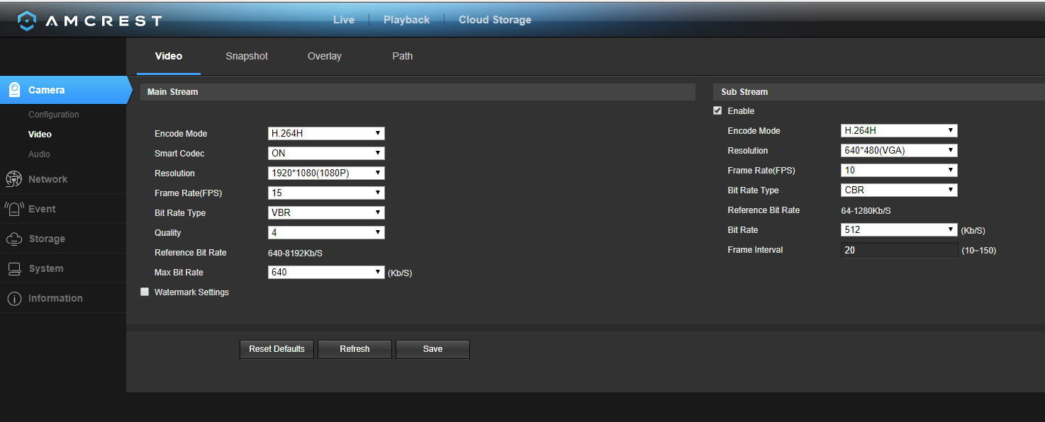

(I've exceeded the editing timeout) p.s. - It seems to me to be a bandwidth issue. I just tried it on one of my cameras and got the same result as yours. By adjusting the sub stream settings (lowering frame rate to 5 fps) it was resolved. Personally I avoid using the sub stream as I very rarely need it, perhaps just once in a while when I have a quick look at what os happening with my phone

That http command is using MJPG compression which uses a much larger video stream than H.264 compression which is what TinyCam and Web UI normally use. MJPG is only an option for substream.Tungsten E2 wrote: ↑Sun Jan 26, 2020 3:45 am Using following URL: http://IP:port/cgi-bin/mjpg/video.cgi?channel=0&subtype=1
Why are you using that http command and on what devices? There may be a better way.
