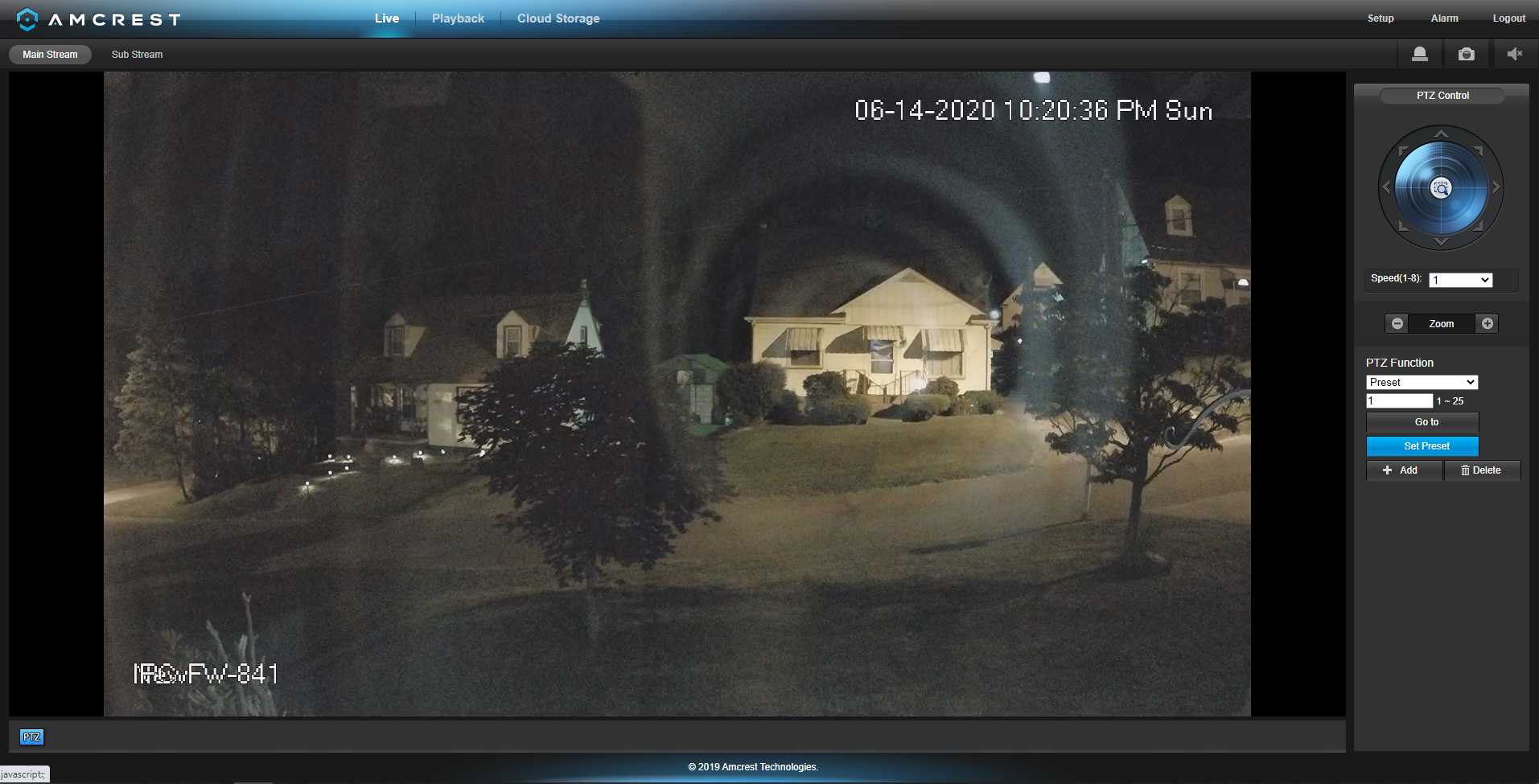

However this isn't the issue that I am writing about. This issue is the camera after reboot for the week started up with my Name I set off and IPC in the name line... I just seen that even though it has been that way since 2am today... So I log in to the Camera UI with the thought that I Reset the camera and didn't put the name back in yet because it was maybe 2 weeks ago that I did a Hard Reset on the camera... Anyway I log in and the name is there it is just off... So I turn on and well this is what I get (Picture Below) So I turn it off, Disable the Name again IPC still there.. I delete it out and put it back but the IPC will not go away... What the HECK is this....

I just tried everything and nothing was working so I had to do another reset of the camera... Logged in over the WebUI on it's IP even though the camera tried to send me to another IP lol.. My router is setup to give it the same one every time so that is nice not having to play around trying to find IP address...
Anyway now the IPC is gone and the camera now has been added back...
