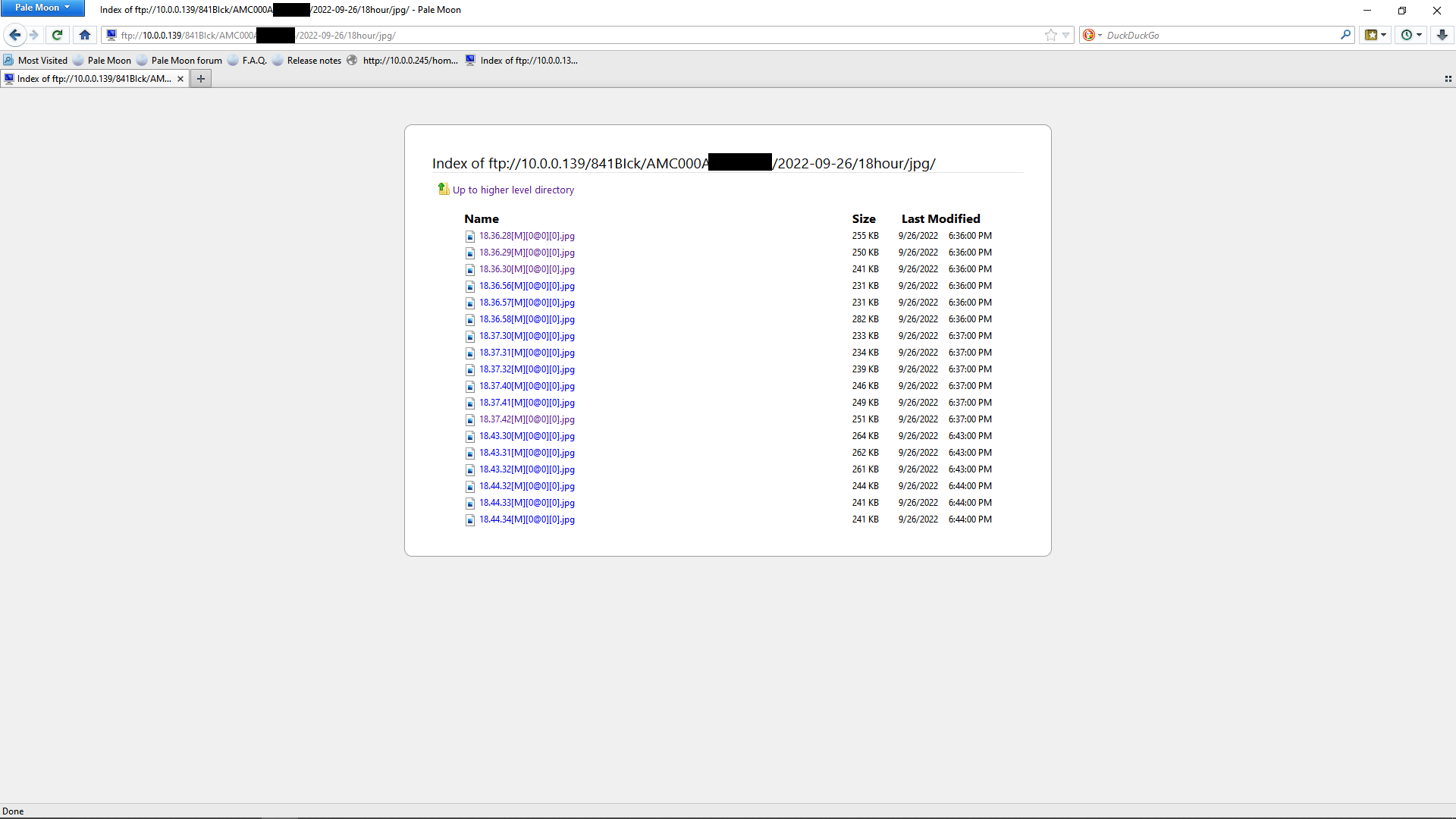

I've got the FTP log from my server and I only see uploads for 2 .jpg files. I'll post the entirety of it in a reply as it's pretty long.
I was seeing one file earlier, now it seems to be 2. But it's still less than the 3 I configured.

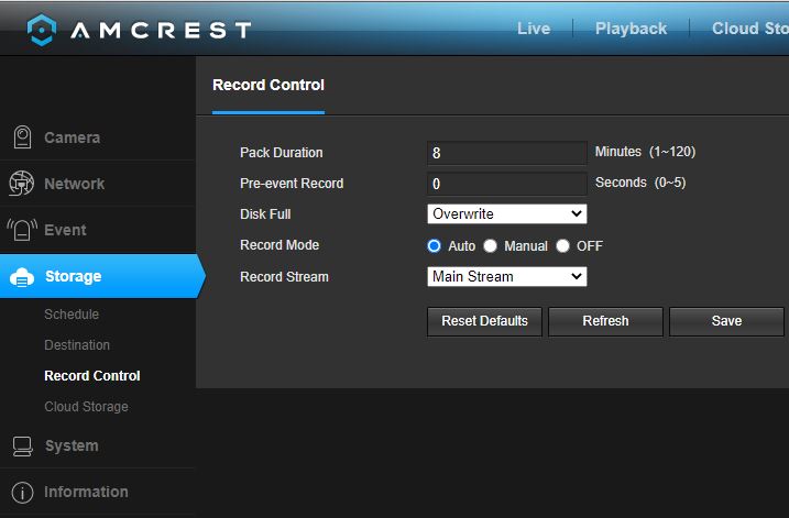

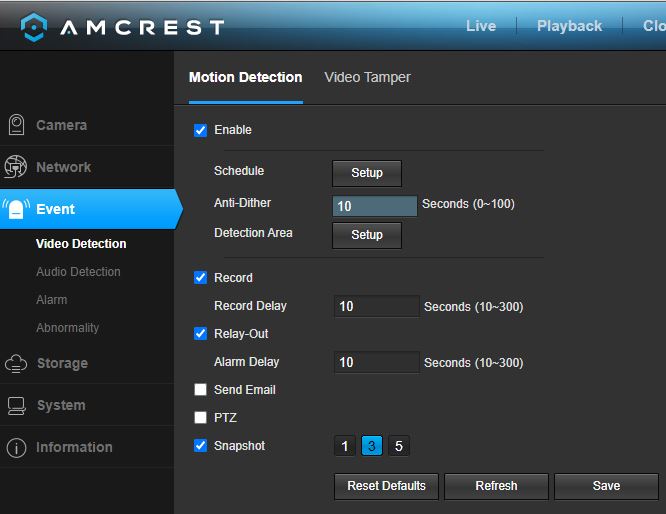

Here are my settings for the event and recording control.
- storage.JPG (40.92 KiB) Viewed 1827 times

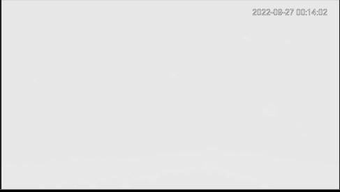

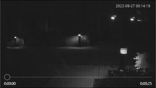

Here is the first snapshot from that test and the video paused right at the start. Both show the camera-generated timestamps. I fiddled with the Pre-event Record setting but I kept seeing delays of 16-17 seconds no matter what I tried.

splynncryth
- Posts: 6
- Joined: Fri Feb 17, 2017 1:34 am
Re: IP2M-841 motion detection issues
I fiddled some more and I think the issue boils down to having sufficient processing power. Enabling camera->video-> smart codec has helped. I'm messing with other encoding settings there to see if I can optimize things further.
The snapshot feature itself also delays the start of video recording. It looks like the camera can't record when capturing a snapshot.
I don't know if this also happens with the SD card or using NFS, I may have to test those later.
