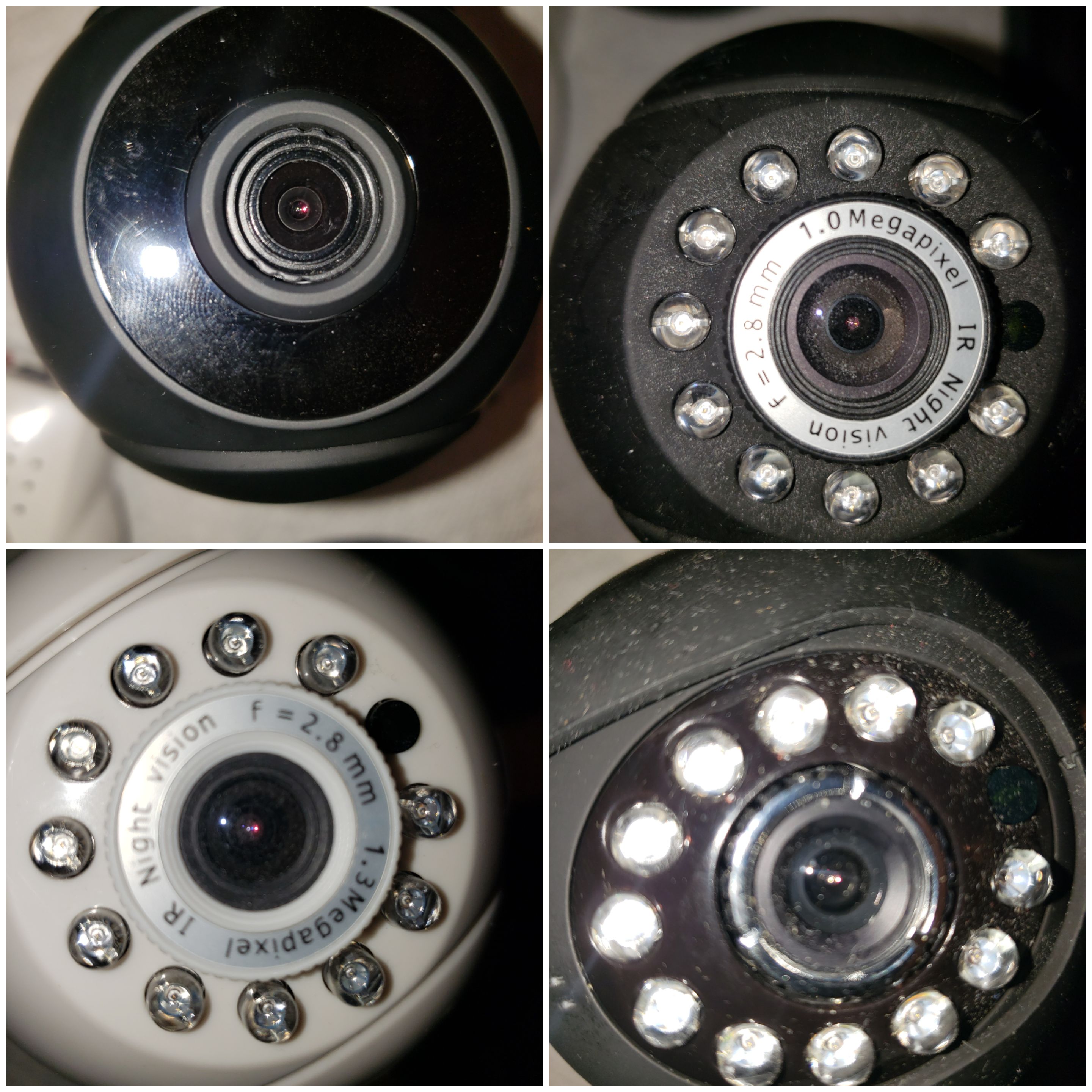

Really with the cameras being a Pan and Tilt camera why would one need a Wider FOV? Moving the camera back from the scene gives it a wide path already... I have one camera that I have to zoom in some to get it at the FOV I want for that given scene... I have taken 4 pictures of my cameras and put them together into 1 picture so you can see what I am talking about.. As seen the 841 is the Top Left camera..
