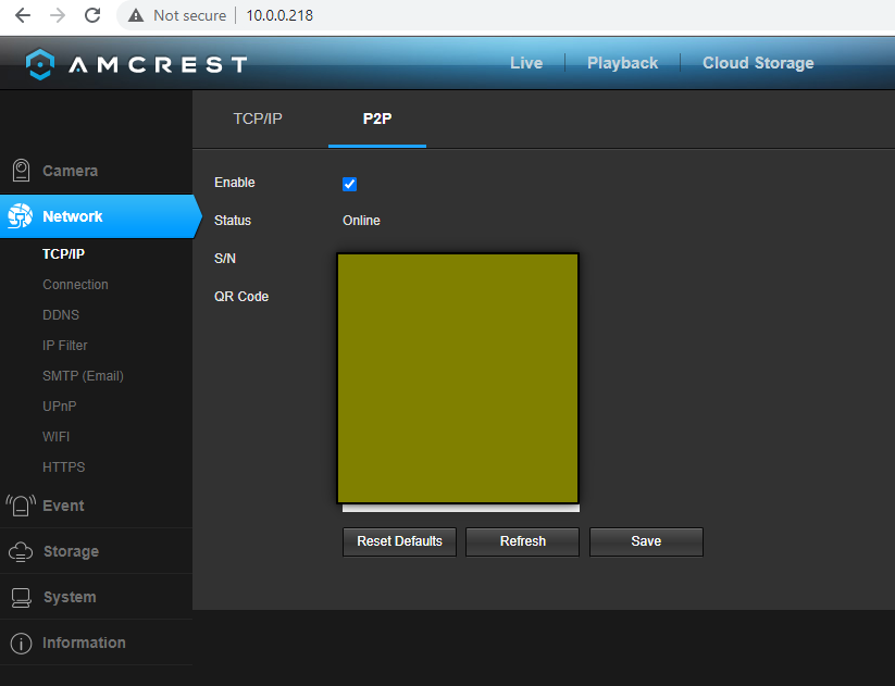

Ok next thing is that Maybe it for some reason has P2P turned off..?
You will need to log into your cameras IP over the WebUI http://ip address/ then your user name and password, then you will want to click on setup, then network, then TCP/IP then in there, there should be an area that says P2P you will want to click that, then make sure that the P2P is turned on... (Enabled) Once that is done and if it is maybe turn it off and then back on again saving each time to make to take affect.. HOwever if there is no check mark only need to check mark it and save or apply.. That is it I will log in one of mine and take a snap shot what I am talking about
