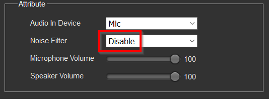

Can anyone enable audio alerts without getting bombarded with abnormal input alerts? I'm running the latest firmware.
Re: IP2M 841 audio alerts
Yes! The culprit is the noise filter. Disable it:jjreynolds wrote:Can anyone enable audio alerts without getting bombarded with abnormal input alerts? I'm running the latest firmware.

Where is this sound filter setting? Thanks.

@WalkGood Hello and Welcome to the Forum
Using the WebUI log into your camera via the IP address. Once logged in upper right corner area Click on Setup Then you will want to click on the left side menu Camera then Click on Audio and you can find all that info for Audio in there...
For Audio Detection
Click on Event and then click on Audio Detection and you can set up things in there
For Audio Detection
