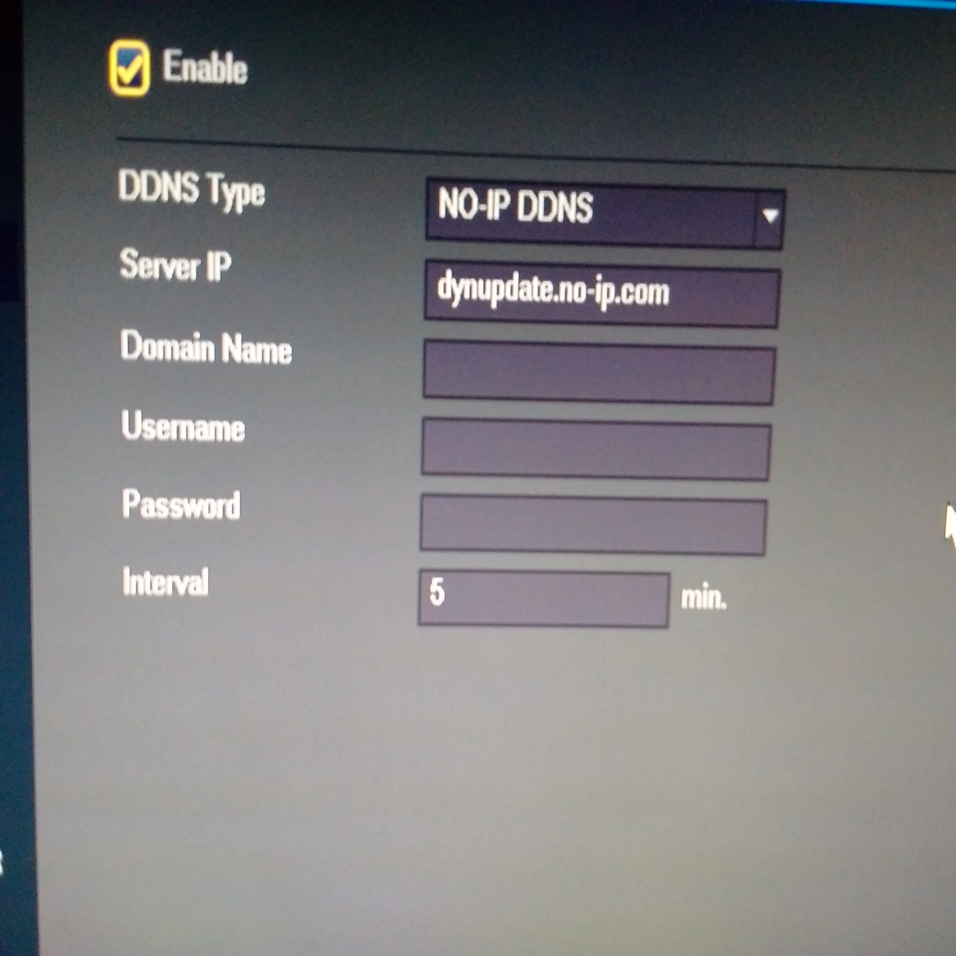

Does anyone use the IP/Domain/DDNS method? I am using the free domain from www.noip.com
I have the domain already. trying to set it up on my phone and getting "login timed out"
Question:
1.is the server ip name that is in there correct
2.do i need user name and password
3. do i need to set interval? if so what to?
screenshot is attached

Hello mrbquick,
You need to use that domain name under domain name and can leave the IP part blank. You need to enter username and password for the noip account. The interval can be left at 5 mins.
It would be easier to use the Amcrest DDNS from the drop down if that is an option in your system.
