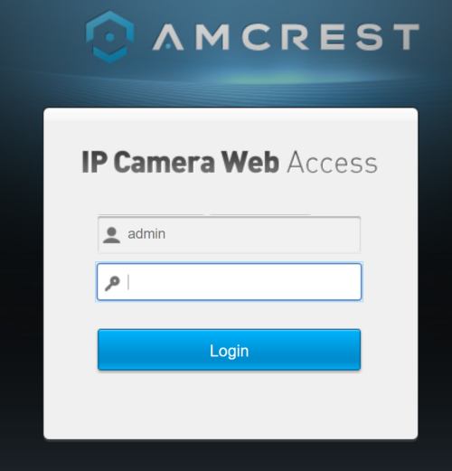

Can you confirm that I understand correctly. You're accessing your IP camera with a web browser while connected to your LAN and entering just the camera IP address into the address bar. Sometimes you see the normal login page like this -
but other times you see something else. I don't understand what "com.login" is although having said that, someone will now come along and explain what I'm missing

Just like your picture but has com.login on that blue button. Must be something with the camera because when it just pops up like your picture I can view the camera in internet explorer.
