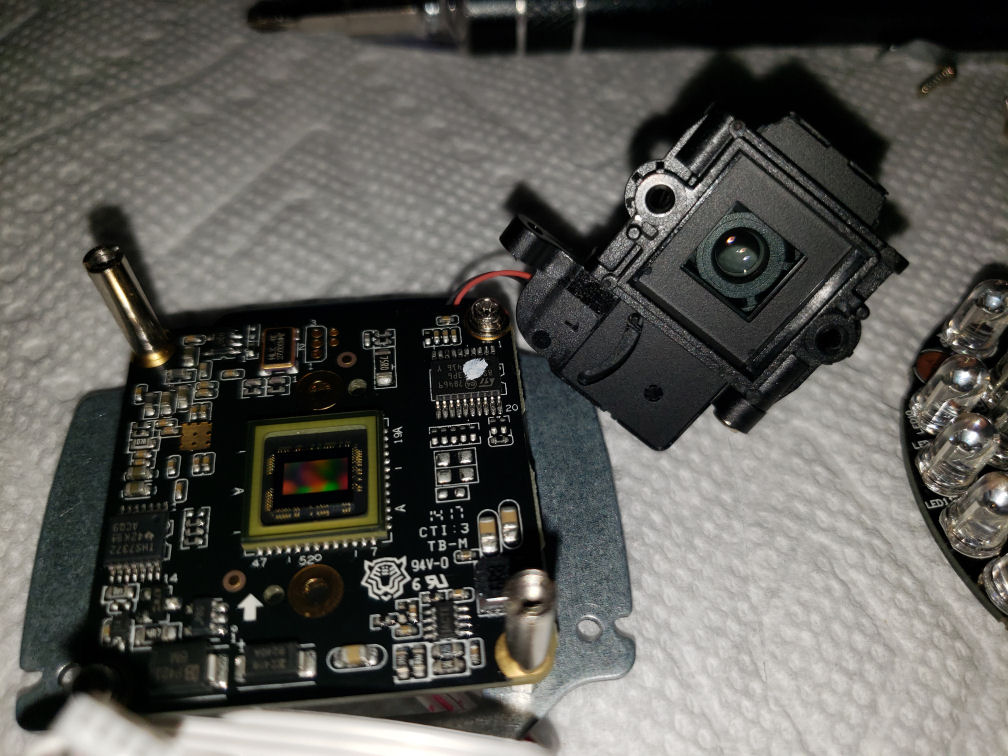

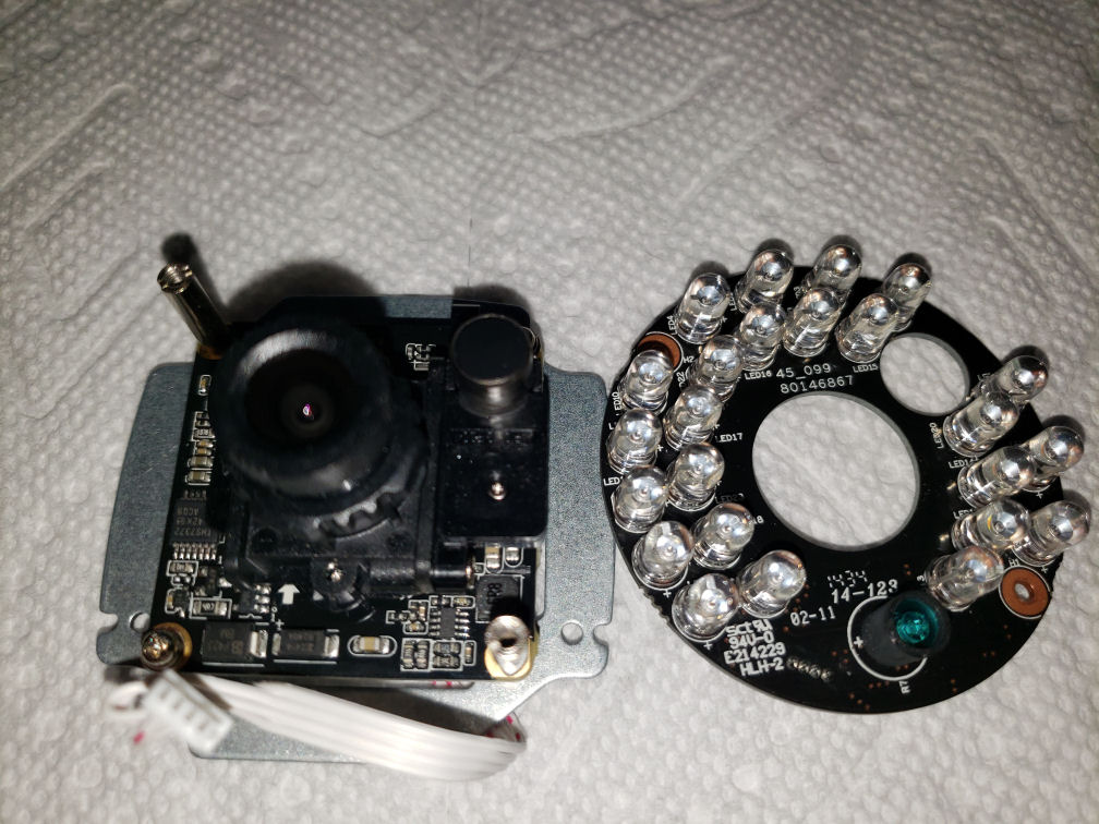

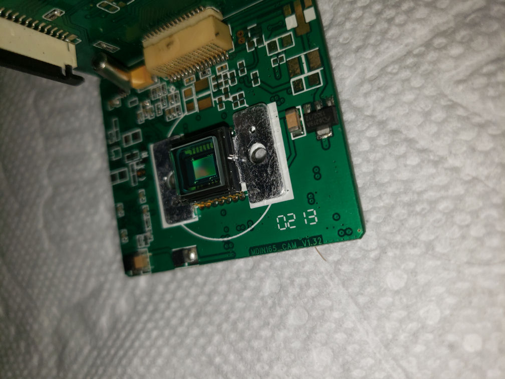

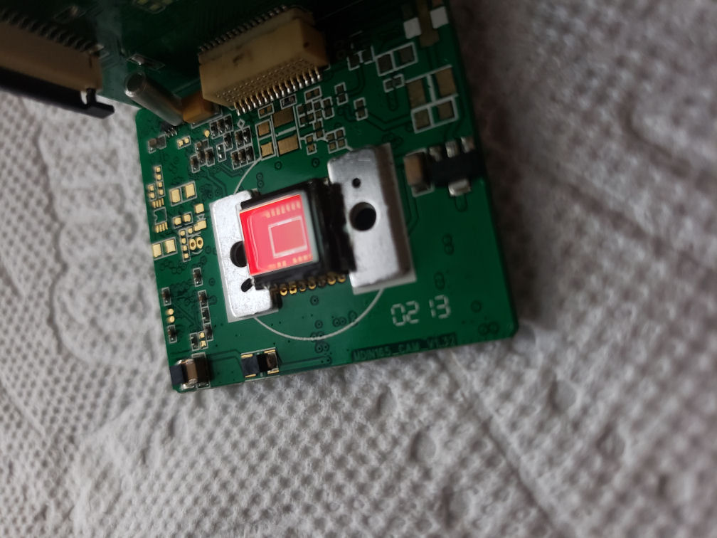

Things to note... Know the type of Camera you have... While ones with IRC is the best for quality of night time B/W that isn't always the case... I have some high end Very Low light cameras that have a FILTER in place and the camera switches from B/W to Color. While as some say and I tend to agree the colors don't look as clean as they could if they had an IRC. That is because the IRC has a small film with 2 colors that changes as needed for the day or night where the other has glass or plastic in place with both colors together.
Then you have to ask your self do you want the Covert IR blaster or the Semi Covert (or normal) LED... The Covert ones have 940nm leds where the Semi covert ones have 850nm led.
Also with some and iLuminar is one of them you can control via remote different things like when to turn them on and off by changing the control of the LDR and how bright the IR blaster is. If your in an area that needs a Blaster but don't want to have so much IR wash, bleed or Reflections this can be controlled by remote...
Also the #1 thing for the people out there that are worried about your cameras being controlled by the built in IR of a camera with a Blaster there is no connection to a computer or network so you don't have to worry about 2 cameras talking to each other over the built in IR of a camera as it was said by another poster the main use of IR was for Remote control and as such it was found that you could use another IR camera with code to talk to other Ir cameras and as such might have data issues if someone was crafty enough lol
Amcrest Camera with IRC *IR Cut Removeable Filter* you can see the motor on the lens Lens Removed you can see back side of Filter in Day mode Camera of 27x zoom Sony With lens removed you can see the Filter that isn't removable Here is the same Camera 27x with color of no removable filter in place different color
