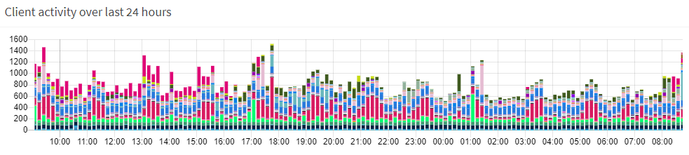

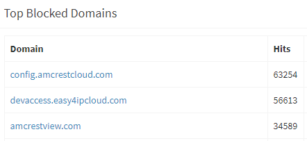

I submit a ticket on this, but wondered if anyone else noticed how talkative their IP Cams are. To me it is absolutely unacceptable how many times they are flooding my network with requests to the following URLS:
(hit counts over past 24hrs next to the URL)
config.amcrestcloud.com 62927
devaccess.easy4ipcloud.com 56346
amcrestview.com 37215
Cameras work great and I love them, but these things phone home more than my next top talker by more than double and its a 2019 Exchange & Web server. Maybe there is a setting I am missing, but I am not using nor am I interested in using their CloudDVR as I have purchased an Amcrest NVR that I use on my LAN. I have gone through every config page and cant figure out how to shut these queries off, I cant be the only one that doesn't want my cameras hitting the DNS server more than every other device (60+) on the network.
Camera model: IP8M-T2499E and all four of them do this.(Notice the 4 bars along the bottom of the nice GUI graph I attached that show they all talk insane amounts in comparison to all my other devices) Each of those color represents a camera or client and something is wrong that the cameras are that talkative.

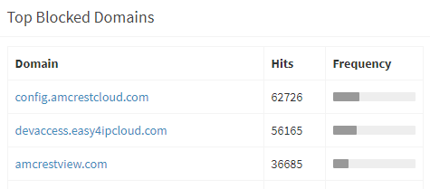

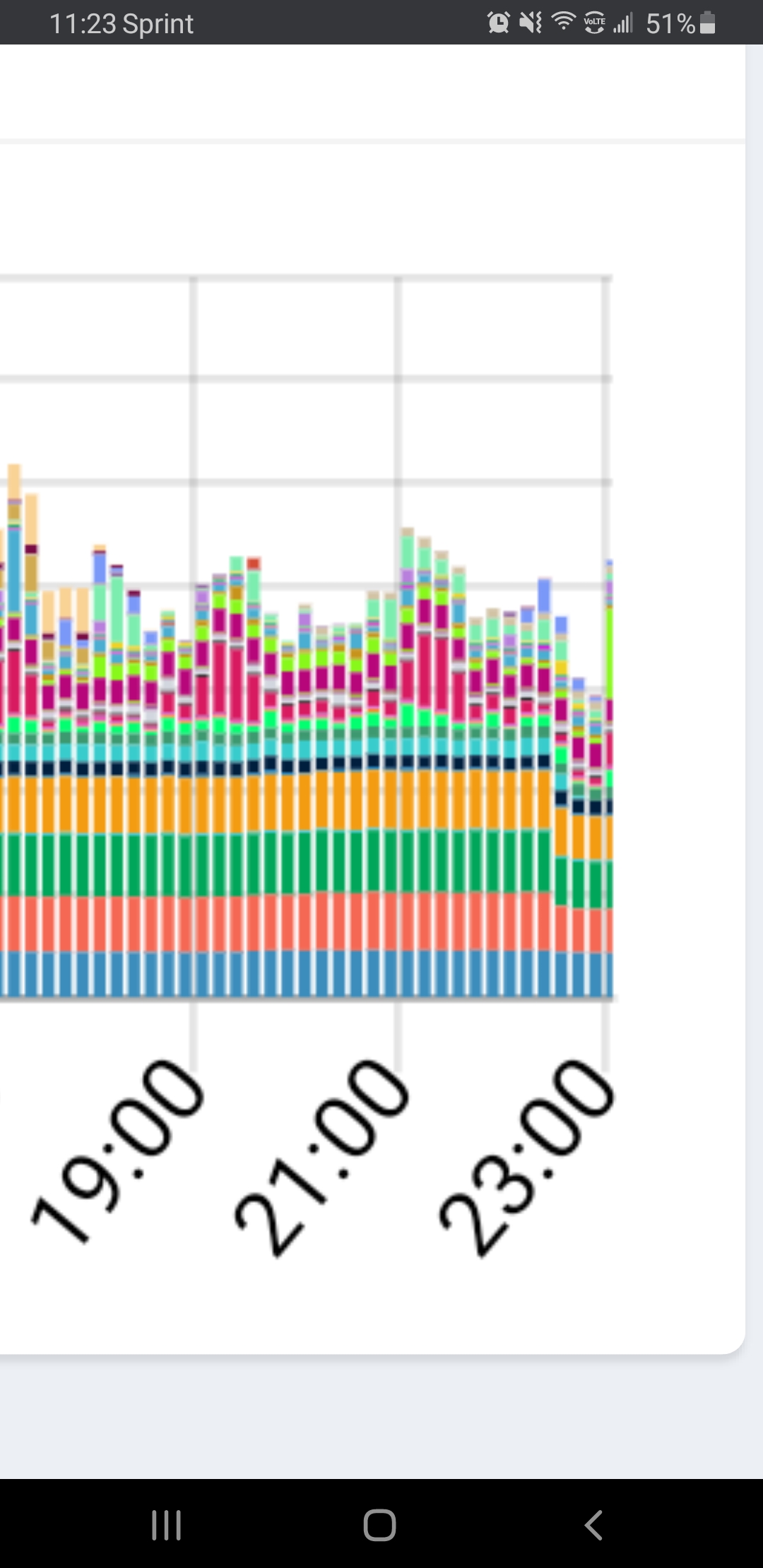

So this is the same article that support sent me to follow, and while I have now disabled P2P according to that article after two hours it should have stopped. The log was showing 24hrs of non-stop hits on those domains. The amount of DNS queries did go down slightly, but not like it should have. Again, I disabled P2P, saved, and have reboot them. I'll let it sit over night and see if it's changed.jack7 wrote: ↑Tue Sep 08, 2020 4:17 pm Maybe this will help.
https://support.amcrest.com/hc/en-us/ar ... ctionality
You can see it did drop the number of requests slightly disabling P2P without rebooting or waiting two hours.

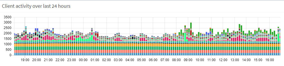

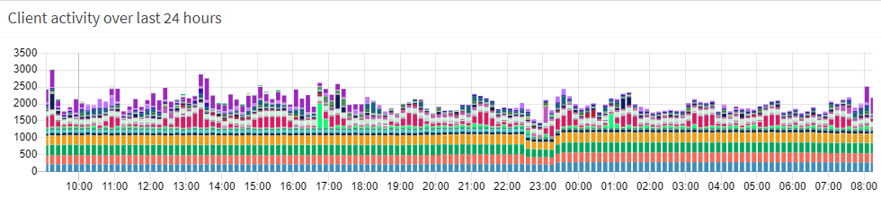

P2P has been disabled on all 4 cameras and on my NVR, saved the config, and reboot all the devices. They have been running for over 8 hours now (according to the linked article that was post by another user as well as sent to me by support) after 2 hours this behavior is supposed to time out.
Even with making the changes and waiting more than 2 hours after a reboot of the cameras I am still being spammed with these requests. I am open to more ideas, but to me this looks like a firmware bug that needs corrected.
Below is a picture that shows the last 24hrs and even though there was a dip for an hour after I disabled P2P and reboot last night around 2300hrs it went right back up and the cameras are still spamming the DNS server. Also posting another screen grab of the last 24hrs work of requests from these things.
Post Edit: Apparently when you reboot the camera, even after saving it will re-enable P2P. I just logged in and P2P was enabled again... I have disabled and saved yet again, I will give it some time to see if the request go down
