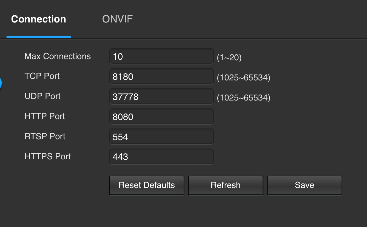

I have been troubleshooting the loss of connectivity to my cameras since the Amcrest app update and found a solution. Basically, the app update changed from using the “HTTP Port” setting to “TCP Port”.
I was previously using “8080” in the Amcrest app for several years with the camera below. Once I changed the number to “8180” in the app’s Device Manager setting, connectivity restored. I cringe every time this company performs updates...

Thank you for updating us with this new thread. We do recommend using TCP port instead though for IP Domain setup.
https://support.amcrest.com/hc/en-us/ar ... commended-
