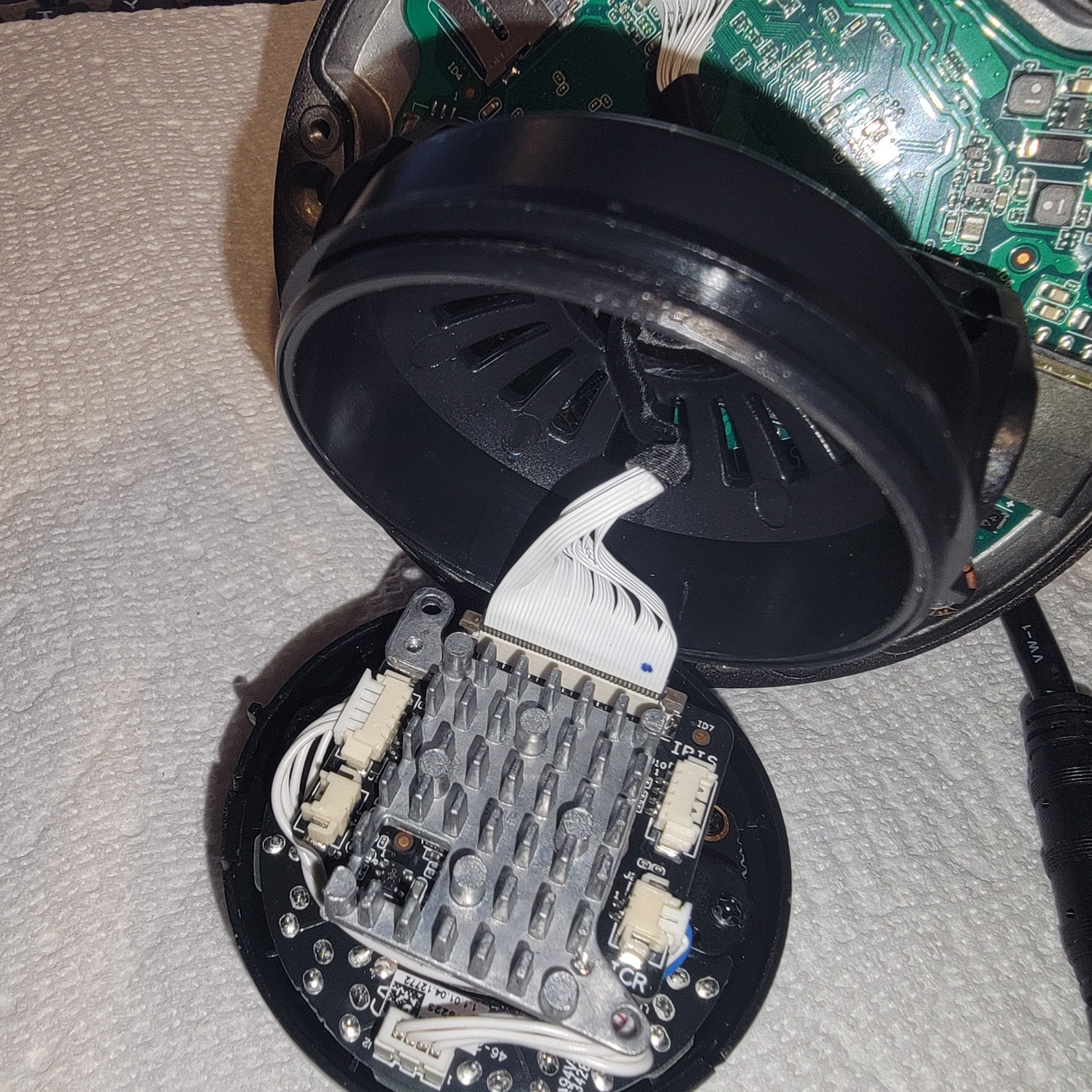

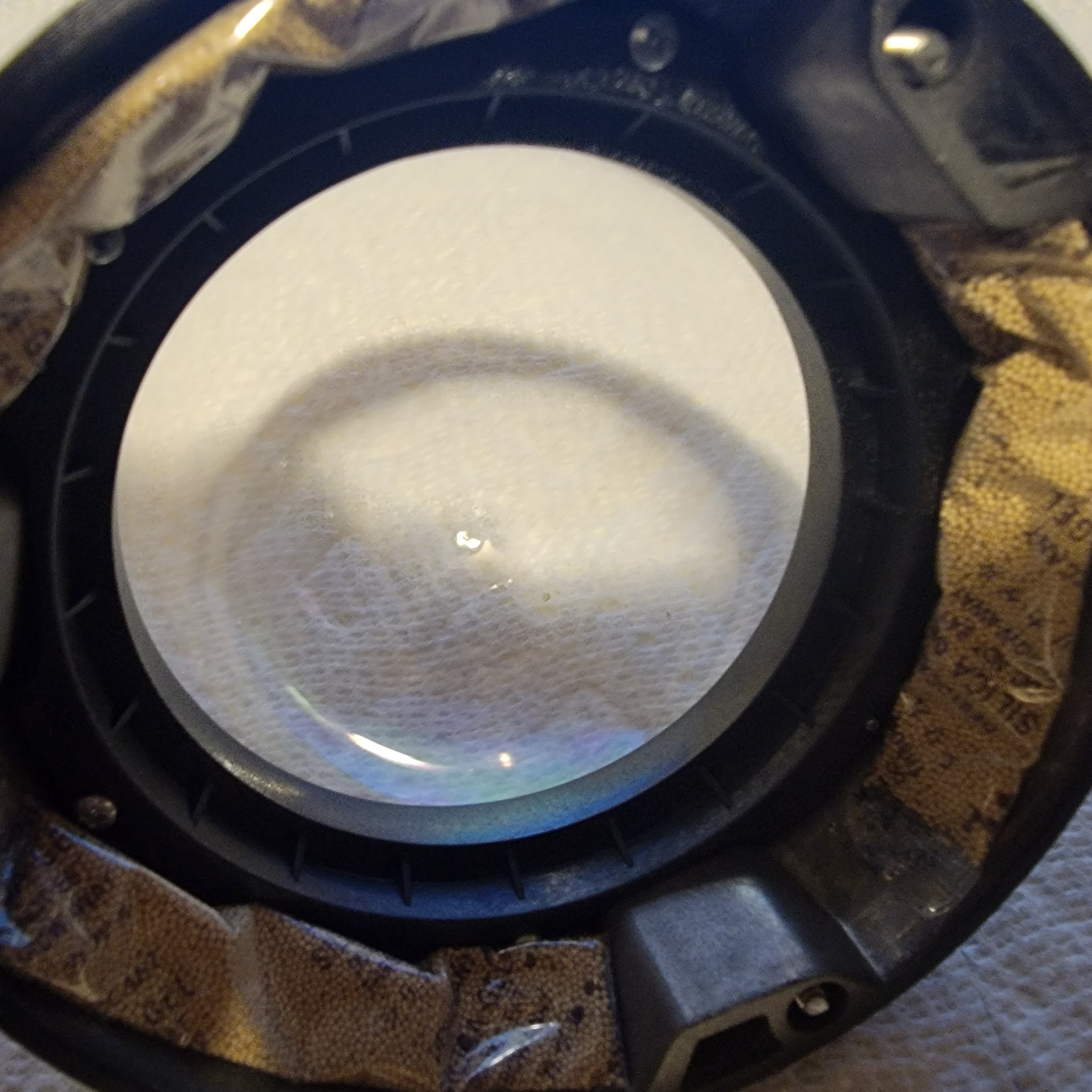

Well it is going to be hard to say really. My guess is that the Gel packs haven't been changed and the insides started to get moist and has caused water damage on the IR board? Or they went out.. I mean the life of ir is normally like 25,000 hours or more depending on the build quality. So the Gel packs in the 956EB anyway, there are 3 on the dome, and there is 2 under the PCB. To gain access to the ones under the PCB isn't something everyone should try to tackle. However removing 3 screws on the PCB and the 1 that holds the camera bracket after removing the 2 that hold the camera and the PCB comes out. It will fill still connected because there is a Chip Chill pad that it will be stuck to. This isn't no big deal just gentle lifting of the PCB after everything is unscrewed it will come out..
About the IR that is something that might be little harder. I mean you could replace them if you had the Right IR and might as well do them all. There is 24 in all. However your best bet would be to buy a Donor camera. There are many different types of cameras that are the same size and offer some type of IR. I have some that I like more then the 956EB cameras IR that only have 2 IR's that I could source and could work. Some cameras it is just take the IR cover off.. However on the 956EB anyway unclip the camera from the holder, the camera is screwed into the IR Cover/holder so it would have to be removed and changed over to the other holder. Even with a swap say from a Amcrest 751 that has the same type of IR setup, The 751 would need to be removed from holder and the 956 will need to be added back. Keep in mind that the camera is using a very thin ribbon cable and it would be best to remove from the camera making note what way it was connected. Take a Sharpie and mark the blue side of the cable and the connector that is the best way to know you will put it back in the same way..
You don't need to remove the camera from the holder to take out the IR/Camera part. IF you look at the camera with the top off you will notice there are 3 clips that hold the front of the camera on to the base, I use a Cornwell SDP-P400 pick to lift 2 of the tabs and the camera comes out of the holder, Then remove the Ribbon cable, and then there will be a 4 pin wire that runs from the IR to the camera, Unplug that from the IR board. There is another 2 wire for the IRC, Just leave that connected because that is connected to the front of the camera. Then on the IRC wire side is a screw about mid center remove that, and then on the other side same area and that will move the camera from the IR cover. The IR is still screwed into the cover (No need to remove if you doing a swap) if you are going to replace the IR or repair the IR Board then it will need to be removed from cover as well, That is with 2 screws.
If you look on Ebay, You can find parts cameras for cheap most times. G4, ADT, Dahua and others that look the same as long as they are same sized cameras most times you can swap form 1 system to another. Cameras no. IR yes. Just need to make sure they are running on the same voltage and most of the ones I have sourced for 1 reason or another are just the same with different type of camera but IR was the same. Don't buy a ADT 3mp and try to swap out the camera to the Amcrest they are different and will not work. The IR's do but cameras won't..
Gel pack picture from Stock 956EB. I didn't' take it down to show the one under the PCB. There are some there..
