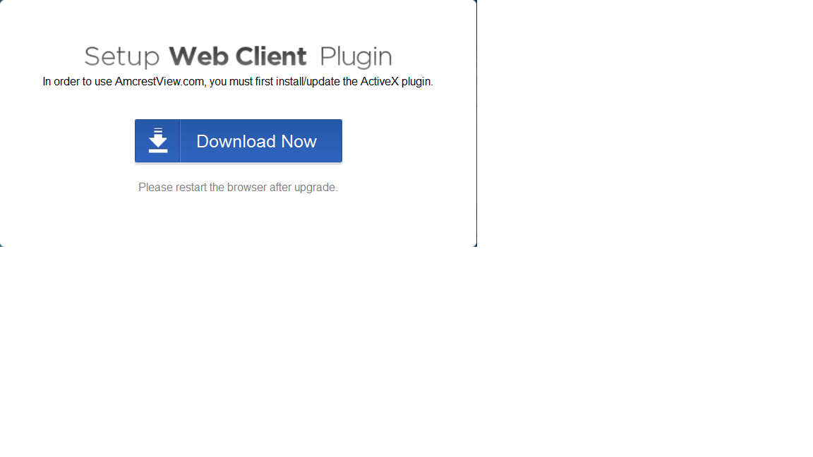

That web page says that I will offered the appropriate plug-in or extension based on the web browser (client) that I use to connect to that site. Nope, not true. I connect using Firefox. All I get offered is the ActiveX plug-in which is only usable inside of Internet Explorer (which I am not going to use, especially when away from home).
So why does Amcrest's server not properly recognize that my client is Firefox (and offer an extension usable within that web browser)?

Hello VanguardLH ,
The camera should recognize Firefox and should direct you install the .exe. I believe this .exe is common for Firefox and IE. Once you have installed and the plugins allowed in Firefox, it should work in Firefox.

I've registered an account. It's been verified. When I revisit www.AmcrestView.com, I am presented with a web page telling me that the ActiveX control will get downloaded. See the attached pic of that screen. It clearly says "install/update the ActiveX plug-in". ActiveX only works for Internet Explorer, not for Firefox or its variants, Chromium-based web browsers (e.g., Google Chrome), and not even in Microsoft's Edge.
When I did the experiment and downloaded the .exe file, I only saw the AX control added to IE11. There was nothing listed in Firefox as either an extension (aka add-on) or plug-in. The IE experiment failed miserably. Too many functions were disabled, like not being able to set preset pan/tilt locations. I had to restore my computer from an image backup because the downloaded .exe did not add an entry to the Add/Remove Programs applet and I wasn't going to spend the time drilling into the registry and file system to delete remnants there.
That web page offers me an ActiveX control, not a Firefox plug-in or extension. I tried hunting around the amcrest.com web site for the Firefox plug-in or extension but did not find it. There is nothing listed for Amcrest at Mozilla's store (addons.mozilla.org).
