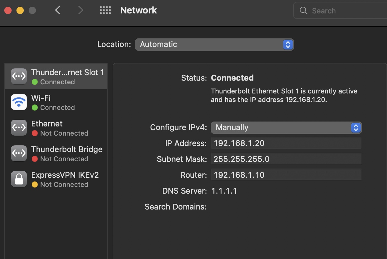

Well you might have not caught the fact I am on a Mac. But I like your suggestion and am now trying to figure out how to do the temp static IP on it. I thought I figured it out and then ran Amcrest IP Config and had it search but it just beach balled and never found the two cameras I need to change the IP on.
- Screen Shot 2021-11-28 at 6.58.52 PM.jpg (142.57 KiB) Viewed 3109 times
