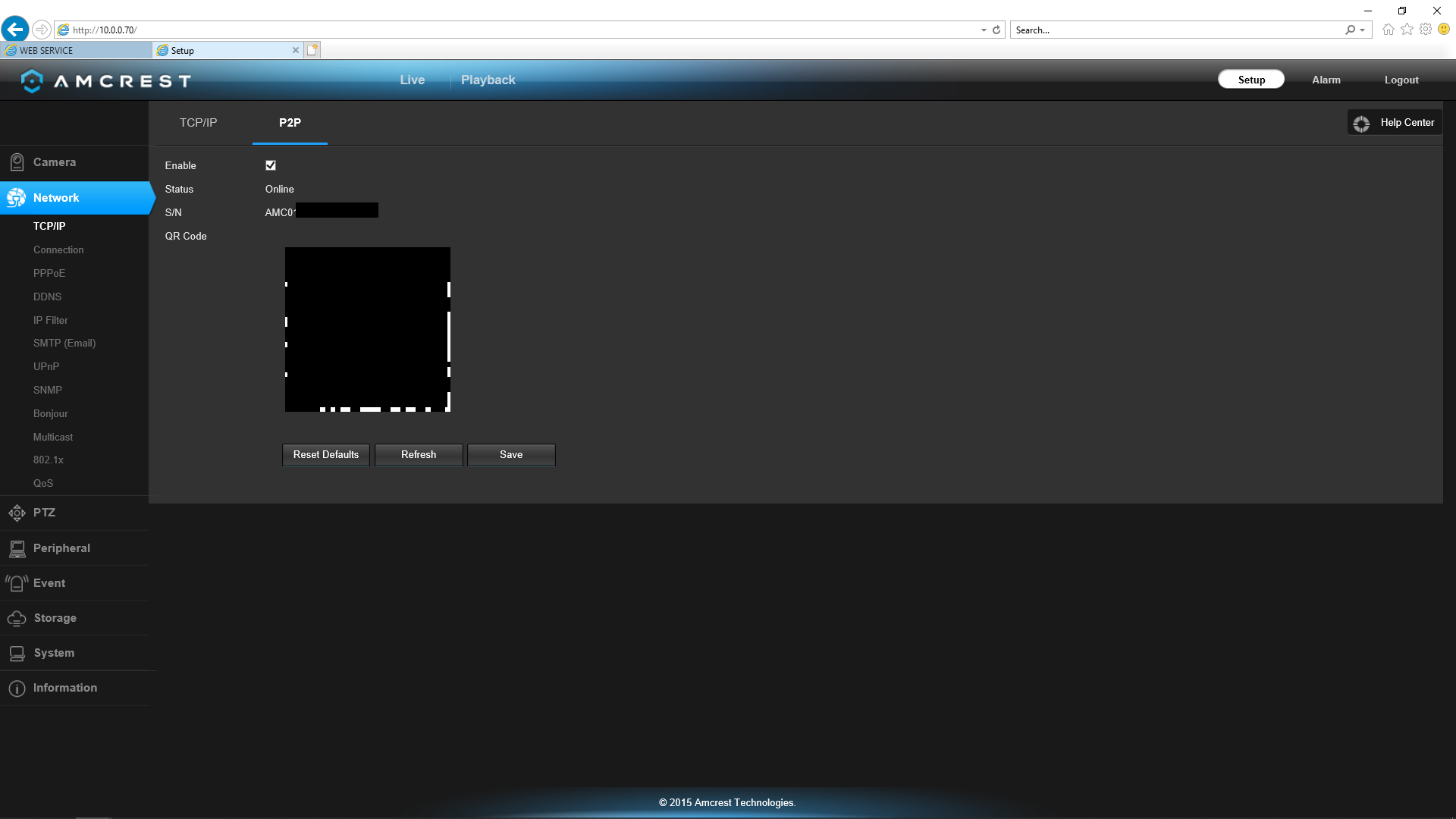

you will want to make sure that your cameras are on your Main network or that your network where the cameras are placed have access to the internet. So what do I mean? Well in the case of my home. I have 5 routers out of the 5 routers only 4 have access to the internet. If I were to add cameras on the 5th Router anything on that router even though it is connected to my main router that router has been denied access to the internet and anything behind it.
So if you have a network setup with more then 1 router or if you have a Mesh network with a few AP's you might want to make sure that your AP's are giving access to internet..
Outside of that it might be there was some type of setting that was set in the camera and over time you forgot about making that setting and this has caused the system to stop allowing the P2P.. What you can do is log into the WebUI of the camera (Locally) and go to network, TCP/IP and click on P2P and see if that says it is on or off. If shows offline then there is an issue with that cameras accessing the interent..
1 last thing. Make sure the DNS isn't setup for your computer or your Router. If in the USA I would use 8.8.8.8 and 8.8.4.4 for DNS...
Sorry I said 1 last thing already to lazy to fix it.. So Honestly the last thing lol. If you have connected your camera to a POE nvr then you no longer have access to the camera from outside the NVR it self
Screenshot (4448).png (132 KiB) Viewed 4811 times

Re: I can see all cameras inside my network, I can only see 1 outside of my network
Log into the cameras WebUI of the ones that are not able to be connected to outside your local network. Double check that the P2P is working and that it shows it is online. If it is enabled and offline then you will want to double check your DNS information and make sure it is setup for your area. Most of my devices are 8.8.8.8 for main and 8.8.4.4 for second. If your DNS is setup to your router I would change to a better one.
