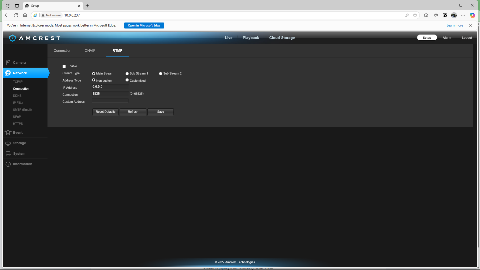

I want to live stream my 1 or more of my cameras to youtube for 4th of July. Will I need some 3rd party encoder or can I set this up with my current hardware and the WebUI and/or ASP?

The answer not looking up your cameras and do have some 2779 but they on another location right now will need to look to see if it offers it or not but if you look in your NETWORK connections if you have RTMP that is how you can stream to youtube.. Or could use OBS as another way if none of your cameras offer it..
Screenshot (490).png (122.22 KiB) Viewed 2929 times

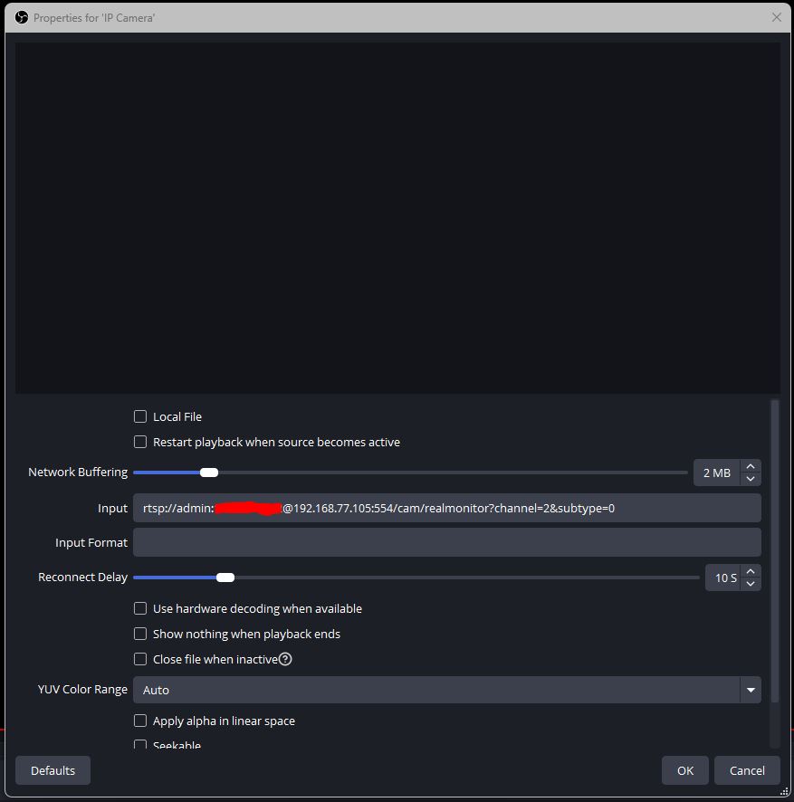

Using OBS, the connectiong to youtbue is fine but I'm not getting anything from the camera :(

and now I can't login locally to my NVR using the web interface or ASP! It says I'm locked out for 6 minutes.
I can access my feeds using the android app though :(

that sounds like a password issue
